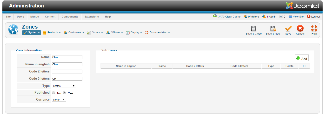

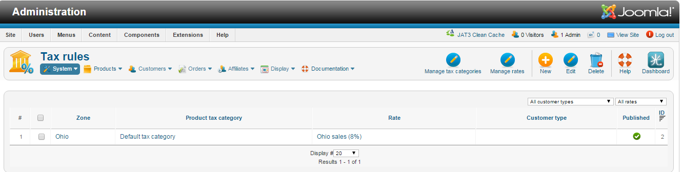

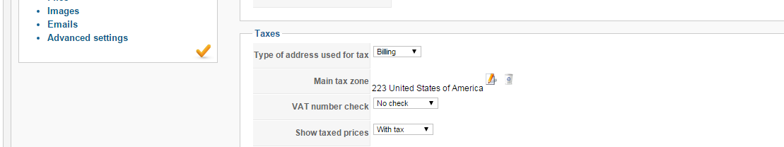

10 years 10 months ago #218388
Thank you, Nicholas. Here is what I've got set up. Please see screen shots. Do the screen shots verify that I have done this right? The "main tax zone" is a bit confusing because I want to excuse the entire world outside the state of Ohio from paying tax. So the main tax zone is set as the United States. Also I see the customer created some new products without assigning Ohio as a tax zone. That's obviously part of the problem, which I will correct.

10 years 10 months ago #218487
The tax rule and the settings look good yes.
Now I don't know the details... For example, if you have two zones that you called both Ohio, I can't know if the correct one is selected or not with just these screenshots (I'm not saying that this is the case, but we had people do that before). So it's always possible that it comes from something else.
Your tax rule only apply to the Ohio, so if that's the same zone as the Ohio state zone of your other screenshot, I don't see how people with an address outside the Ohio state could be charged with taxes.

10 years 10 months ago #218563
Thanks for looking at it. i don't have two zones, just "Ohio," which I picked from the available built-in zones. I will let the customer know that we are configured properly. Perhaps not all products select "default tax zone" (Ohio). We will have to go through and check product-by-product.
