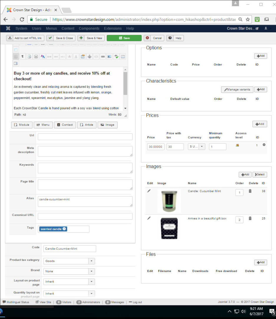

9 years 2 months ago #271123
Can you provide a screenshot of a product settings and a screenshot of the System>Taxes menu ?
Also, did you review that FAQ ?
www.hikashop.com/support/documentation/3...ion-listing.html#faq
It lists all the different reasons why the taxes wouldn't apply.

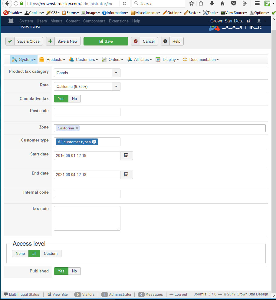

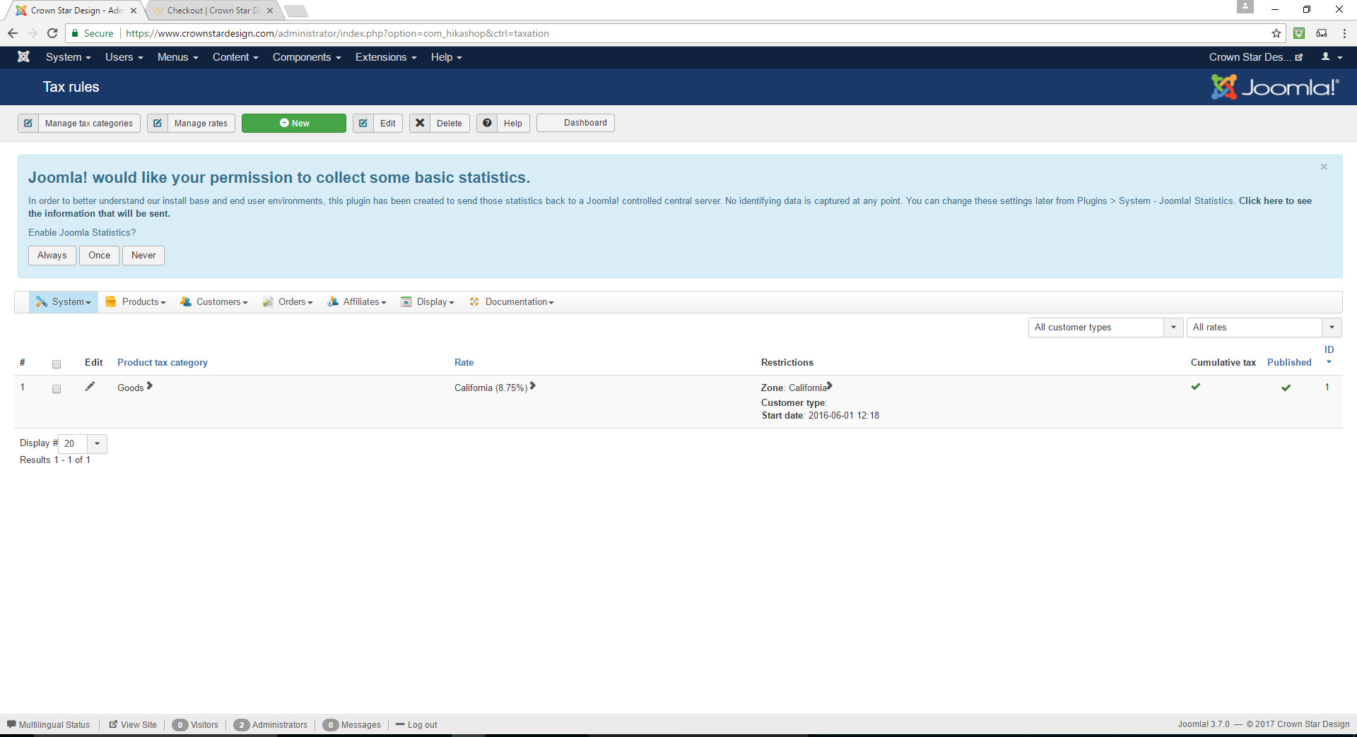

  • Posts: 7
9 years 2 months ago #271291
Here you go!

  • Posts: 86050
  • Thank you received: 14178
9 years 2 months ago #271395
It looks like you have an invalid "customer type" selected in your tax rule as normally, the text "customer type" should not appear on the listing when no restriction on the customer type is selected in the tax rule.
So please check that.

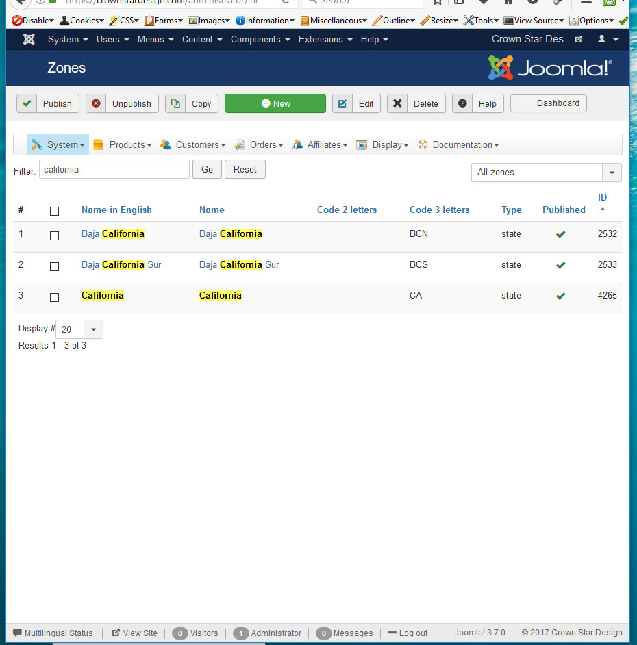

Also, you've selected the California zone for the tax so it will only appear if the address of the customer has that california zone selected in the "address_state" custom field. Check that you don't have several zones named california in the menu System>Zones as it could happen that you might use another one between the address and the tax rule. And check that the address of your test user has that zone porperly selected.
Besides that, your screeenshots look fine.
  • Posts: 7
9 years 2 months ago #271403
I have "All Customer Types" selected for the tax rule. There is only one California zone. I am entering shipping information inside the zone. So, basically, you're saying everything is configured correctly, but isn't working.

  • Posts: 7
9 years 2 months ago #271502
Okay, I selected Individual as customer type for the tax, and it's charging the correct rate. Strange that All Customer Types didn't work.
