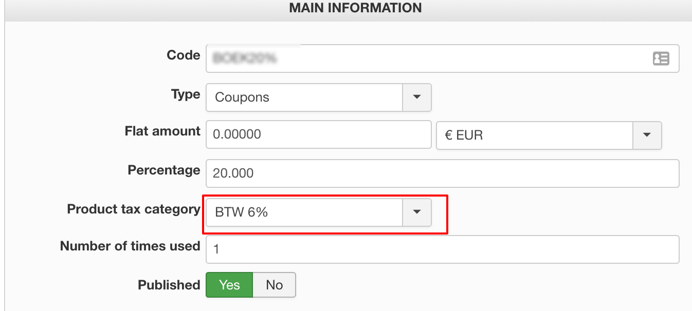

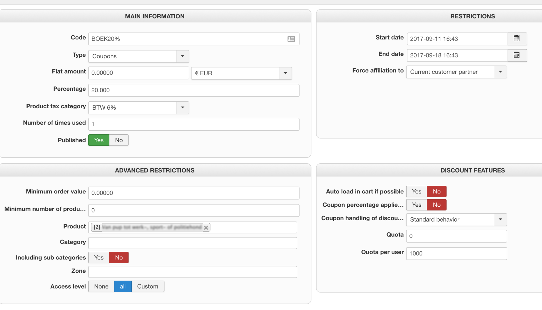

The coupon is set as follows
  1. I the time period as displayed in the video the coupon was used just 1 time.
  2. If you add the invoices together, you will get an amount x (here is the coupon value already)
  3. If you add the amount of VAT together, you will get the amount y (here the coupon value is not set)
The difference between these values is exactly the coupon discount. Since the coupons are virtual products, they should not be added to amount y.
A solution may be that this coupon code is not added to the VAT summary.
I hope it's so clearer

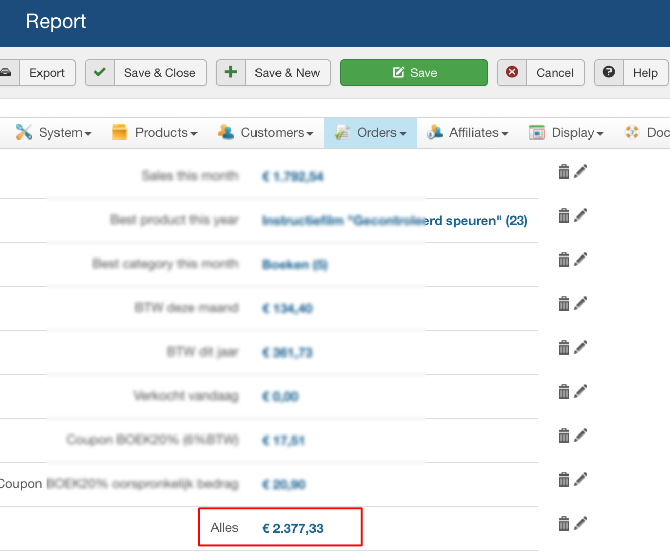

I made several screenshot hopefully this give more clearance.

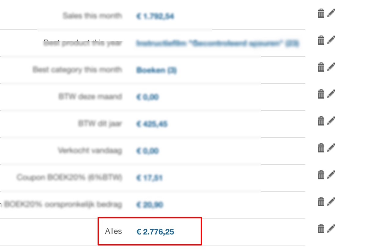

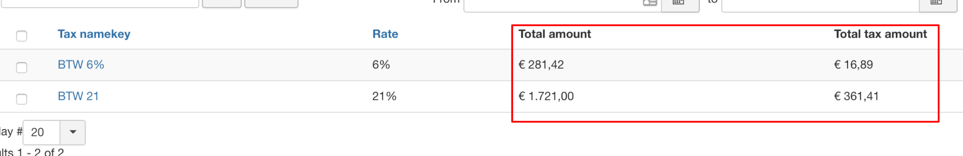

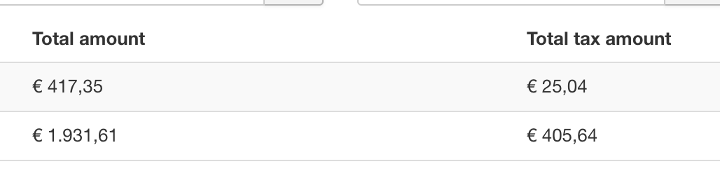

See the total value of the sales: € 2.377,33
If I add all amounts by VAT, I will deduct this amount: 2380,72
The difference between these amounts is exactly the coupon discount used in this period: 3,39

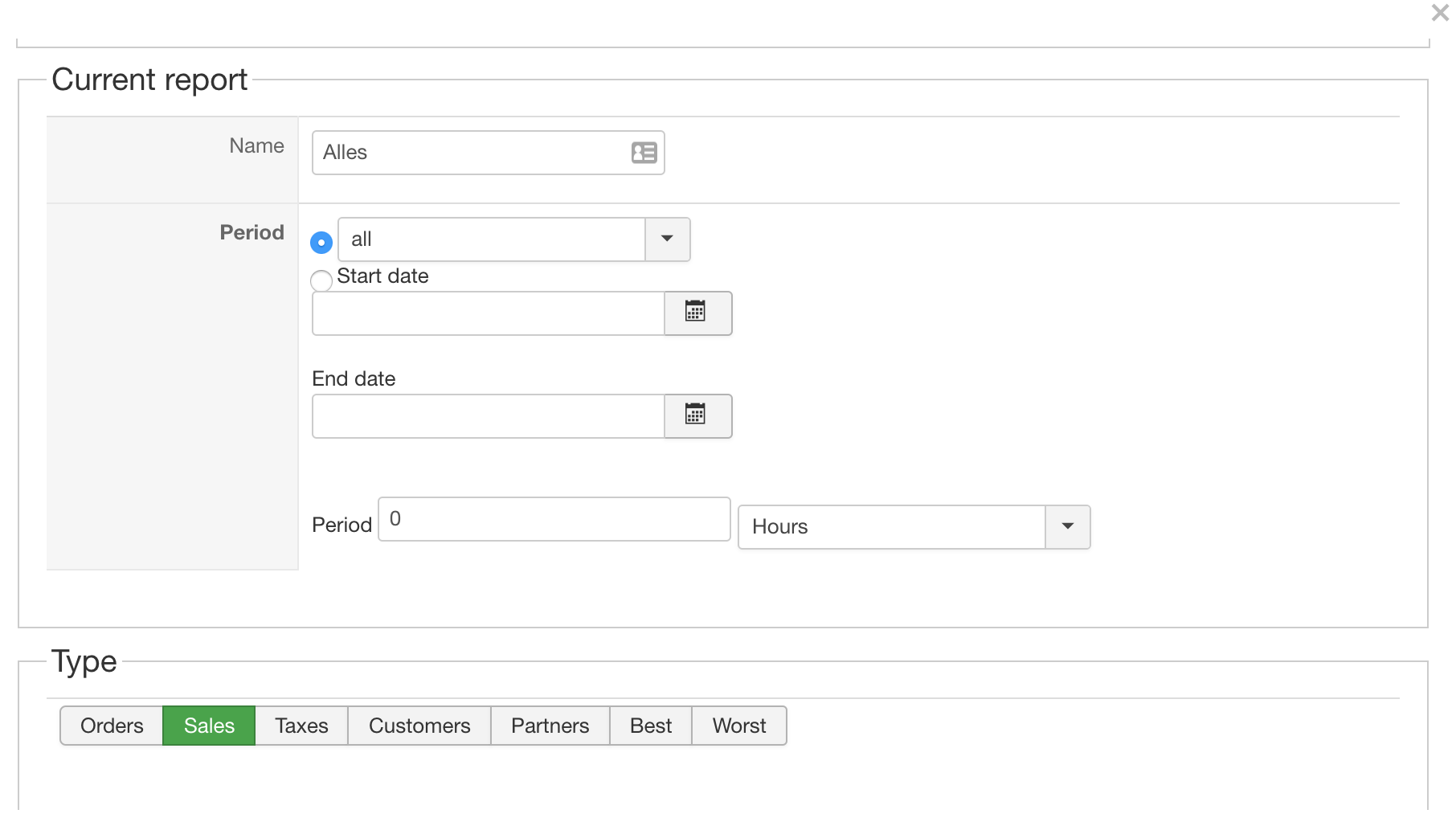

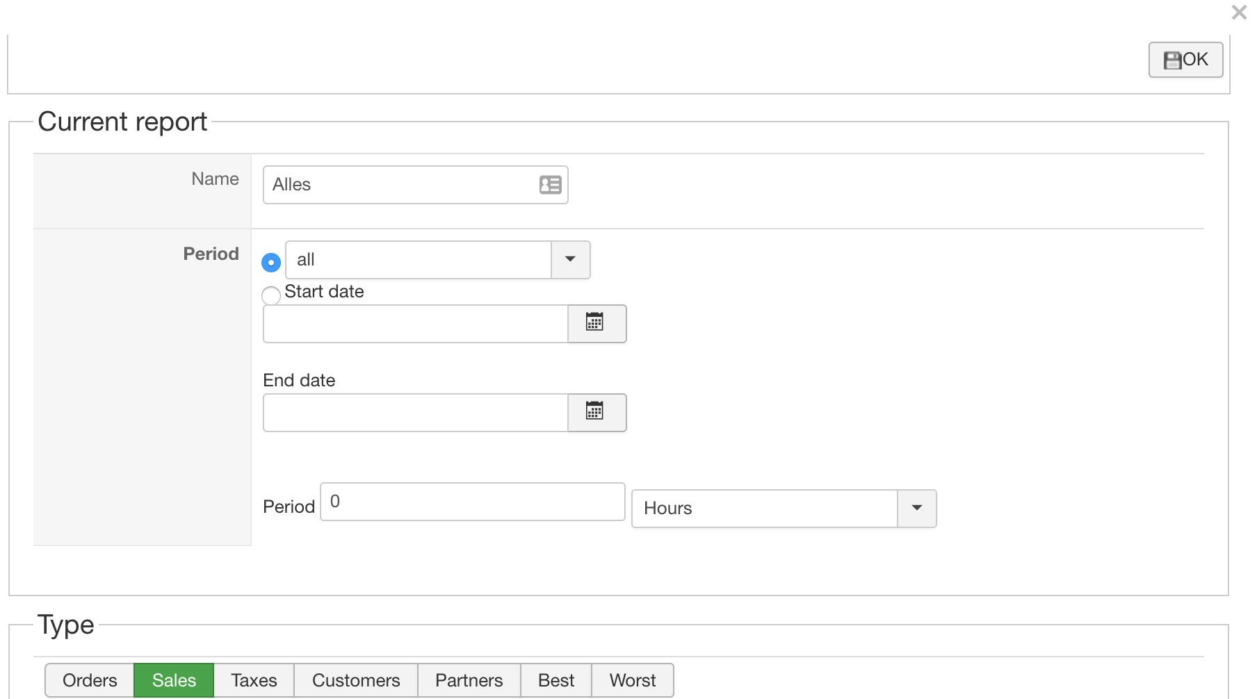

I made a widget with these settings: See the total value of the sales: € 2.377,33
Total tax overview: If I add all amounts by VAT, I will deduct this amount: 2380,72

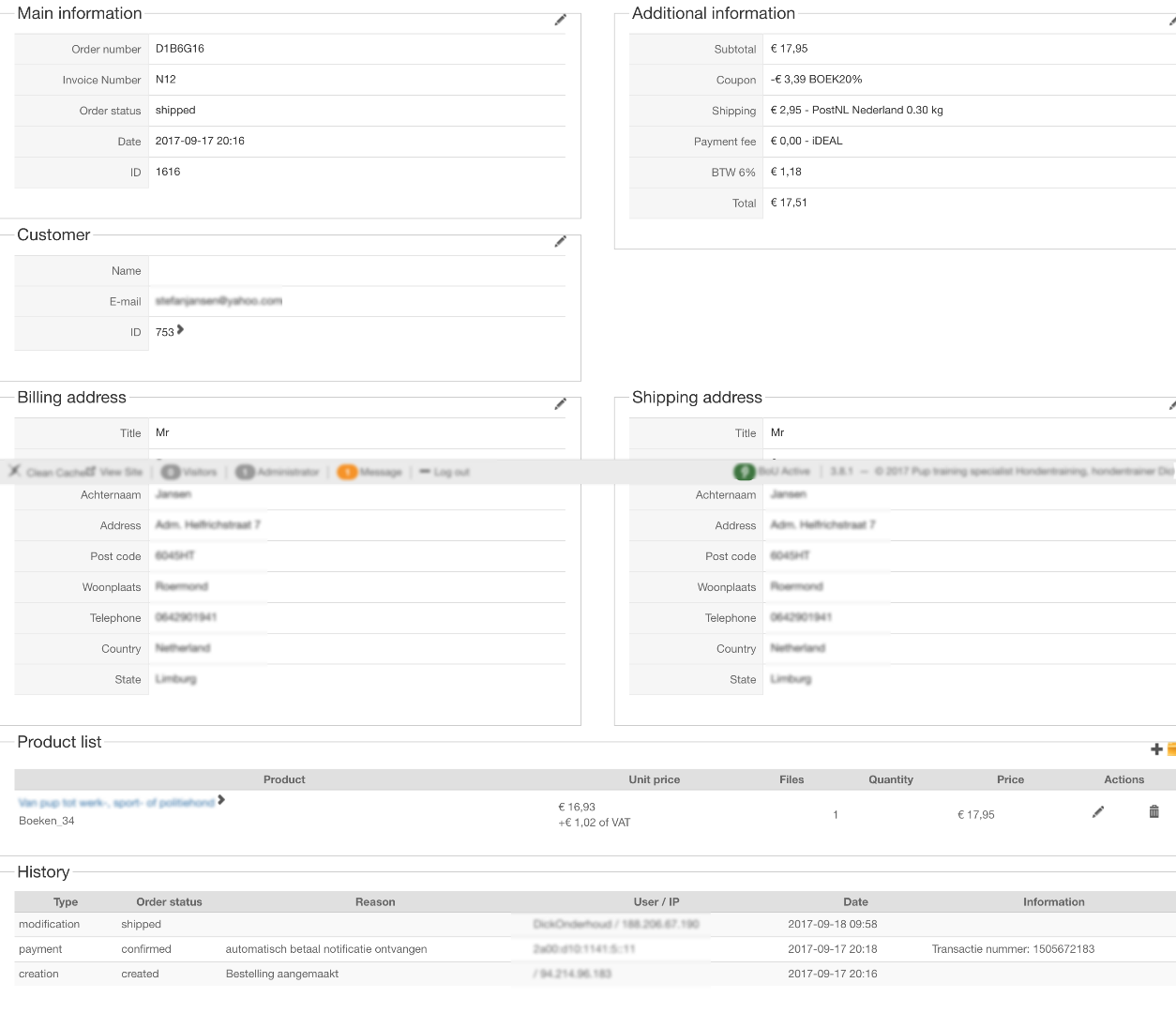

Thanks, but that's not what I asked. What I need is a screenshot of the details of the order where you have that coupon. You can blur the user data. What I need to see is the product price, tax, the additional area prices, etc.
Please provide the information we ask so that we can move forward. It's the third time I'm asking for it. Is there a reason you don't want to provide that ?
  • Posts: 198
  • Thank you received: 7
8 years 9 months ago #280988

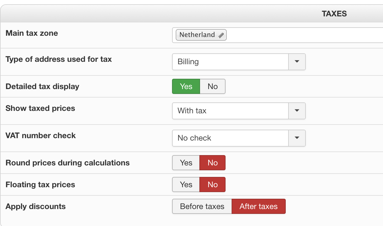

Now, can you tell me if the "show taxed prices" setting is activated or not in your HikaShop configuration ?

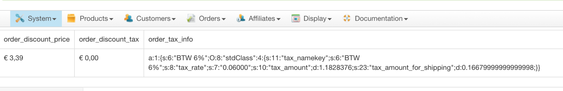

And also, can you go in the menu System>Mass actions, create a new mass action on the "order" data with a filter on the "order column" order_id with the value 1616 and with an action "display the values" with the order_tax_info, order_discount_price and order_discount_tax columns check and click on the "process" button ?
That will give you a table with data directly from the database for that order.
That will help us better understand the situation if you can provide that data for that order.
  • Posts: 198
8 years 9 months ago #281051
Tax settings:
And the results of the mass action
Regards René
  • Posts: 86050
  • Thank you received: 14178
8 years 9 months ago #281105
Ok, thanks !
You need to use that line of code:
$tax_amount = $taxes_info->tax_amount + $v->order_discount_price - $v->order_discount_tax;
And you also have to change the line:
$database->setQuery('SELECT order_tax_info, order_currency_id FROM '.hikashop_table('order').$filters);
to:
$database->setQuery('SELECT order_tax_info, order_currency_id, order_discount_price, order_discount_tax FROM '.hikashop_table('order').$filters);
in that same file.
That should normally work fine after that.

It should be true that total sales are equal to VAT + Total sales?
That is not the case, the difference is exactly the coupon value. The coupon will also be subject to VAT, so it must be added (in this case with the 6% VAT)
Vat rates
Admin total
Coupon tax
When I compare these values, difference is exactly the coupon value: (admin total) € 2.776,25 - (tax total) € 2779,64 = € 3,39
Kind regards René
