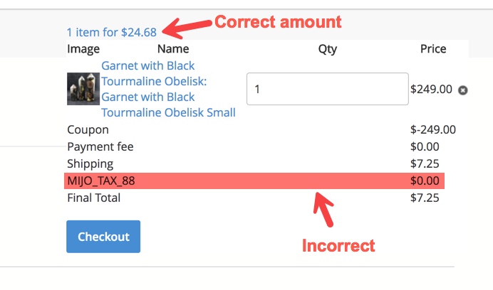

When I add a coupon to the order, in the minicart module the tax is set to 0.
Please see screenshot.

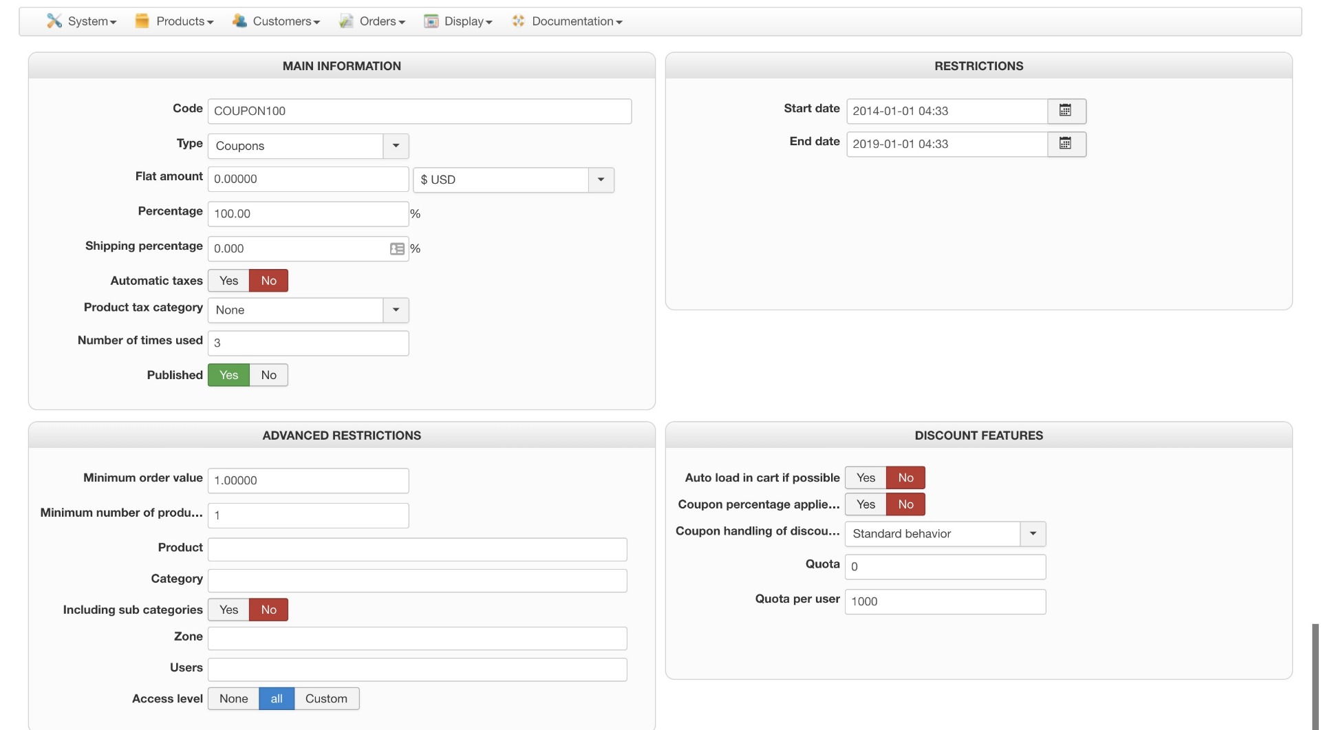

- a screenshot of the settings of the coupon

Please see attached screenshot with coupon details.

the problem is in the minicart module. Inside the module, the tax is not displayed. Instead of 17.43 for tax is says 0.00. Please see screenshot in first post.
Since you are not from the area on which the Tax is applied you can't reproduce the issue. I've changed your address and now you can see the Tax on the checkout page added to your order.
Once you see the Tax on the checkout page, please go to the minicart dropdown and look for the tax in there. You'll see is not displayed. Please see screenshot:
thanks!

We were able to see the problem now.
It's because the "show tax prices" setting was turned off in the settings of your cart module.
Hence, the tax wasn't displaying nor taken into account.
I've change that for you and it displays like the checkout now:
