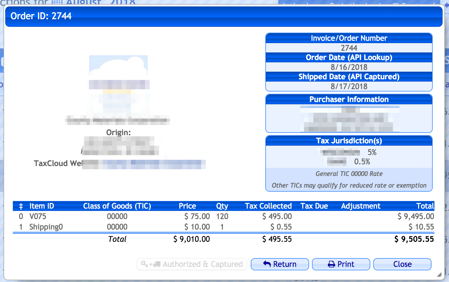

  • Posts: 176
  • Thank you received: 5
7 years 9 months ago #296797
I have sent the access info via your contact form. Please let me know if anything else is needed.
  • Posts: 176
7 years 9 months ago #296829
Not sure if it is related, but today I am getting reports of tax being calculated on the shipping cost. This wasn't happening before.
  • Posts: 26355
  • Thank you received: 4068
7 years 9 months ago #296848
I know that Nicolas handled your email for the credentials but I don't see any comment for any modification in the plugin or in your website.
  • Posts: 176
7 years 9 months ago #296874
It looks like the tax is no longer calculating in checkout. However, recent orders still went through to taxcloud as TIC 000000 (default in the taxcloud plugin) and ended up having tax calculated on that end.
Please see attached image.
This is a big issue that is causing hours of administrative correction. The cost to keep up with this is growing. You help in resolving this quickly is appreciated.

7 years 9 months ago #296913
Thank you for checking. As mentioned in my last post, the tax no longer is appearing in the checkout. That somehow resolved itself. The issue we are experiencing now is all transactions are going through to taxcloud as TIC 000000. This includes products marked with TIC 10005 (which is a gift card that should not have tax calculated). So, if a transaction goes through for a $100 gift card you don't see the tax in hikashop, but rather it is added as a tax liability on the taxcloud side.
Looks like you still have an active taxcloud login for our account.
Recent orders where this has occurred:
2716
2739
2741
2740
2744

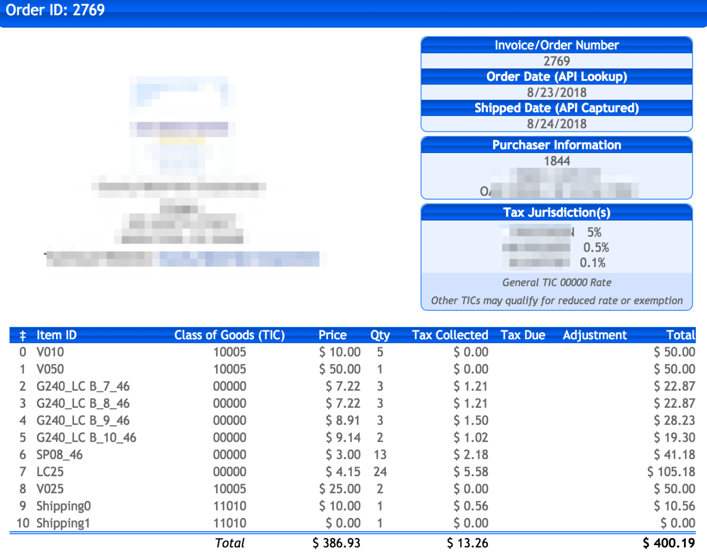

7 years 9 months ago #297269
Thank you, Nicolas, for the patch and thank you, Taxcloud, for the order updates.
There are a couple more VISA card transactions that need to have the tax removed:
2749 for $10,760 ($591.80 in tax needs to be removed)
2747 for $110 ($6.05 in tax needs to be removed)
Additional questions/issues:
1) When does the status in Taxcloud for an order update from authorized to captured? It seems to be when an order is updated to 'payment confirmed' or 'shipped' in Hikashop. Is this correct?
2) There still seems to be a shipping tax charge coming through on some orders. A recent one is Order# 2769. On this one there were 2 lines for shipping. Both were marked 10010, but one ended up having $.56 in tax being collected (see attached). Any ides why this occurred? This amount will need to be removed.
3) For the transactions that were missed, we manually entered them in (from May - July orders 2600 -2708). How is this going to affect our reports and liability in Taxcloud? Will it all roll into August or do we need to regenerate the previous months?
4) We still need to update/add orders 2599 - 2522 to be captured (that are all 'payment confirmed' or 'shipped' in Hikashop - but not 'captured' in Taxcloud). The reason we have been entering them manually is that the order numbers in Taxcloud for authorizations do not seem to match the order numbers in Hikashop until after the order captures. Also, the totals are incorrect (see below) so finding them is difficult. Is there a way of finding the matching authorized transaction and capturing these so we don't have to manually enter the rest?
4) $1 authorizations. In Taxcloud there are charges for $1 that appear in authorizations (tic_rate_0 00000 $ 1.00) that seem to drop off once captured. Is this correct?

7 years 9 months ago #297288
1. When the order is created a lookup request is made to TaxCloud in order to have the orderID / cartID registered with TaxCloud.
When the order is confirmed (so after the payment), a AuthorizedWithCapture request is sent to TaxCloud with that orderID / cartID so that the order can be validated.
2. I wouldn't be able to say. If the TIC is correct at 10010 then it's TaxCloud which calculates the tax amount to be paid and HikaShop only applies it. I suppose Taxcloud support will be able to say more on this.
