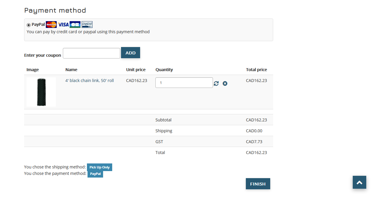

Thanks for the reply, BUT it's already set up that way, and it's still only adding GST to all sales, even in BC, where the tax rate is 5% GST, and 7% PST. So that's not working.

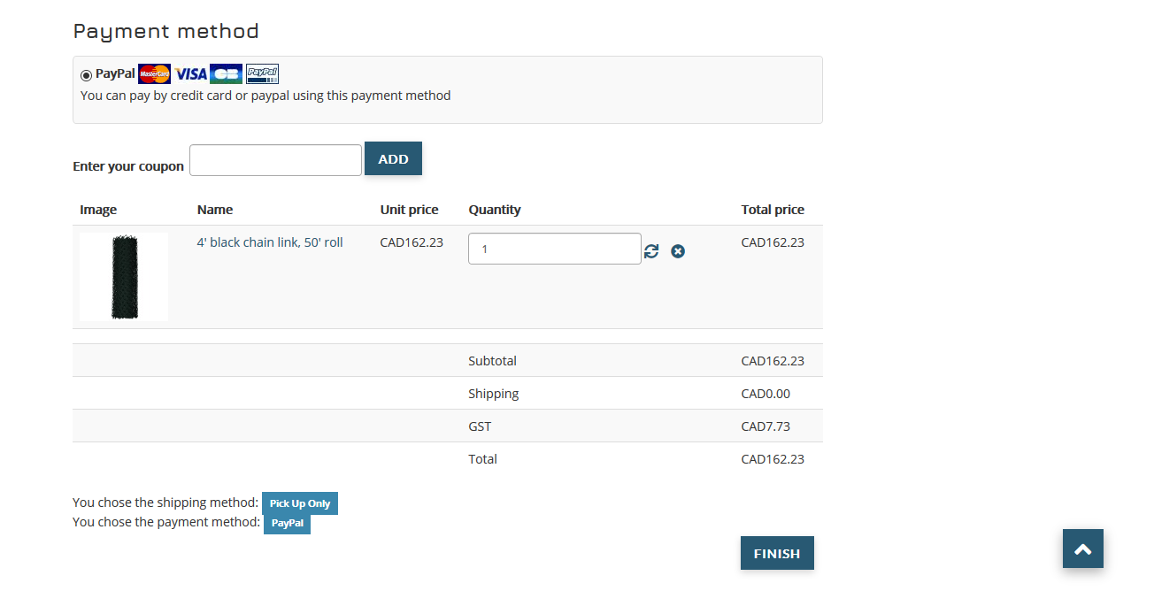

Also, more worryingly, the tax calculation seems to be wrong. A product costing 162.23 has GST (which is set at 5%) as 7.73. That's not five percent.
I need someone to log into my site and fix this so it works, AND calculates the CORRECT taxes! How do I make that happen?

Also, the tax amount is correct. So I don't know how you make your calculations but it's your calculations that are wrong.
If the total with taxes is 162.23 and you have a 5% tax rate, it means that the amount without taxes is 154.50. 154.50*5% = 7.23 which is what the amount it on your screenshot.

As for the tax amounts, thanks for the patronizing tone. Right after I sent it, I realized that that it was displaying including tax.... would have been easier to spot if it said something like.... I dunno. Including Tax?

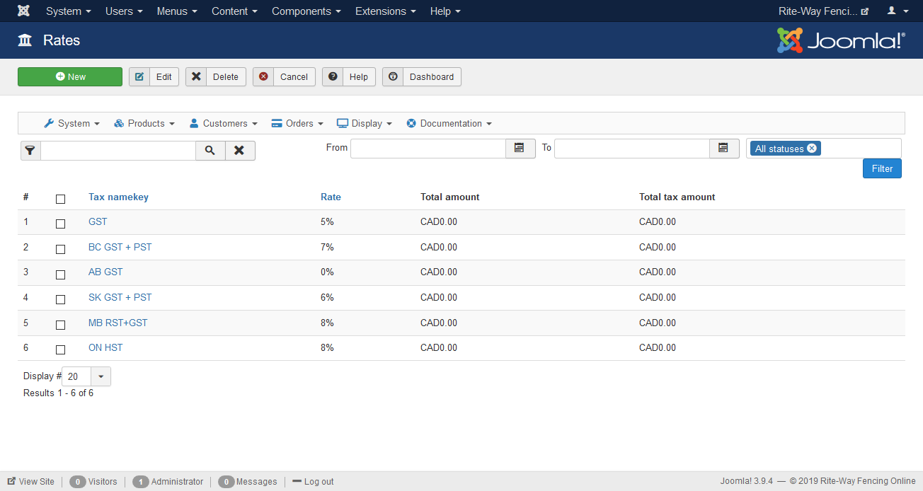

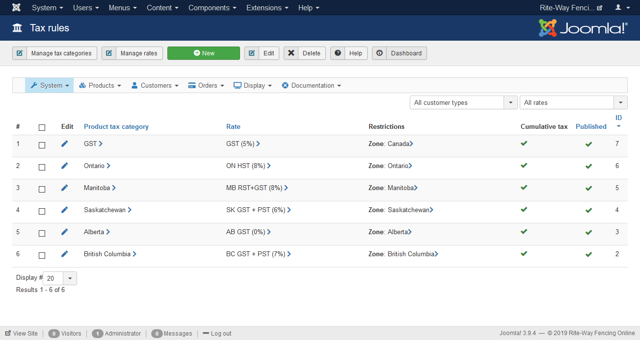

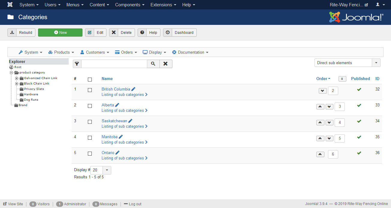

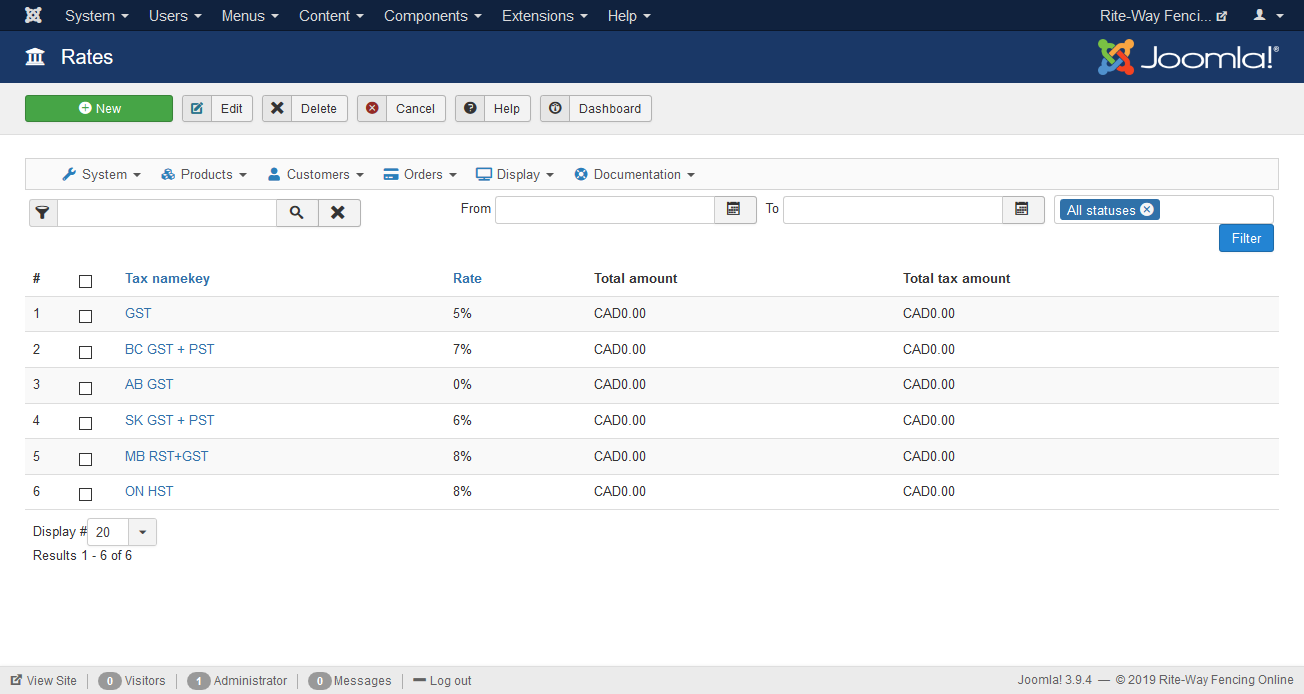

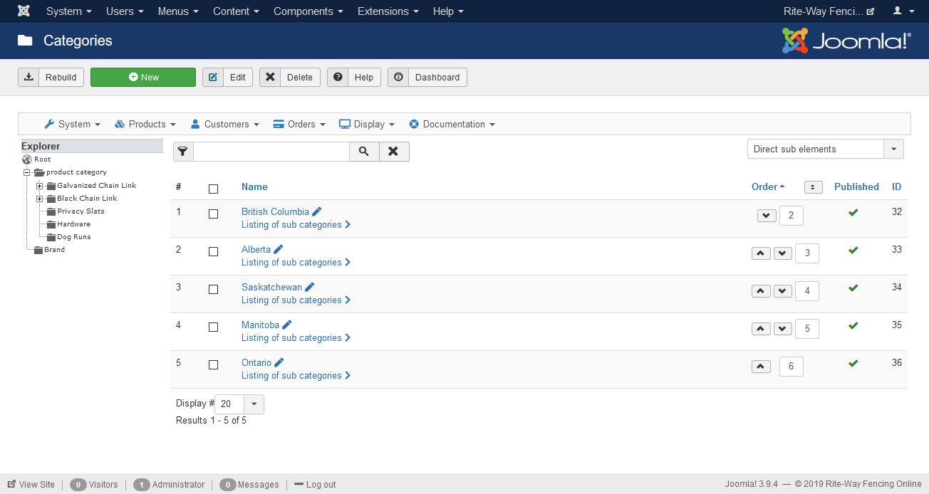

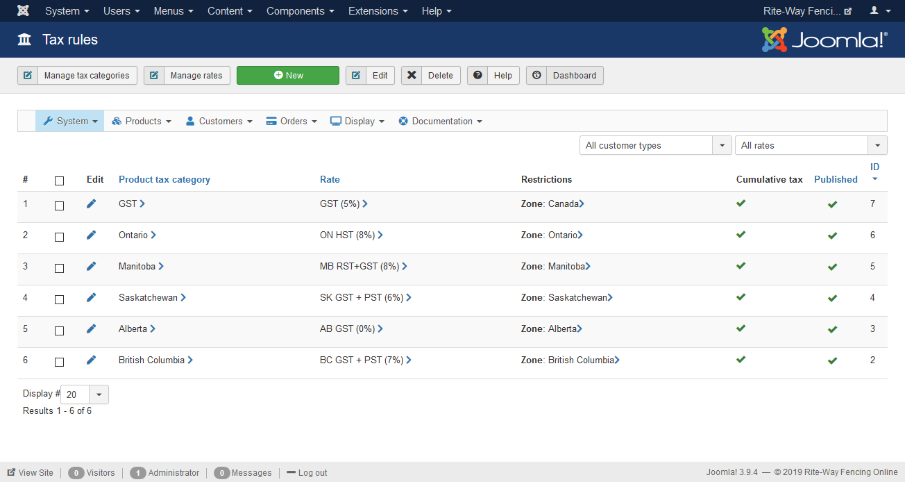

Here are the screenshots.
I'm not certain if these are the only ones related to tax, since I don't understand how your system works. So feel free to mention other settings, and I'll tell you if they are configured, and how.

You need to have one tax category, select it in your product and then create several tax rules for that tax category.
However, in your screenshots, I can see that your tax rules are assigned to different tax categories. So since your product it assigned to only one tax category, only one tax rule can apply to it.
You need to modify your tax rules so that they all use the same tax category which is selected in the product.
Then, you'll see that several tax rules can apply to the same product at the same time.
The rest of your taxes setup is correct.

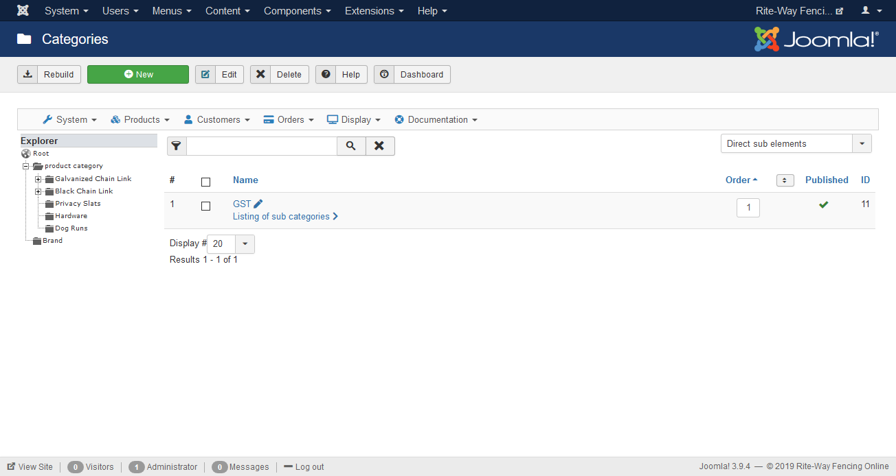

Yeah... just changed the taxes to be only Canada as the default, added the tax zones as sub zones under Canada, and it still doesn't work.
Could someone please direct me to some screen shots of how this should be set up, or could someone give me an email address where I can send a temporary login, so that someone can take a look and actually fix this?
