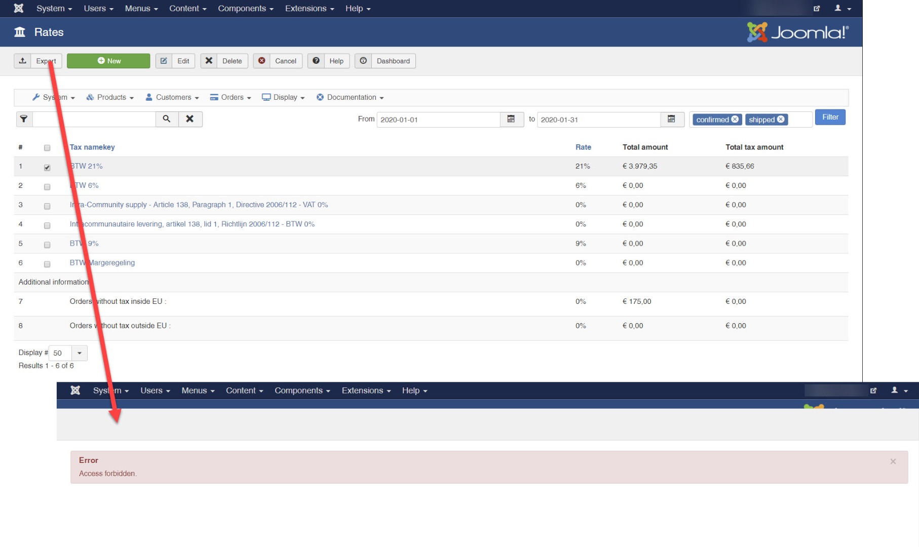

Hi Hikashop support,
I saw the new possibility to export the tax-rates for the accountant.
When we go to menu System>Taxes and then click on the "manage tax rates" button.
We can select tax namekeys and then export them.
But when we export them, we get an ERROR Access Forbidden.
I have tried it with a basic joomla .htaccess file then we still get an error.
As far as I can see we have this issue on every Hikashop sites.
Hope you know how I can fix this issue.

  • Posts: 86179
  • Thank you received: 14217
6 years 7 months ago #315323
Thank you for your feedback. I was able to reproduce the issue and added a patch for that. You can download the install package on our website and install it on yours to get the patch which will also be included in the next release of HikaShop which is to come out soon.

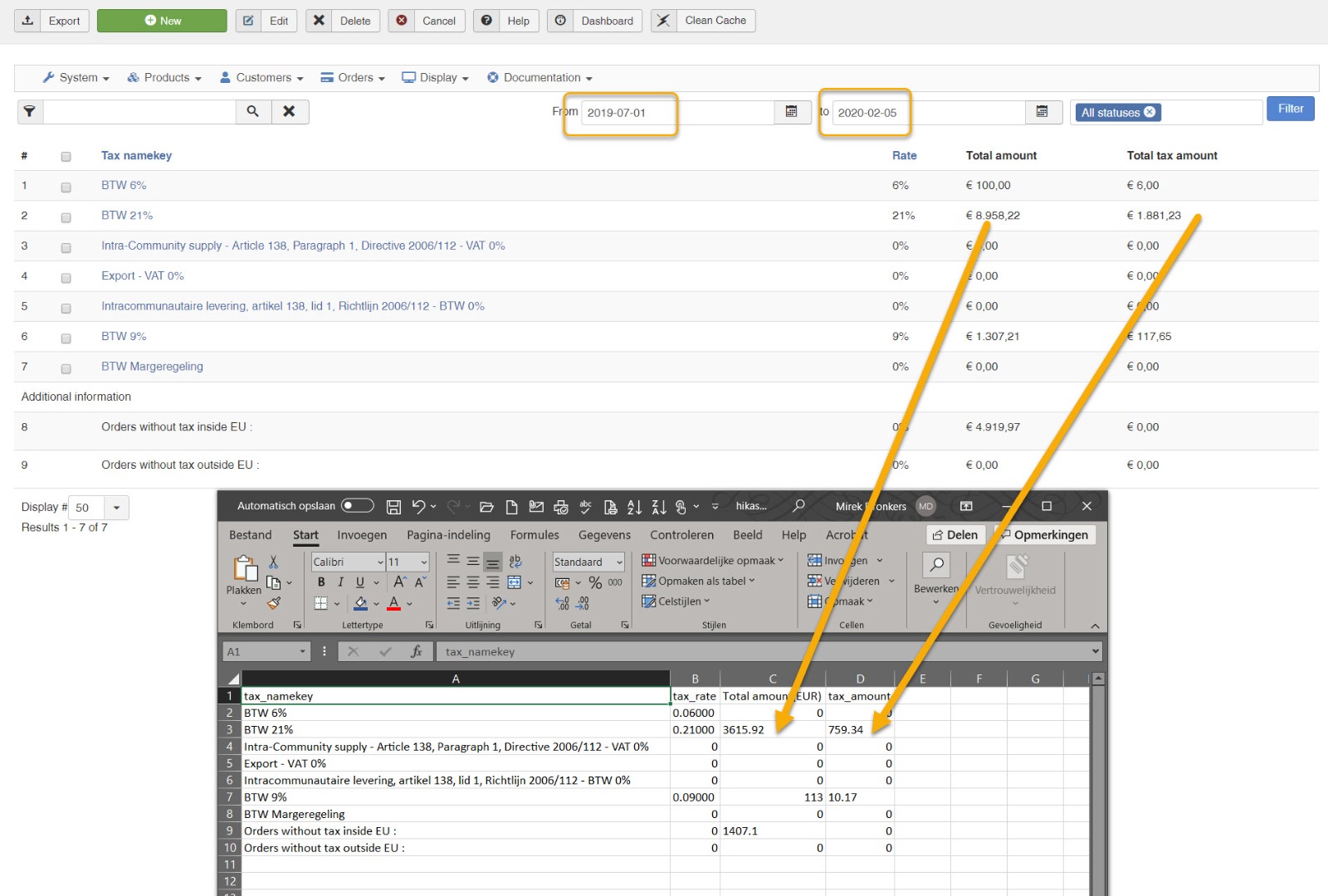

6 years 7 months ago #315418
Export is working fine, but it looks like I see other amounts then on the screen.
See screenshot:
Kind regards,
Lumiga
6 years 7 months ago #315430
We try to reproduce your issue (with start & end dates) and unfortunately on our side, everything works as expected.
So, can you provide your backend access (with backend url) via our Contact us form.
Don't forget to add an Url link to this topic in your Contact us message.
Awaiting news from you to move forward on your subject.

6 years 7 months ago #315435
Sorry Philip.
It's working fine, I forgot to use the filter button.
