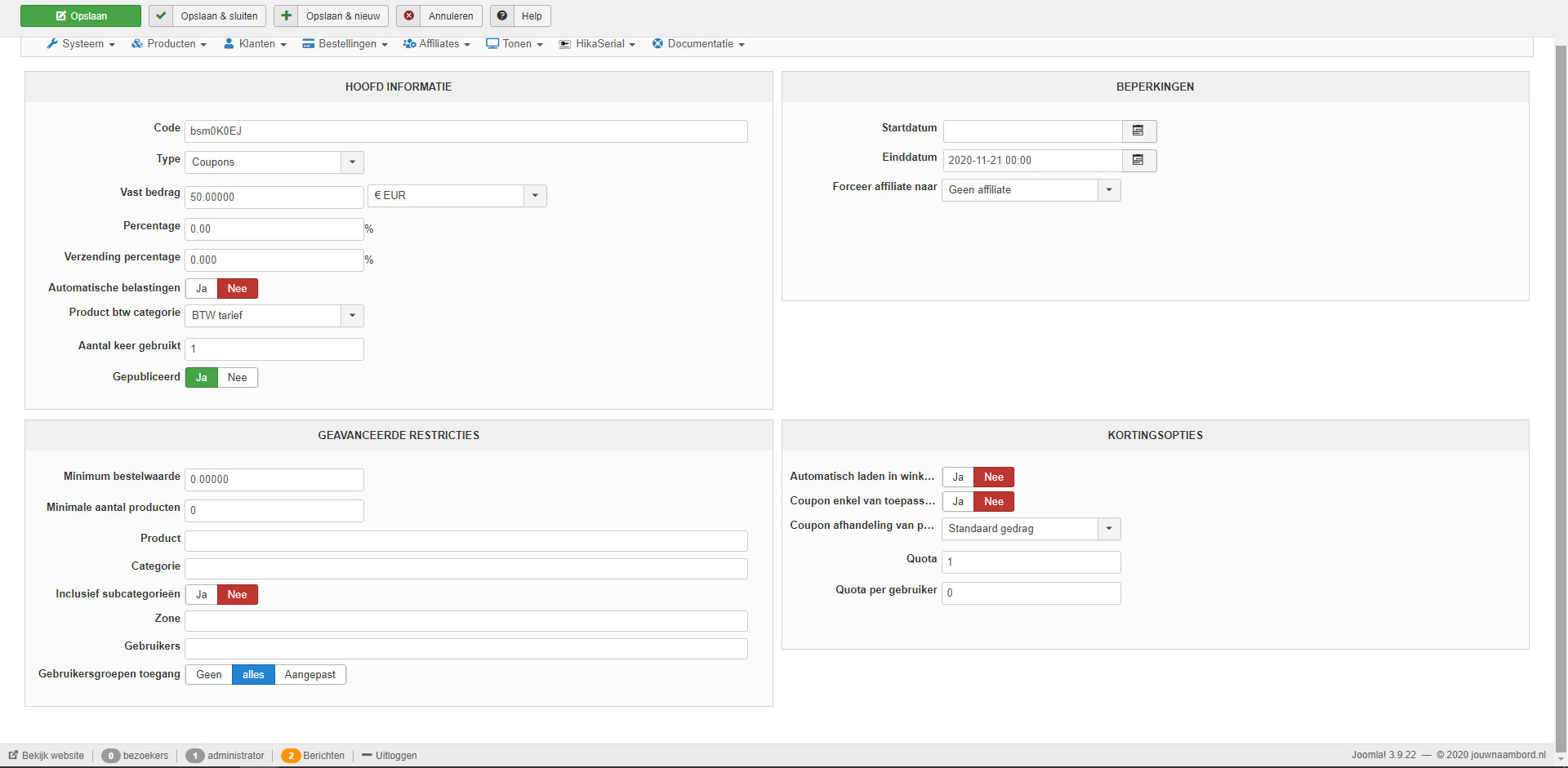

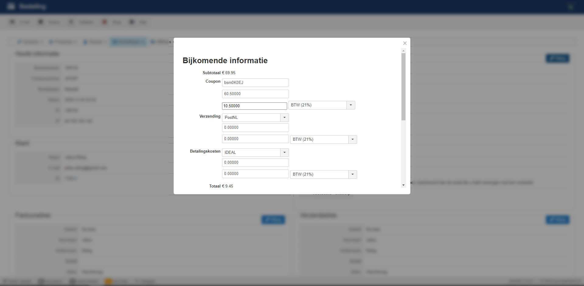

I updated to version 4.4. A client submitted a coupon of € 50,00. Now in the order the amount of the coupon is € 60,50, 21% tax was added to the coupon. Could this be a bug? See screenshots for the settings.

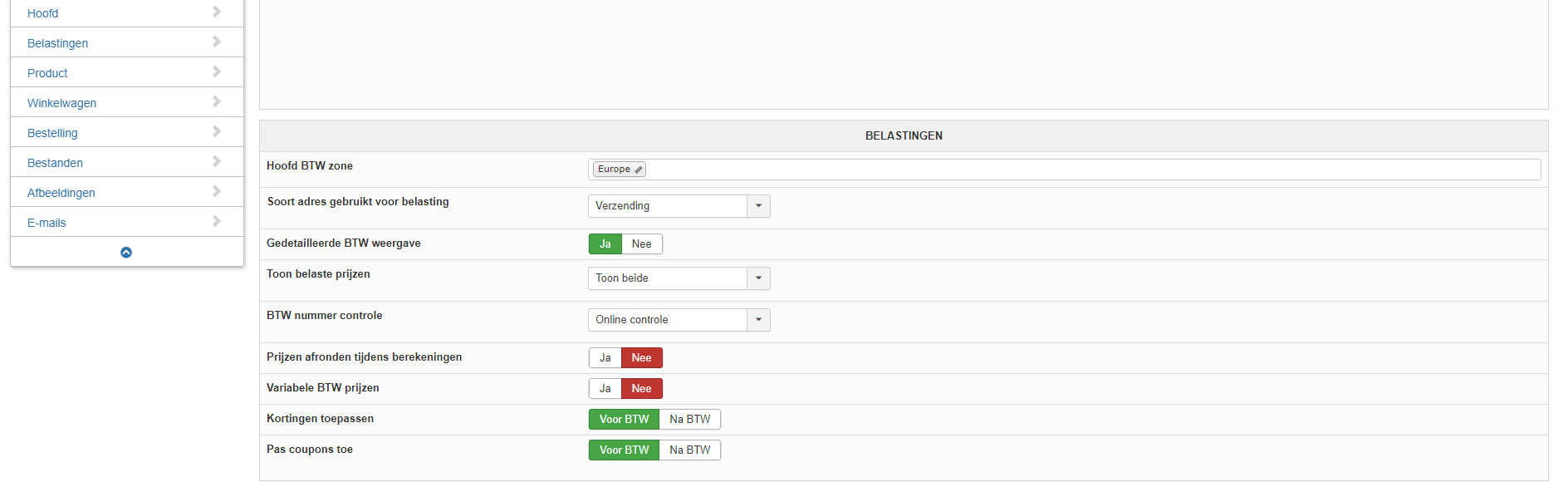

I would recommend to turn on the "automatic tax" setting of the coupon.
Also, make sure that the "Apply coupons" setting of the HikaShop configuration is set to "before taxes" and it should count the coupon's taxes properly.

5 years 8 months ago #326347
Please provide a screenshot of the settings of this coupon.

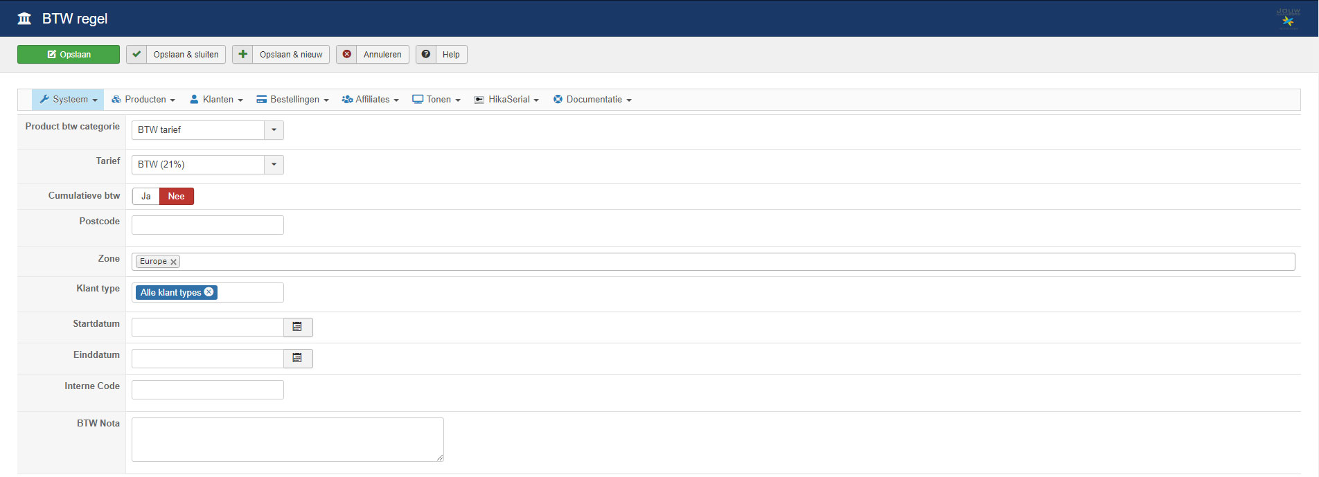

Please also provide a screenshot of the System>Taxes menu and another of the Taxes section in your Hikashop configuration.
  • Posts: 515
  • Thank you received: 22
5 years 8 months ago #326374
The settings of this coupon are the same as the screenshots I already provided. Hereby the screenshots of the tax settings in the system and hikashop config.

BUT you want to move in Main HikaShop configuration, and in Tax part, the Apply coupons option to After Taxes.
Can you process some test and confirm my idea, please ?

I did some tests as you suggested. Yes indeed, this does give the right result on the coupons. Thanks for your help.
