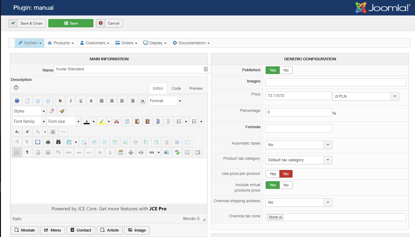

Hello once again,
My shop owner would like to have shipment cost on the PDF invoice shown with a net value and have the VAT added to total order VAT.
Let's say we have one 200 euro product and 23% VAT.
And shipment 100 euro and 23% VAT
Now total VAT shown is 46 euro, and we want to have 69 euro. Is it possible without much coding? I attach my setting for this shipment.
I use your PDF invoice plugin.

5 years 8 months ago #327584
The "price" you enter in the corresponding field of your shipping method is the gross price (the price before taxes are added.
Then, the system will calculate the taxes on that amount based on the "automatic taxes" and "tax category" settings of your shipping method as well as your tax rules.
So from what I understand of your example you have two problems:
- the system doesn't find any tax rule to tax your shipping method and thus NET shipping price = gross shipping price. So there is a problem with the way the taxes are configured. Maybe you didn't configure any tax rules for the "default tax category" ? Or maybe you could just activate the "automatic taxes" setting so that the system would calculate the taxes based on the taxes applied to the products ?
- you entered the price of shipping with the taxes included. You should instead enter the price without taxes so that the system can add the taxes. So instead of 100€, you would need to enter 81.30€ so that the shipping price with taxes would then be 100€.

5 years 8 months ago #327612
In real store I have set net shipping price 73,17 (as on previous attachment), the tax is 23%, which make the gross price 90.
In the frontend the client sees 90, which is correct. So it tells that my taxes are correctly configured.
I just would like to have the VAT (16,83) to be added to total VAT on PDF invoice. And show the net shipping price there (without tax). Is it possible? I will send you access via private message, as Phillip in other forum thread has just asked for it, maybe you could take a look.
