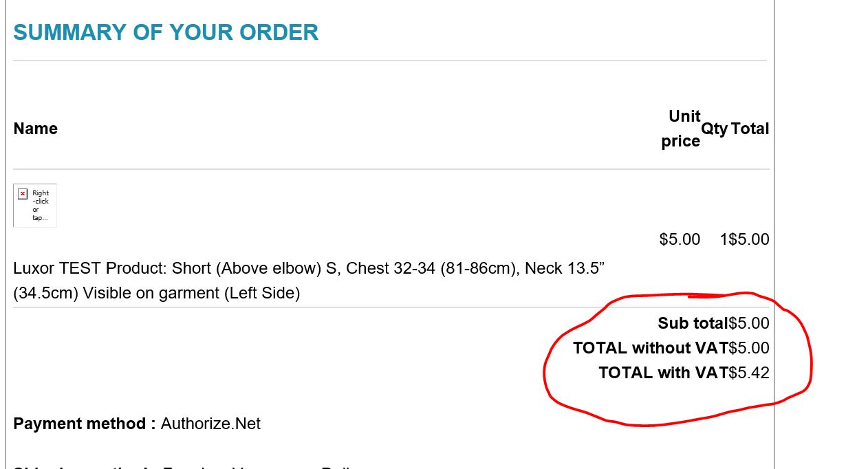

I had an issue with VAT showing on forms, I had not installed the Eng US language (see previous tickets above). I installed Eng-US language and had an order where US Tax was detailed correctly.
I had three orders today and VAT was again displaying. The amount is correct but it is being listed as VAT in the order, order emails and invoices.
I have added the overrides to the Eng-GB language file to change the references to VAT to be just 'TAX' but I don't understand why it reappeared as I have the Eng-US language set to default. I understand that when Hika upgrades it overrides the language files.

I am still having an issue with VAT text in order emails on orders placed in the USA.
A customer paid me offline so I put their order through the site. I setup a new email (This email address is being protected from spambots. You need JavaScript enabled to view it.) address, placed a new order and the emails sent when the order was placed shows VAT.
I have been careful about language, my laptop in all set to US English, my browser is set to US and I still get emails showing VAT.
I have also added overrides to the Eng - GB language file in the configuration.
I do not want VAT to appear ever, my shop is in the USA.
Is it is driving me mad.
Zoe

There are two ways the text VAT can appear in the emails:
- with the translation texts. If you have overrides for them for your different languages, then it won't come from that.
- with the name of the tax rates. You can check them via the "manage tax rates" button of the System>Taxes menu.

Thanks again for getting back to me. I put the overrides in the Eng GB and Not the Eng US language files. I just wasn't expecting to see mention of VAT in the Eng US language file so didn't look for it.
FIXED.
Thanks!!!
