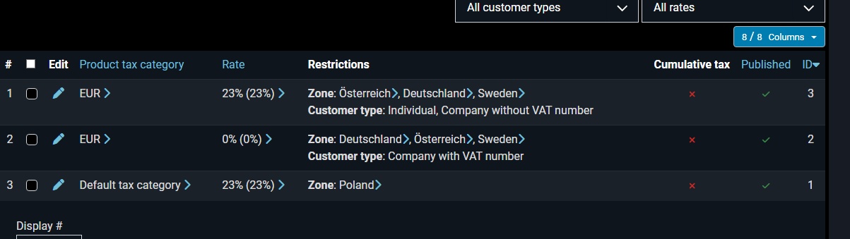

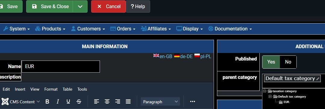

I changed the tax settings. It's like on the screenshot. When choosing an address in Germany, VAT is not added for companies and individuals.

1 year 6 months ago #365929
This screenshot has nothing to do with what I said to do.
Go in the menu System>Taxes.
You should see this: www.hikashop.com/media/kunena/attachments/82931/hika.jpg
There, you have an edit icon for each tax rule, on the left side, next to the checkbox.
Click on the edit icon in order to edit the tax rule.
On the edit page, you have a tax category setting.
There, you want to select "Default tax rate", not "EUR".
Save and repeat for all three tax rules of www.hikashop.com/media/kunena/attachments/82931/hika.jpg
Then, it should work.

  • Posts: 6
1 year 6 months ago #365939
Ok, I changed the category in another place :)
