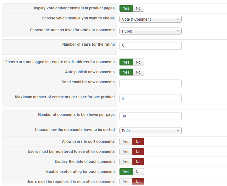

  • Posts: 16
10 years 1 month ago #245886
hi,
Thank for replay .
You said something that I did not
I attached a picture of the sector
help me
  • Posts: 16
10 years 1 month ago #245887
hi,
Thank for replay .
help me

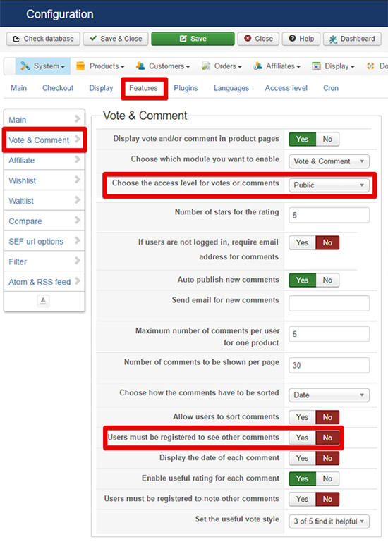

10 years 1 month ago #245888
Can you try to reproduce this configuration ?
For this :
- Go to Components => HikaShop => Configuration,
- Then in Feature tab,
- And Go to Vote & Comment part
- And reproduce this configuration on the screenshot, and especially those which are red framed.
Hope this will able your customers to see all comments in all case.
Last edit: 10 years 1 month ago by Philip.
  • Posts: 16
10 years 1 month ago #245985
Thank You
my setting like this setting(your picture), But already exists problem!
for view comments, user must send a comment. and this very bad :(
