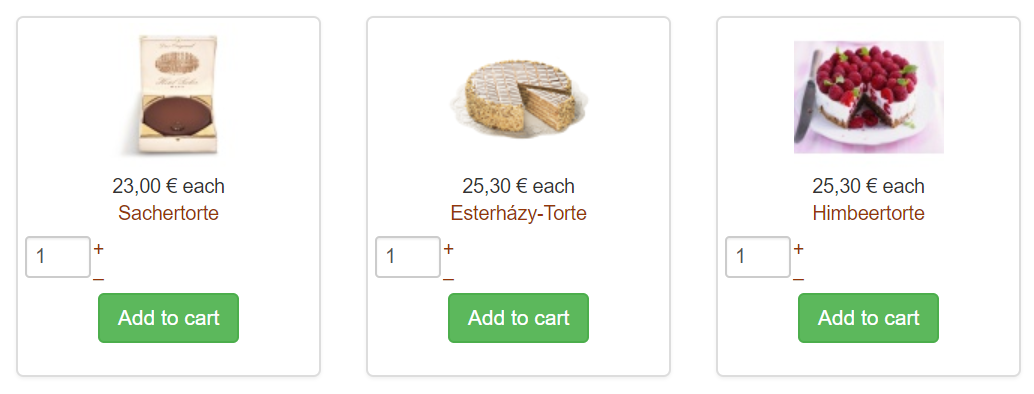

-- HikaShop version -- : HikaShop Starter 3.2.1 [1711170809]
Where are the settings i have to activate to see votings on my front end.
It looks like this:
Furthermore I am not able to write any comments in the back end. I filled in every field but i still get "Error Saving". Do I have to acitvate anything?
Thanks in advance.

When you edit your menu item via the Joomla menu manager, there is a setting to display the votes on the listing. Make sure that this setting is activated.
And please check that the vote and comment feature is activated under the "features" tab of the HikaShop configuration.
