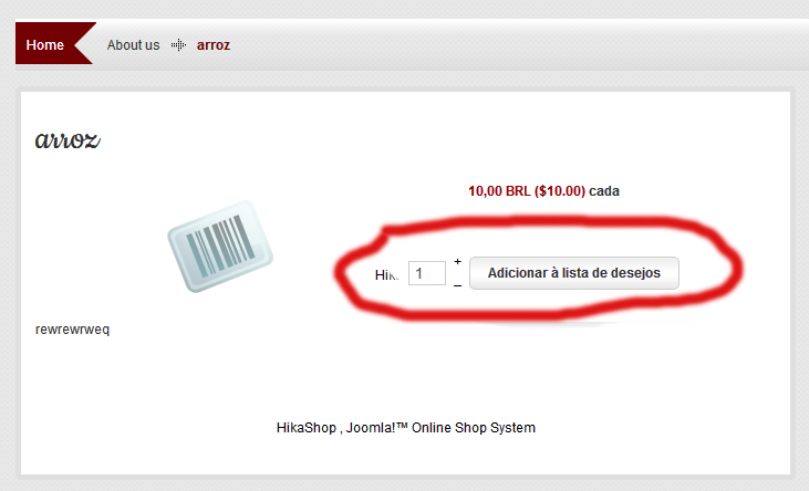

hello, I only want to use the wishlist and print your list, how can I do?
12 years 4 months ago #153190
You have to enable the wishlists in Configuration > Features > Wishlists.
Then disable the option "Display 'Add to cart' button" in Configuration > Display > Products.
By this way only the wishlist buttons will be displayed.
Then you can create a wishlist menu (cart show vut select wishlist type) and in that view the customer can print the list.

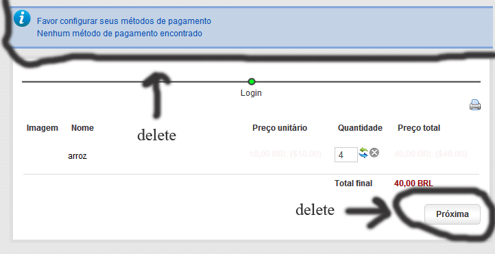

Thanks, solved my problem, now I want to delete the warning: Please configure your payment methods
No payment method found and button next on the page of checkout
thanks!
12 years 4 months ago #153505
You should not allow to reach the checkout page, but create a menu "showcart". It will display the cart without asking for checking out.
In the main configuration of hikashop, in cart section when a user add a product to the cart select the value "always stay on the same page" in order to not redirect them to the checkout.

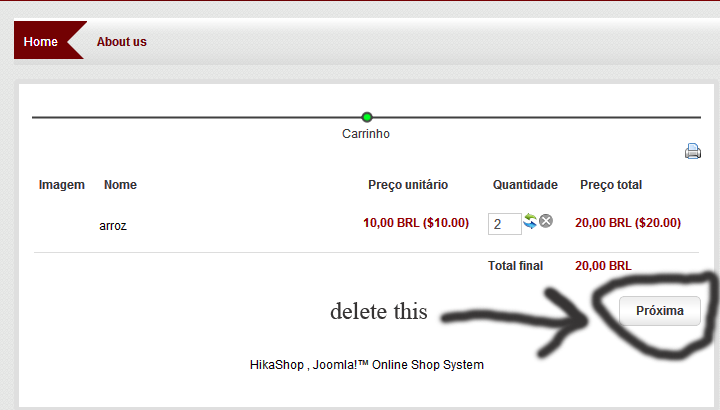

hi,
thanks for the help, unfortunately I edited the site to print this part, every part has been edited lacking only this button, I appreciate if you can help me delete it. thanks.
12 years 4 months ago #153798
So you have to edit the view "checkout / step" and add the code
$this->nextButton = false;
Before:
if($this->nextButton)
The following user(s) said Thank You: alanjosino
