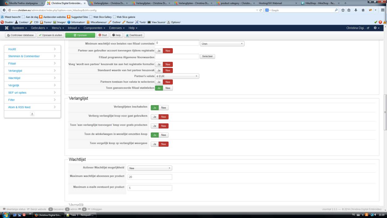

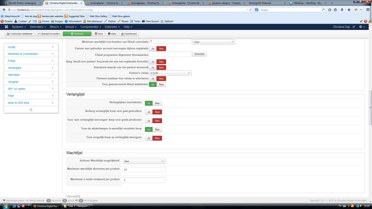

11 years 10 months ago #167864
Can you give us a screenshot of you configuration regarding the wishlist in Configuration > Features > Wishlists ?
In the display part of the config do you have enabled the display of the wishlist button ?

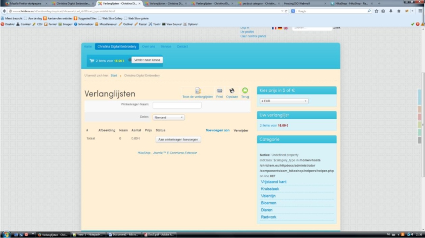

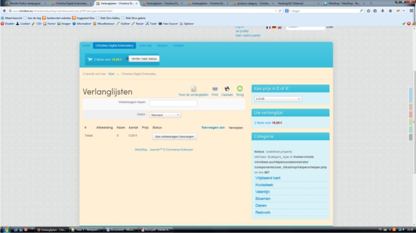

  • Posts: 14
11 years 10 months ago #167908
Yes the display of the wishlist button is enabled.
For the configuration see att. 1
For a screenshot of the wishlist see att. 2
It says it has products in the wishlist, but as you can see there is nothing.
Tineke

  • Posts: 14
11 years 10 months ago #167988
Hello Xavier,
Hereby a new attempt to sent the screenshots. I had a wrong format.
testaccount:
huubje
12huubje34
