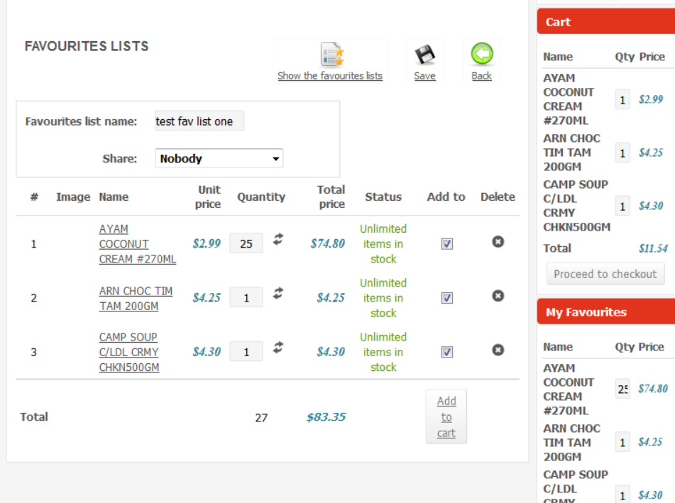

-- HikaShop version -- : Business: 2.3.5
When a customer views a wishlist and ticks the check box then adds it to cart. The quantity of each item added to the cart is 1 for every item and not the quantity for each product as listed in the wish list. How can that be changed so the quantity added to the cart is the same as listed in the wishlist.

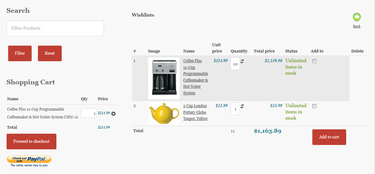

11 years 5 months ago #197140
My hikashop and joomla are the latest versions of today.
Dev site and wishlist:
andersmartin.com/index.php/component/hik...-wishlist?Itemid=729
We are currently setting the site live, without the wishlist active. So if it propagated and the above link does not work, please go to
jennyandcompany.com/index.php/component/...-wishlist?Itemid=729
I have the same issue where the wishlist only adds 1 item at a time to cart.
On the demo it appears that you can update quanitity that you want to add to cart.
For example, the user is not able to choose 2 or 10 of coffee pot?. See attached.
I posted here because I noticed you fixed code for someone who had an over-ride on "cart / showcart". So, before I posted I deleted my over-ride and re-installed hikashop. That did not change anything.
Thank you for your time
Last edit: 11 years 5 months ago by JennyCo. Reason: Propagating domain from dev site to live site
