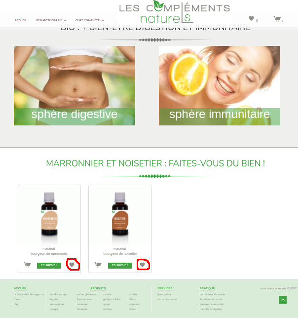

I am using mod_hikashop. the problem also occurs when using category listing menu item.
both catégory listing and module are using the listing image and title div layout wich I have customized and attached. Also, I have surrounded in red the hear icon that is not working on the attached picture.
The cart icon works ok but not the heart
Thank you for your help.
Ph

You're apparently using outdated view overrides.
And there is a bug in one of them as far as I can see.
I think that the issue either comes from the file "quantity" or "quantity_legacy" of the view "product" where you must have the line:
$formName = ',hikashop_product_form';
instead:
$formName = ',\'hikashop_product_form\'';
So please try changing that via the menu Display>Views and it should help.

Since you're using the legacy add to cart and you have overrides which are based on old HikaShop views (and we don't know which versions), it's very complicated to understand and analyze the situation.
The patch that Nicolas proposed looks good regarding the current views, since the content can be used directly in some JS and there is no variable with the name..
You can see it directly in your website by clicking on the button you got the message
Uncaught ReferenceError: hikashop_product_form is not defined
So the patch would fix the issue we can see in your homepage.
Now, because the add to cart system had problems and couldn't evolved like we wanted, we made the new cart system in HikaShop 3. That system has been made to avoid the issue you're currently having (not more inline JS).
So my first advice would be to try to use the new HikaShop cart system.
And my second point would be to try to use the default HikaShop views in order to have a fixed context. Because you have customization we can't know what code you have and if you use the official content ; we could have that knowledge and know what is happening exactly.
