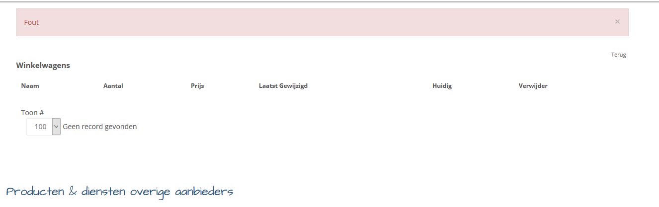

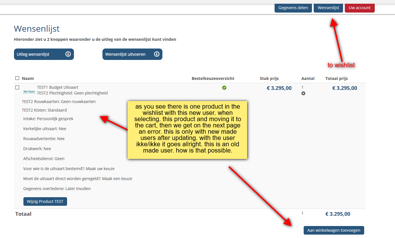

When i make a new customer on the webstie and login on the website all seems well, except when i make a wishlist and want to move the item to the cart i get an joomla error notification. and nothing is moved to the cart. Is this a bug in the new system it looks like it happened after updating both hikashop aswell as joomla. Or can it be i have configured something wrong.

Some more information about this with screenshots.. it is on the
Hope you can help with this user issue.. this is now when we create an new user we get this issue with new users/customers in the shop in the wishlist.

If you look at the product page of that product, when you're logged in with the old user you have both add to cart and add to wishlist buttons. But if you login with the new user you have only the add to wishlist button.
So it's normal that if you try to transfer the product from the wishlist to a cart, the operation is refused as you don't have the right to add the product to the cart in the first place.
The question now is what is the difference between the two users leading to that.
I don't think that it's a bug but just the way the shop is configured.
I'm not sure why though.

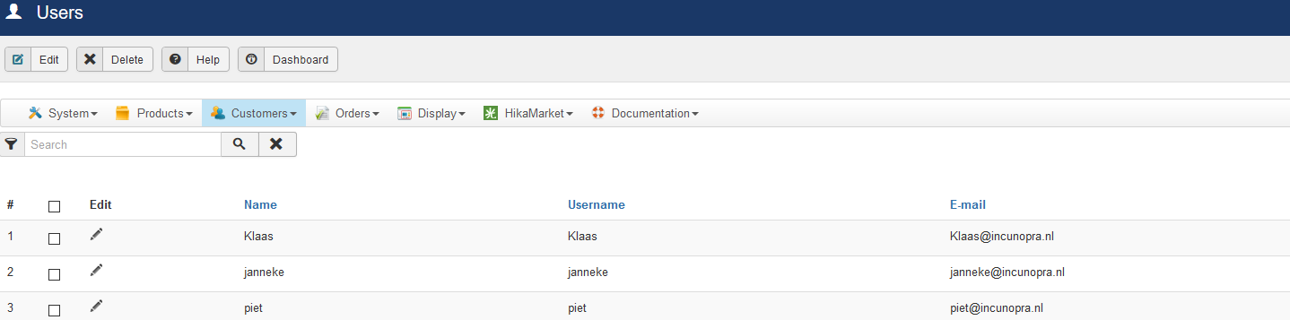

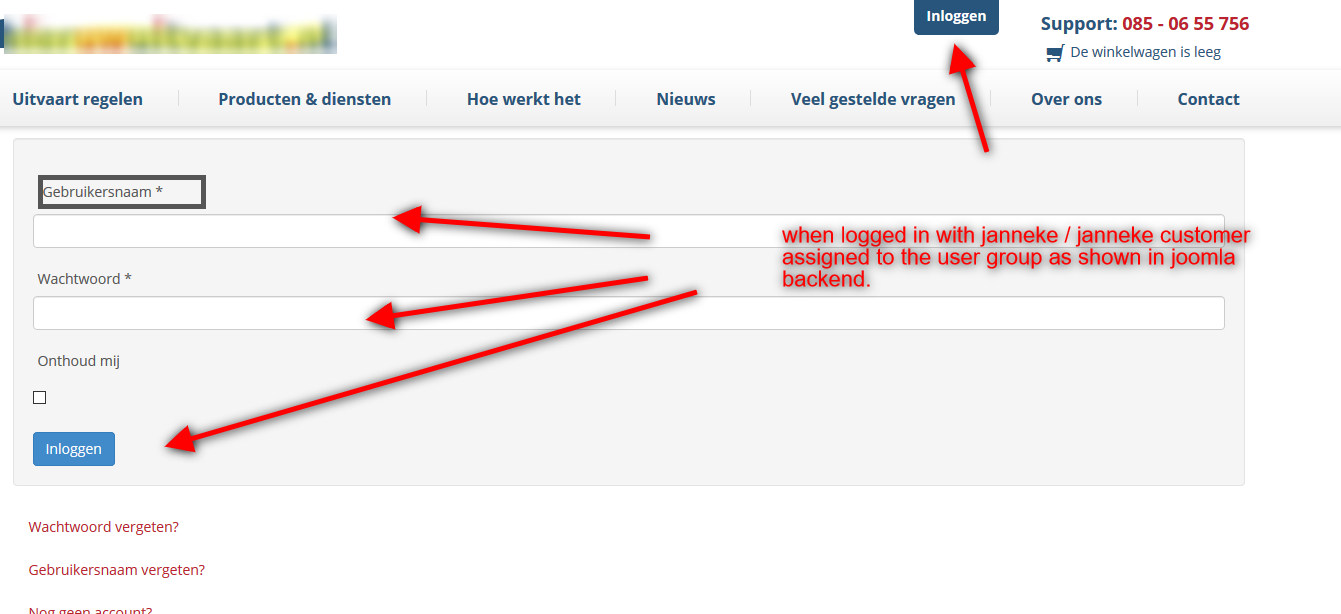

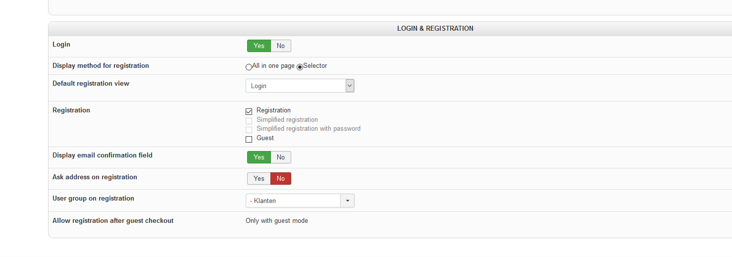

Hello Thanks, for this explaination.. the settings for the rights.. i have made a pdf with what is going on so to say. For explaination of the pdf.. i divided it in 3 steps.. step one is when the error occurs.. and what a route is what should be working. what i discovered is, is that in step 2 then it works allright.. but first there must be something in the cart otherwise no cart is made and the customer can not put a product from wishlist into the cart. and in step 3 it goes well but we don't have the need and don't want the customer to have multi cart.

The step by step proces. as explained in the pdf. This new customer has an item in its wishlist. Like in step 1 of the pdf the following happens when moving the product to the cart we get an error.
I allready put an item in it so you can see that step by yourself.
When you go back and select for example this product: hierutest.incunopra.nl/producten-dienste...oduct/basis-uitvaart and put this one into you cart. you have now two products 1 in the cart and 1 in the wishlist. When you now go to the wishlist and put this product into the cart it works? And step 3 of the pdf is working but we do not want multi carts on.
So it looks like that there is no cart made for the customer in the first step and that is why no product will go from wishlist to cart.

I think that you're aware that you have a full customized view and you are not using the official HikaShop features.
Your customized code do not give the right parameters to the JS function "moveProductsToCart".
I told you the exact same thing some weeks ago : www.hikashop.com/forum/wishlist/892101-m...t-button.html#279919
So please first, update to HikaShop 3.2.1 in order to have the latest patchs.
Then, please try to reproduce the issue with the official interface (the official HikaShop toolbar).
If you can reproduce the issue with the official content ; then we will be able to investigate.
If you can't have that problem, it would mean that you need to adjust your customization according to the HikaShop code.
