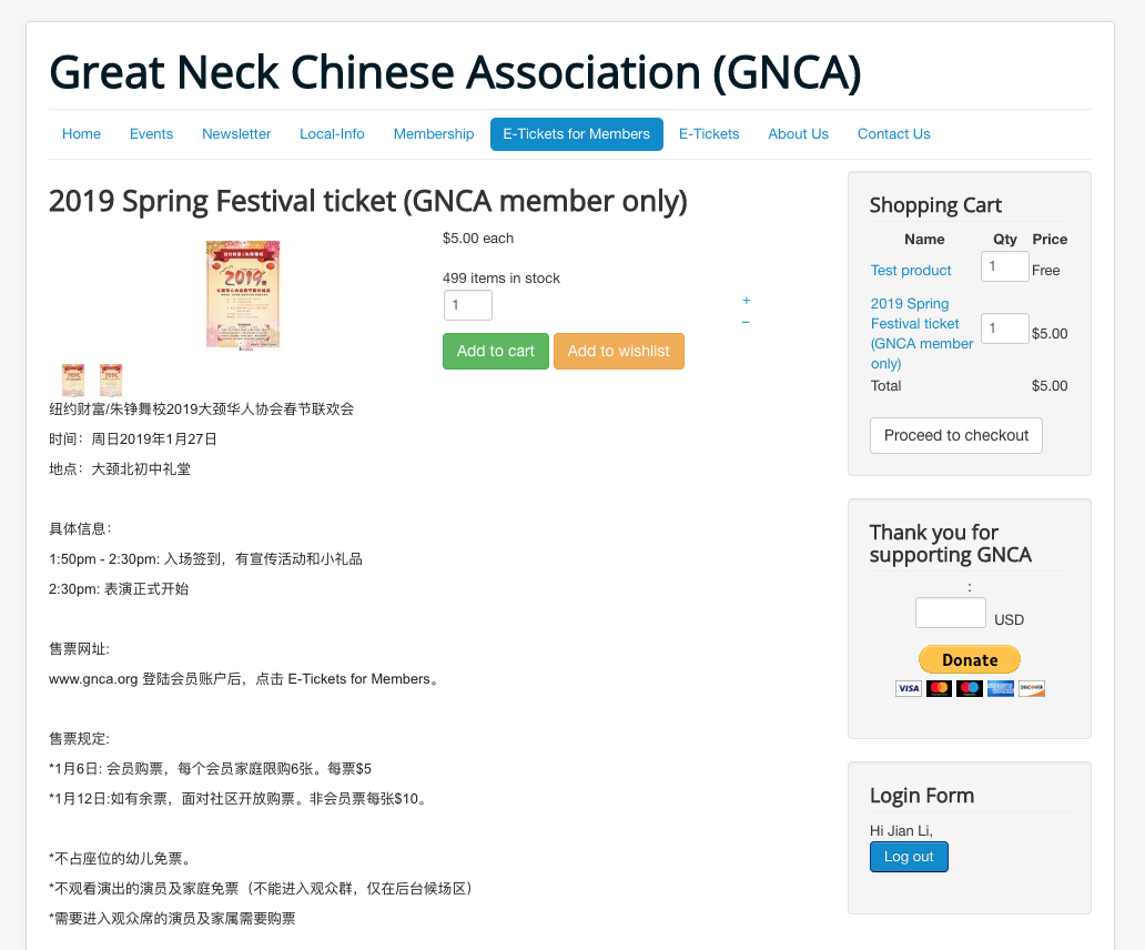

Can not disable "Add to wishlist" button on ordering page.

-- Error-message(debug-mod must be tuned on) -- : Can not disable "Add to wishlist" button on ordering page.
Follow up guide on www.hikashop.com/support/documentation/1...op-cart-listing.html to disable wishlist, but still see the button of "Add to wishlist" on ordering page.

I already turned off the "Display 'Add to wishlist' button" setting under the Display tab in the HikaShop configuration, but I missed the setting in HikaShop configuration -> Features.
Turned it off in Features, then works.
But the guide on www.hikashop.com/support/documentation/1...op-cart-listing.html does not mention HikaShop configuration -> Features at all.
