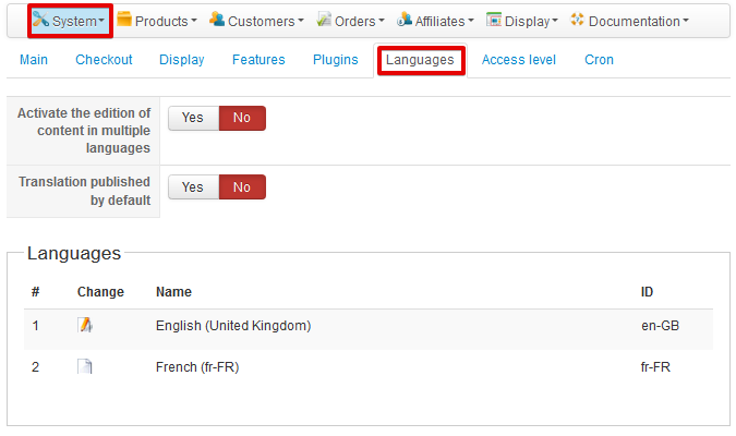

Hi there. I want to have my shop in 2 languages. I can I set up it. I installed the language pack for both languages Hikashop->System->Configuration, but how to make a Language switcher?

What do you mean? Aside from the issues when updating to Hikashop 3 I also came to this problem.
I updated on a test site to 3.0.1, when going to Hikashop -> Configuration -> Languages I don't see this any Activate content in multiple edition or translation published by default as what I see on the picture: www.hikashop.com/support/documentation/10-languages
What I see is this message stating that I need to install Falang or Joomfish.
Activeer de editie van inhoud in meerdere talen U moet Falang of Joomfish installeren om de meerdere talen editie te gebruiken
Do I need any third party components in order to be able using Hikashop multilanguage? I want to simply use the Joomla language switch, parsing Hikashop categories and products in different language versions. Is this possible? How? I don't see anywhere any possibility to create language versions of products or categories. I have two languages installed and I can see them in the Hikashop - Languages.
thanks for help

1. You asked me how you have a language switcher on your website. So I told you to use Joomla's:
docs.joomla.org/J3.x:Setup_a_Multilingua...te/Language_Switcher
2. Yes, you should use Falang or another third party translation tool.
Here are the instructions:
demo.hikashop.com/index.php/en/hikashop/...ge/with-translations
