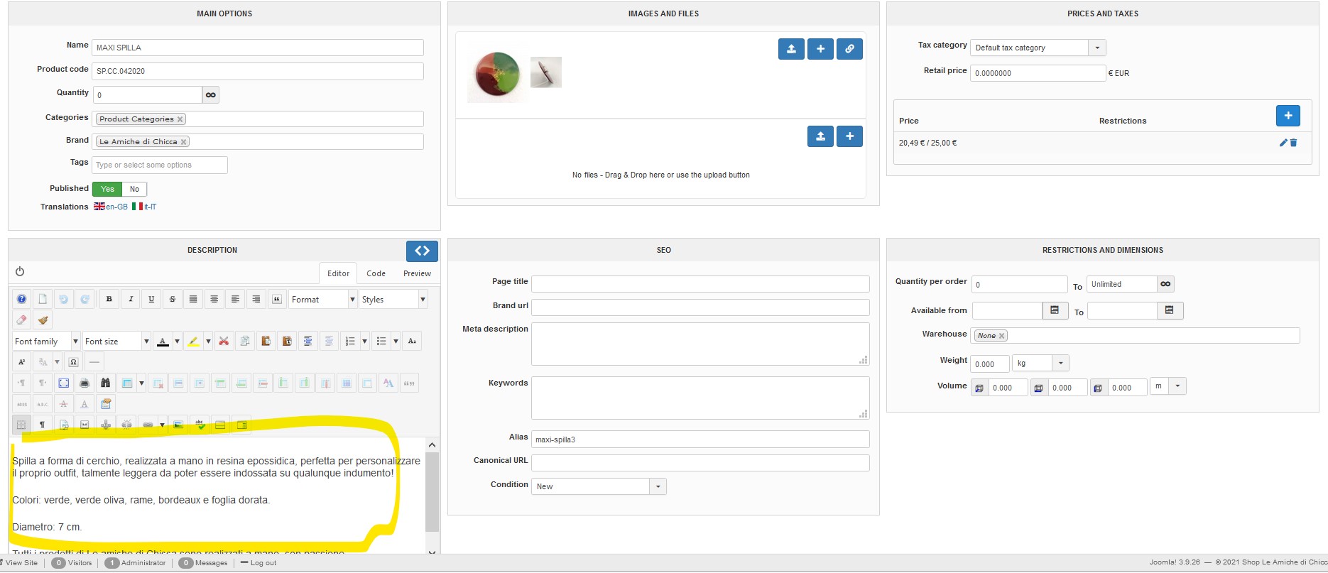

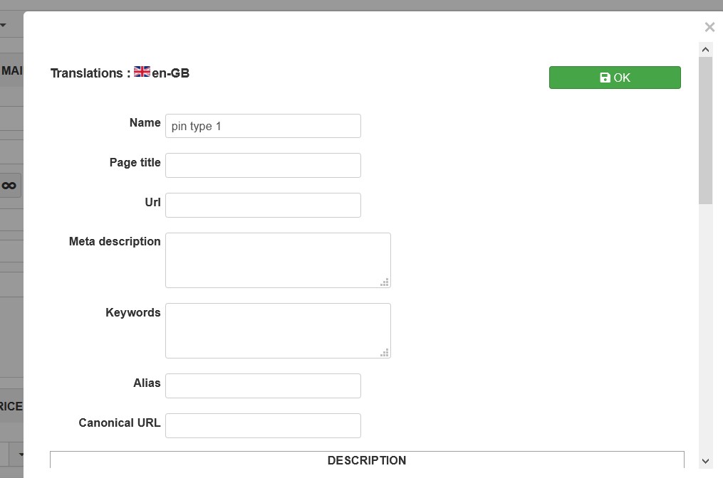

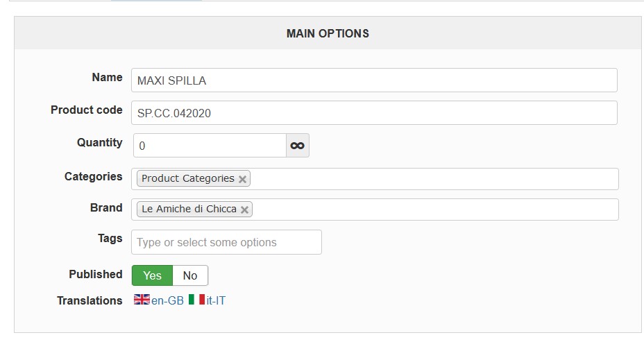

I have problems wih translation of product page: I've activated the "Activate the edition of content in multiple languages" Option then in my product menu of hikashop appeared the two flags. But when I fill the fields inside and go to Frontend no modification is shown. If I click on flags to change language, all other things switch to correct language, but the product name, description and so on remain the same contained in the standard fields. Nothing of text inserted in the two translation pages appear.

First, if you open again the translation popup, do you still see your changes ?
And second, if you go in the Languages tab of the HikaShop configuration and edit your language file, on the right side of the page, you'll see your translation overrides, which should normally contain the translations you've added in the popups. Do you see them there ?

The changes i put in the translation box sometimes gives an error when saving (
Error 1136 Column count doesn't match value count at row 1) but of I reopen the same Window the data Is still present.
