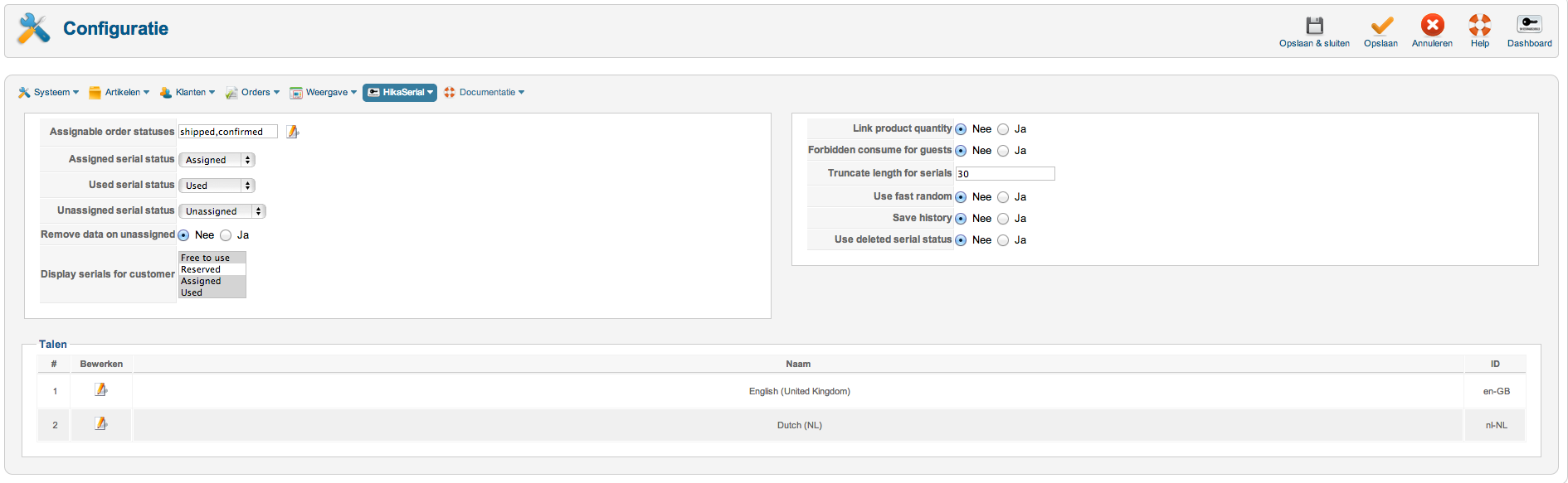

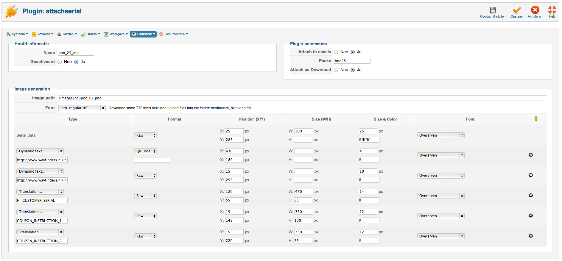

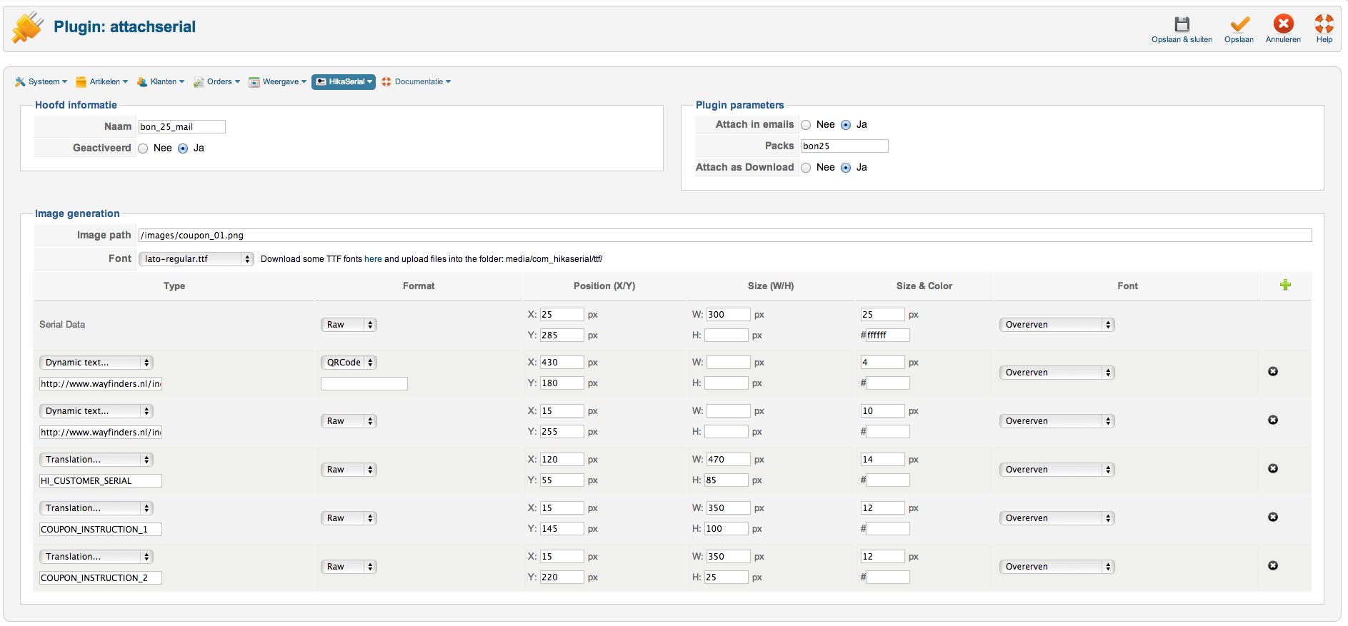

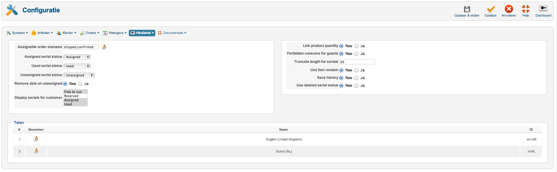

12 years 11 months ago #125925
So, can I have a screenshot of your attach serial configuration and some details about your HikaSerial configuration ?
  • Posts: 21
12 years 11 months ago #125926
I add some screenshots.
Peter
12 years 11 months ago #125929
In the "pack id" you have to put the ID (number) of the pack, not the name.
It is planned that I replace this input box by a pack selector (which will be easier to understand), I have to find some time to do it.
