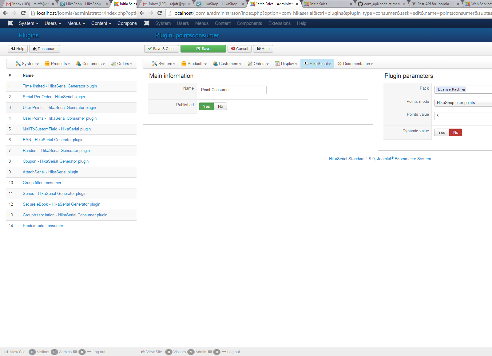

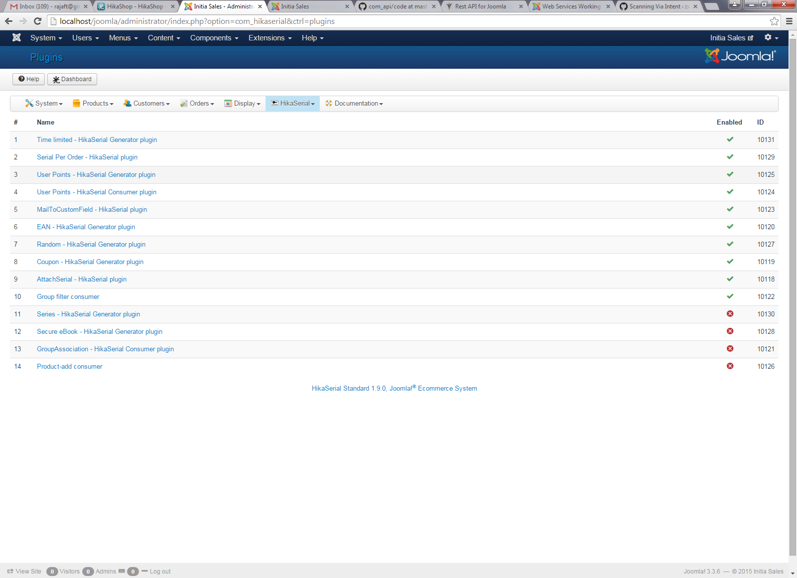

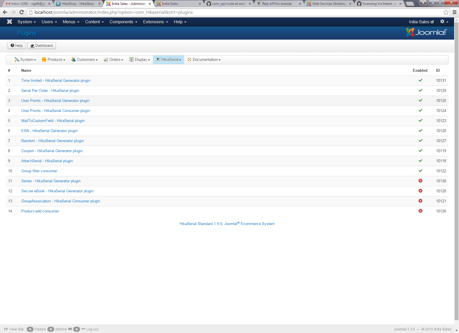

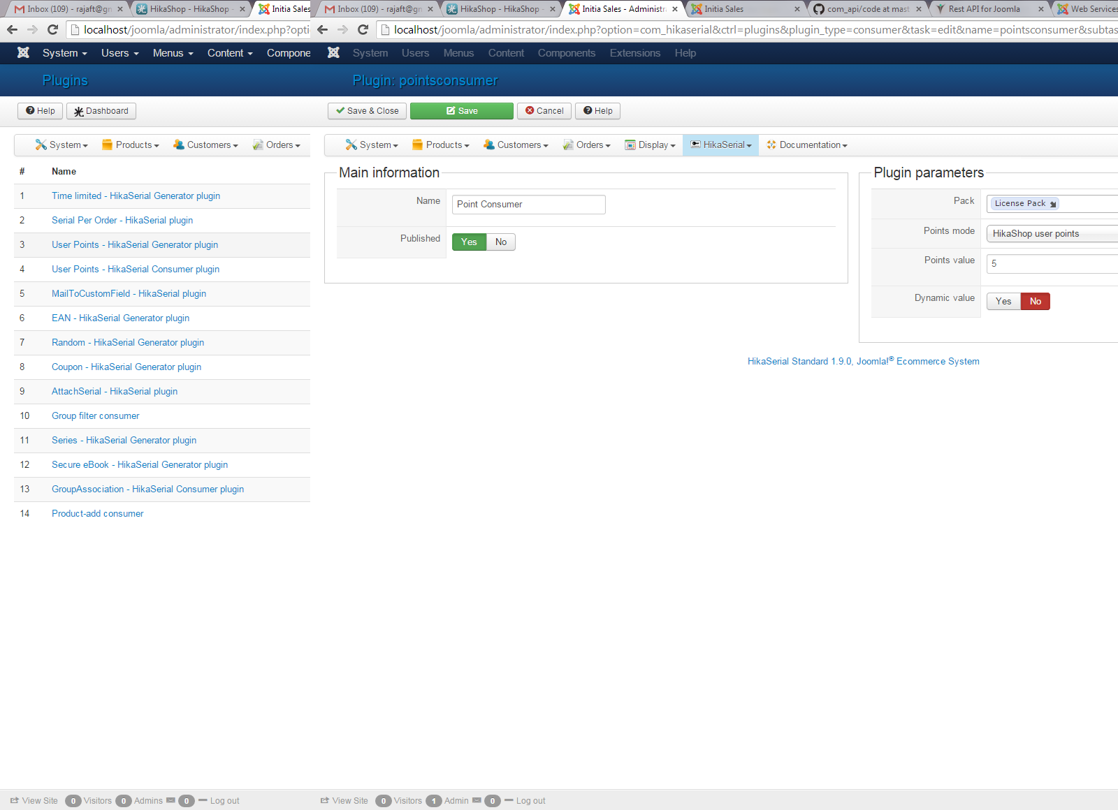

11 years 6 months ago #192780
I have attached the plugins and it shows that I have the "points consumer" activated
I also attached the configuration of the consumer
I only tried it with the administrator account for now.
The idea is to consume the serial from an outside application using the webservice:
index.php?option=com_hikaserial&ctrl=serial&task=consume&hikaserial[serial_data]=YOUR_SERIAL_DATA&hikaserial[serial_extra_data][myUser]=YOUR_USER_NAME&hikaserial[format]=json

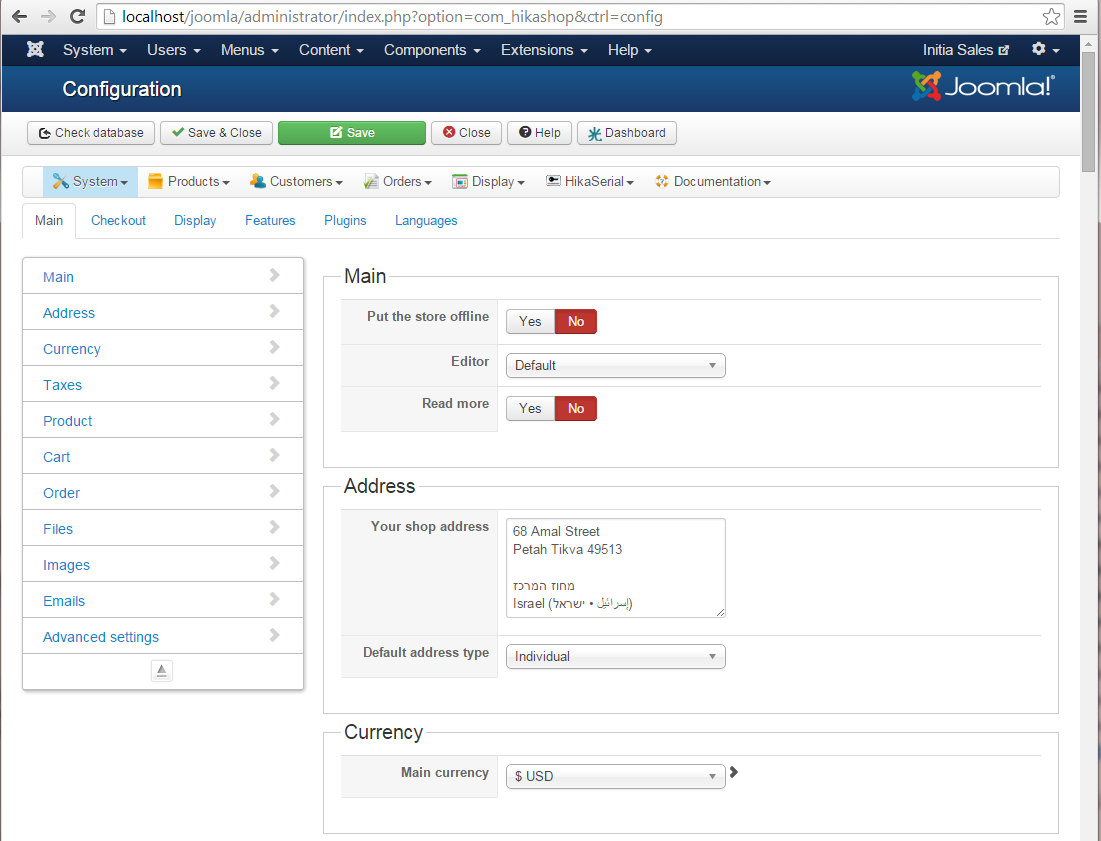

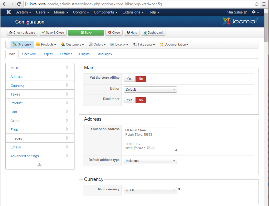

So it seems that somehow the main_currency is not defined for the above code.
I have attached the Hikashop configuration page where you can see that the main currency is indeed configured.
What am I missing?
