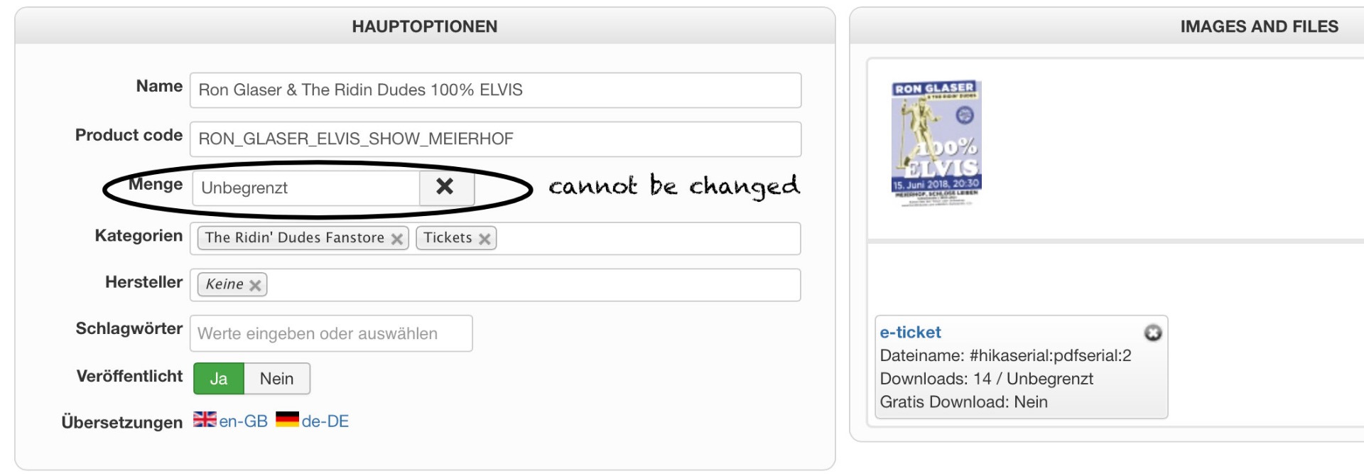

It is not possible to change the number of available Products, when a serial is attached. It's always set to endless. When i remove the serial package, it works. So are there any settings, that allow serials attached to Products, that have a limited availability?

See : www.hikashop.com/support/documentation/1...ration.html#main_adv
When you link the product quantity with serials, you do link the product quantity with the number of available serials.
And by using a serial generator (or activating a setting in the pack configuration), the number of serial can be virtually unlimited ; which make the product quantity unlimited too.
