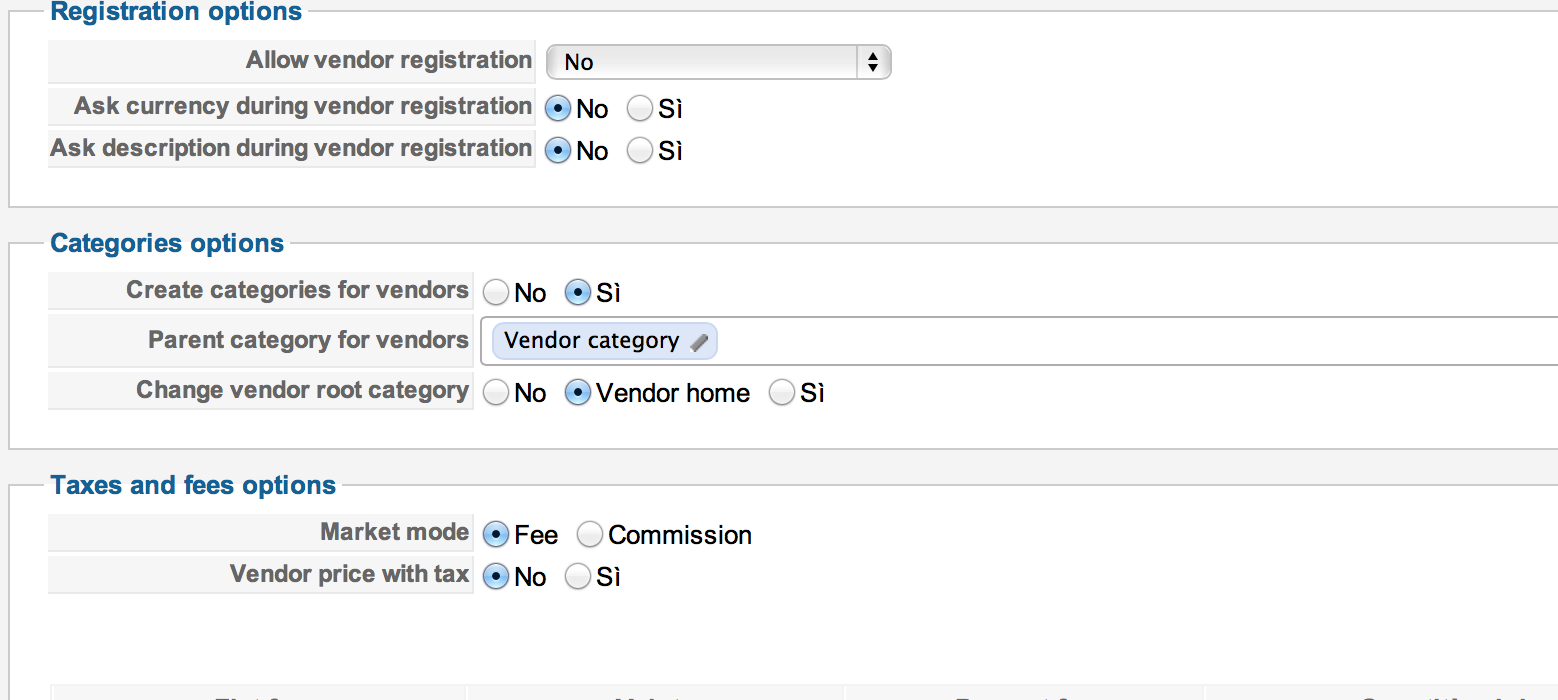

You can find the attached the configuration of HikaMarket

What do you mean with "the sub-category will not be created" ?
Do you mean the vendor category ?
Your configuration seams good.
If your vendor does not have his category, the category would be automatically created when you would update the vendor (edit the vendor in the backend and just save it without changing anything).
