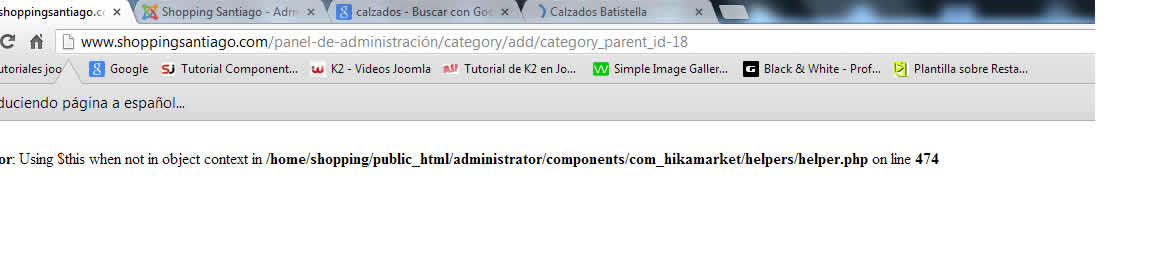

13 years 5 months ago #94468
I need that vendors can create new categories from Fornt-End but I have the following error: see attached image
I have to enable some option?
Gracias
  • Posts: 26381
13 years 5 months ago #94506
The problem is explain here:
www.hikashop.com/en/forum/19-hikamarket/...dors-list.html#94330
But I have update the HikaMarket package with the patch, so you can re-download and re-install HikaMarket to fix it.
