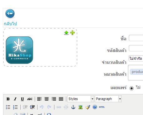

Hi Hikashop
My site www.suppasinka.com (underconstruction) allow normal user to freely become a vendor
after crate the vendor account I found the vendor can't upload
and can't use drag&drop feature. After look a round in this forum
I guest it should some kind of "javascrip error" or "jQuery"
I try to solve problem by install jQuery easy
extensions.joomla.org/extensions/core-en...jquery-scripts/18327
but after I try to customize it nothing seem to work for me:S (I'm a newbie)
This problem can be solve by change template but I don't want to do that.
It will be great if you can solve it with using current template.
Best regards

  • Posts: 22
13 years 4 months ago #99272
Thank you for you quickly reply
I already download and install
Hikashop 2.1.2
Hikamarket 1.1.3
Nothing change. After I upload picture
it display the bar code picture, the product picture is not show
www.suppasinka.com/vendor-management/product/edit/cid-6
[?] admin can add product picture but can't drag&drop
vendor cat't add product picture and can't drag&drop too.
Is it mean permission issue?
  • Posts: 26381
13 years 4 months ago #99322
I tried to upload an image with the account that I created on your website.
Now we can see that the upload library is loaded correctly. Previously the input field for the upload was not hidden.
I upload an image using drag & drop (tested with "Google Chrome" and "Mozilla Firefox") and it works good.
Which file did you upload ?
Note: The upload by drag & drop does not work with old version of Internet Explorer.
It works fine with Internet Explorer 10 but with the the version 6,7,8,9 it doesn't.
The "file drag & drop" is a HTML5 feature which has been introduce is recent browser. When IE9 came, the specifications where too young for microsoft so it wasn't implemented.
But even if the drag & drop does not work, it is possible to upload with old version of IE (using the upload icon).

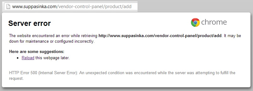

But I still got another problem after vendor upload pictures
and input product detail, after hit save bottom the browser (Chrome) said
Server error
The website encountered an error while retrieving www.suppasinka.com/vendor-control-panel/product/add . It may be down for maintenance or configured incorrectly.
Here are some suggestions:
Reload this webpage later.
HTTP Error 500 (Internal Server Error): An unexpected condition was encountered while the server was attempting to fulfill the request.
Error appear but product can be created successfully
I want to get rid of the Error page, any advise please.
  • Posts: 26381
13 years 4 months ago #99350
I can't reproduce your problem in our local websites on in the demo website.
Could you activate the Joomla debug mode ? It would thrown exception messages instead of returning a "500 error page".
At this moment, we would know the source of the error and we would be able to fix it.

  • Posts: 22
13 years 4 months ago #99367
After vendor add product by save the result is
Notice: Undefined property: stdClass::$mailer in /home/thaimicr/domains/suppasinka.com/public_html/administrator/components/com_hikamarket/classes/product.php on line 264 Fatal error: Call to a member function addReplyTo() on a non-object in /home/thaimicr/domains/suppasinka.com/public_html/administrator/components/com_hikamarket/classes/product.php on line 264
  • Posts: 26381
13 years 4 months ago #99383
Thanks !
We fix the problem on the HikaMarket package.
Please re-download HikaMarket and sorry for the inconvenient.
The following user(s) said Thank You: suppasinka.com
