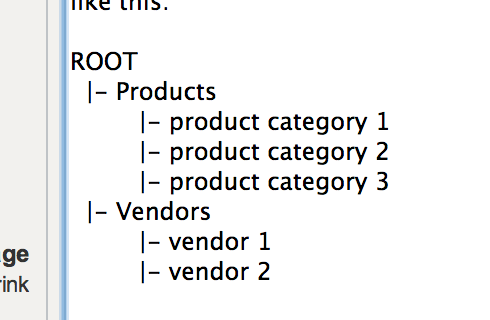

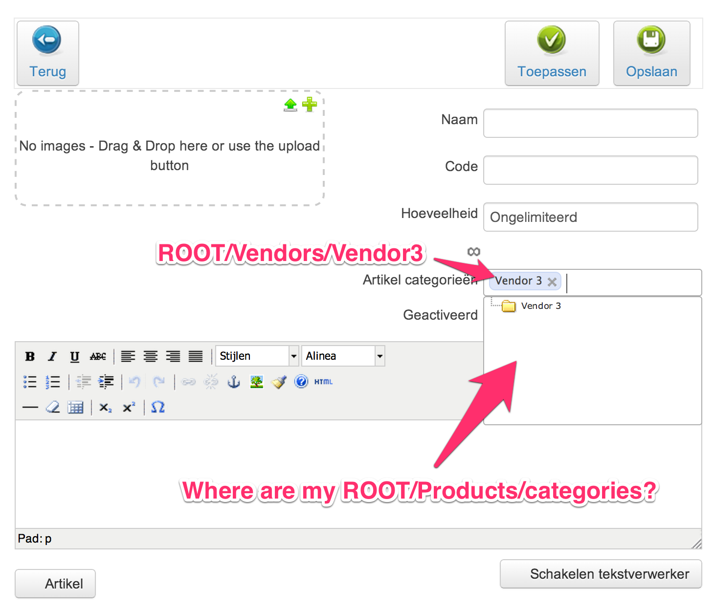

I have a few questions regarding HikaMarket and assigning products to different categories. My category structure is pretty simple and straight forward. Looks like this:
ROOT
|- Products
|- product category 1
|- product category 2
|- product category 3
|- Vendors
|- vendor 1
|- vendor 2
The vendors default root category is set to ROOT/Vendors. And as a result of that, it's not possible to assign a product (from frontend) to ROOT/Products/product category 2. However, both vendors 1 and 2 (and others) should be able to publish products in ROOT/Products/product category 2 (so it's not an option to create a structure like ROOT/Vendors/vendor x/product category 1 etc.).
Q1: How can I get this category structure work for me?
Q2: Is it possible to 'protect' the vendors default root category so a vendor can't remove this category from a product?
Thanks in advance for thinking along.
Best, Jelger
Last edit: 12 years 5 months ago by praes. Reason: Indent spaces were removed, see attachted screen dump

  • Posts: 44
12 years 5 months ago #109004
Hi Jerome,
Thanks for your reply.
Just saw that the indentation was removed from the category structure in my first post. Have attached a screen dump to illustrate the story.

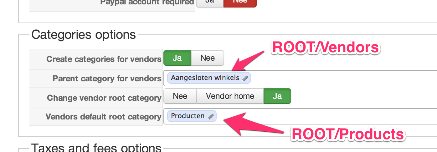

  • Posts: 44
12 years 5 months ago #109060
Hi Jerome,
Yes, it's quite important to have products always in ROOT/Vendors/VendorX. I do not have strong preferences for either a core solution or plugin.
Then your first answer:
www.hikashop.com/en/hikashop/164-hikamar...html#tuto_first_conf
Create category for vendors: Yes
Parent category for vendors: Root/Vendors
Change vendor root category : Yes
Vendor root category: Root/Products
Have exactly configured HikaMarket like that. See attachted screen dump 1. However, I can't select categories from ROOT/Products. Only ROOT/Vendors/VendorX is available (see attachted screen dump 2. Have I forgotten something? Categories are published etc.
Best regards

12 years 5 months ago #109084
When you use this option to change the root category, you can override it per vendor.
Please check the configuration of "Vendor 3" in order to see what is his root category.
I test it in my local website but I can't reproduce it.
  • Posts: 44
12 years 5 months ago #109096
Thanks, I got this part working. Have overridden the default root category. But it also raises a new issue: the relationship with the vendor category is lost.
So I have now a product (which belongs to Vendor 3) assigned to ROOT/Products/product category 2. That's ok. However, due to the override setting, it's not longer possible to link the product to it's very own vendor. Right? And as a result of that, I can't create a page containing all the vendors products. That's not so good... In fact, it's a weird situation for a webshop. Maybe I'm overlooking something again? HikaShop seems very powerful to me but a little complex to configure...
Sorry for all my questions, but I have to know whether or not I can use this category structure. It's fundamental to my project.
Best regards

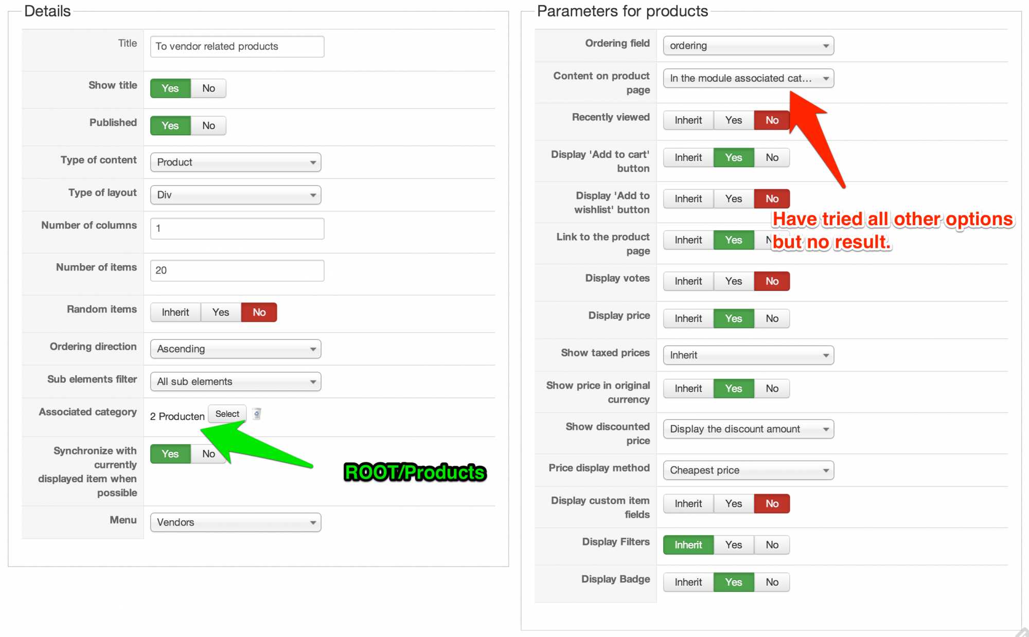

  • Posts: 44
12 years 5 months ago #109150
Yes. That's why it requires a little plugin which will assign automatically the product to the vendor category.
At this moment, the vendor will not require to set his category.
Can we expect such a plugin shortly?
Your other solution doesn't work for me. Have followed the steps but no cigar...
Best regards
  • Posts: 26291
  • Thank you received: 4047
12 years 5 months ago #109200
Is it possible to have a screenshot of your module configuration ?
  • Posts: 44
12 years 5 months ago #109234
See attached screen dump.
However, I don't think this will bring a functional solution. My vendors are stored in ROOT/Vendors. Listing these vendors can simply be achieved via a menu-item type HikaShop category (pointing to ROOT/Vendors). After clicking that very menu-item, all vendors are listed. The user will then see an empty module or a module populated with all products, I guess? (Because there's no current vendor.) Both is not the intention. I need a natural click-trough.
I think the plugin you mentioned earlier will provide the solution I need. Honestly, I'm a little surprised that this functionality is not already standard.
Best regards

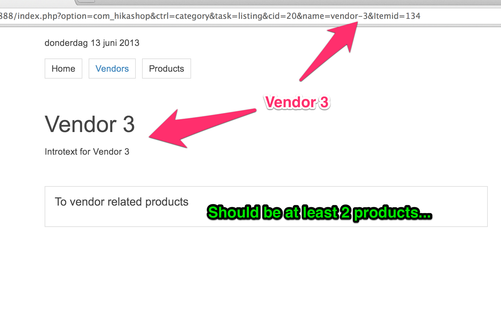

  • Posts: 26291
12 years 5 months ago #109245
I have the same configuration in my local website (Joomla 3) and I see the products in the vendor page.
Is it possible to have an access to your site so I will be able to check your configuration and see what's wrong.
Maybe there is something I missed, maybe something not supported in HikaMarket in your specific configuration. I have to investigate directly in your website because, in my local website, it works and I have the same module configuration options.
  • Posts: 44
12 years 5 months ago #109252
Unfortunately, the site is running on a local MAMP environment. Have to move it then and that will take some time. I will DM you the credentials if ready. Thanks.
Best regards
  • Posts: 44
12 years 5 months ago #109259
Have moved the site to our demoserver. Will DM you the info within a few seconds.
  • Posts: 26291
12 years 5 months ago #109302
I understand better the problem.
You made a category listing, so the page is not the vendor page but a category page.
At this moment, because the products are not assigned to the vendor category (because the little plugin is not implemented), the products are not found : The category is empty.
If we assign the products to the vendor category, the listing is good.
Personally, I was talking about the vendor page which override the associated modules in order to filter the products depending the selected vendor.
But the category page is not the vendor page, that's why HikaMarket does not add his filter.
If you open the page: /index.php?option=com_hikamarket&ctrl=vendor&task=show&cid=4
You will see the result that I have in my local website.
After that, I assigned the products, so the category page now display some elements: /index.php?option=com_hikashop&ctrl=category&task=listing&cid=20&name=vendor-3&Itemid=134
With the little plugin, the category listing should work like that.
I will see to implement it.
Last edit: 12 years 5 months ago by Jerome.
