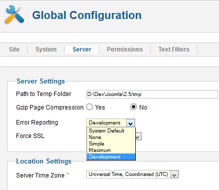

  • Posts: 85721
  • Thank you received: 14051
12 years 11 months ago #110571
If you activate the Joomla debug mode and the error reporting options of the joomla configuration and try again you should see the errors.

  • Posts: 26355
  • Thank you received: 4068
12 years 11 months ago #110588
As Nicolas said, you have to set the error reporting too.
Otherwise, you will have to read the PHP error log in your web hosting.
  • Posts: 32
12 years 11 months ago #110591
I´m sorry i was enabling system > debug system :blush:
Now it´s like your picture

  • Posts: 26355
12 years 11 months ago #110757
You can try to use a lesser error reporting level like "Maximum" or "Simple".
The Strict Standards notices you have are not in HikaShop so we can't fix it in our packages.
You have to activate the error reporting only if you are in a debug process.
When the debug process is finished, you have to remove the error reporting, so the website won't display the PHP notices. It is highly recommended for production.
