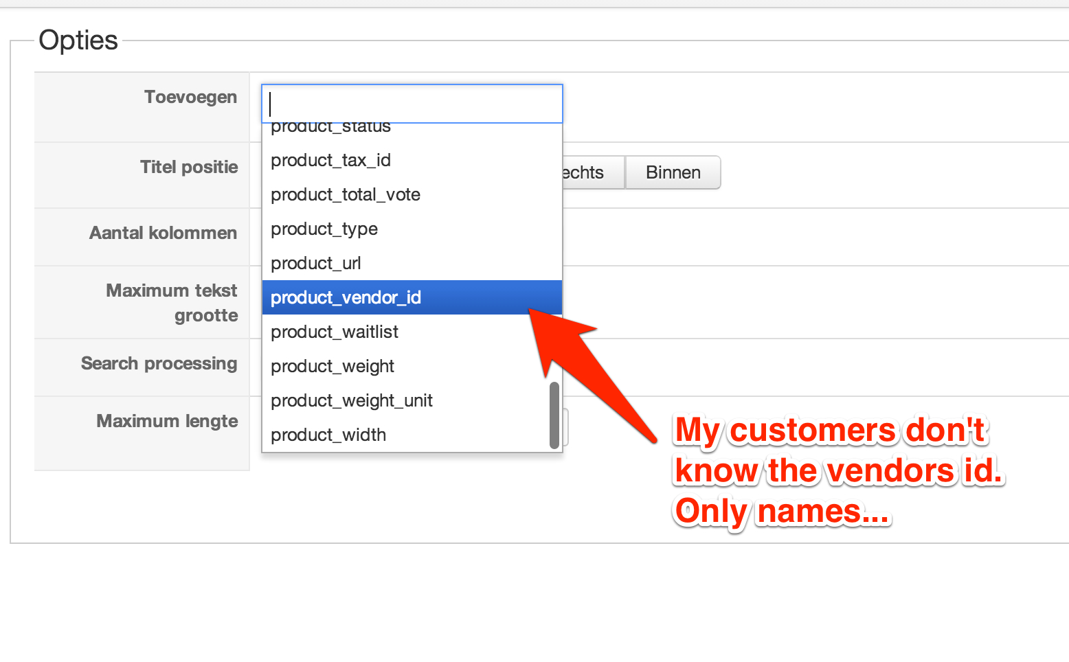

Have a question regarding the filter functions. I'd like to build a filter which allows my customers to filter on the vendors name (instead of the vendors id). As far as I can see it's only possible to add the vendors id to the filter options. That's not so user friendly.
Is there a way to add the vendors name to the option list?

If you want a text search box, it is easily possible.
The idea is to update HikaMarket to modify the filter search when you use a filter on the "product_vendor_id".
You have to edit the file "plugins/hikashop/hikamarket/hikamarket.php" and replace the code:
		$ON_c .= ' LEFT JOIN ' . hikamarket::table('vendor').' AS hikam_vendor ON product_vendor_id = hikam_vendor.vendor_id ';
		$filters[] = '(hikam_vendor.vendor_published IS NULL OR hikam_vendor.vendor_published = 1)';
By:
		foreach($filters as &$filter) {
			if(strpos($filter, 'b.product_vendor_id LIKE \'%') !== false) {
				$filter = str_replace('b.product_vendor_id LIKE', 'hikam_vendor.vendor_name LIKE', $filter);
			unset($filter);
And the filters on the "product_vendor_id" will search on the "vendor_name" with text searchs.
We will see to improve the filter integration with new features in the next release ; But the current patch works good and will be integrated in the next package.
