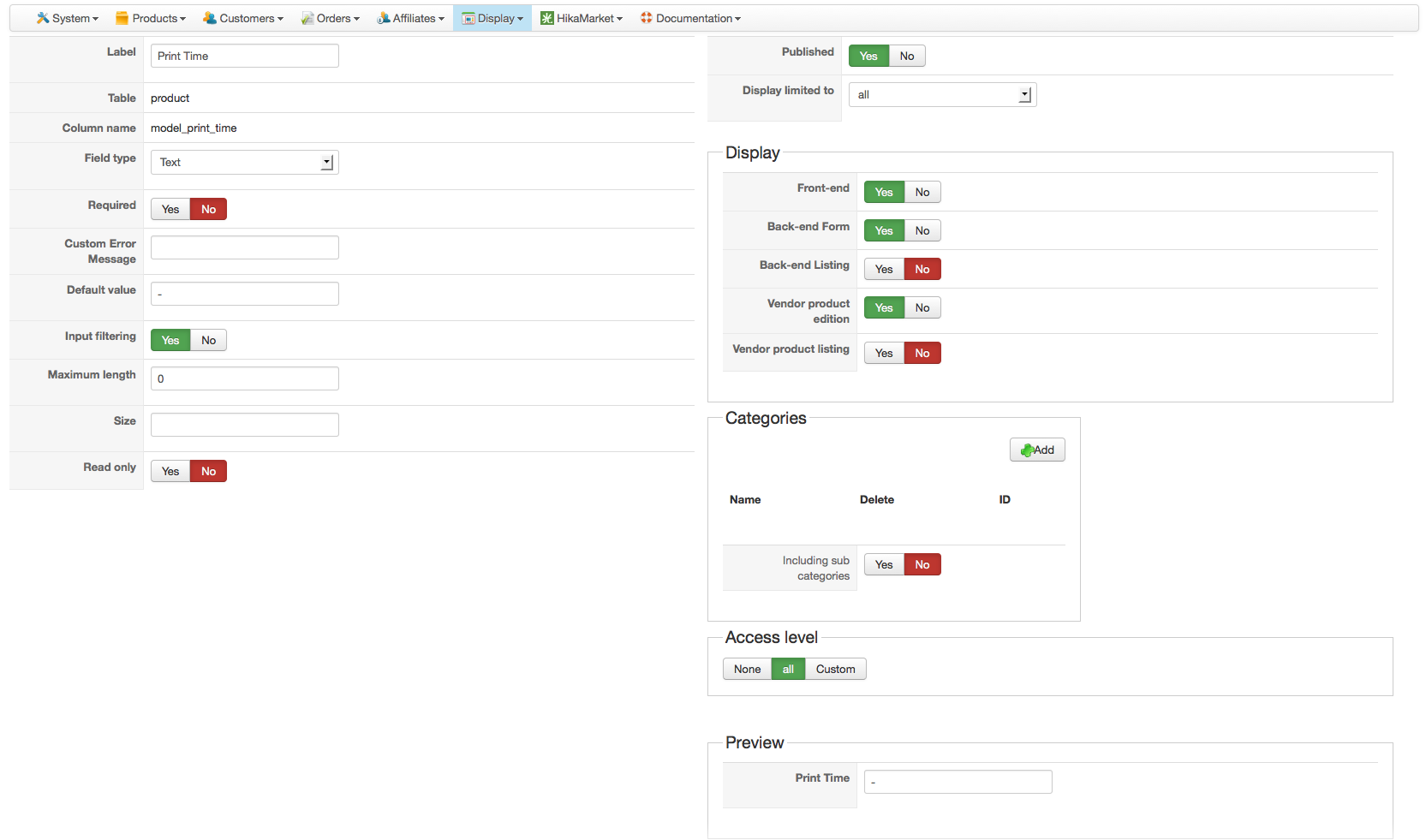

Can you send me a screenshot of your custom field configuration (the one which give you the problem).
I want to be sure that I have the same configuration on my side and the problem is right solve using the latest versions.

12 years 10 months ago #128340
Hi Jerome, I will look at upgrading.
I actually wasn't aware that there was a more current version. Guess I should pay more attention :D
The settings are below, the only difference is that now I have the setting Display-> Front End set to yes instead of no.
