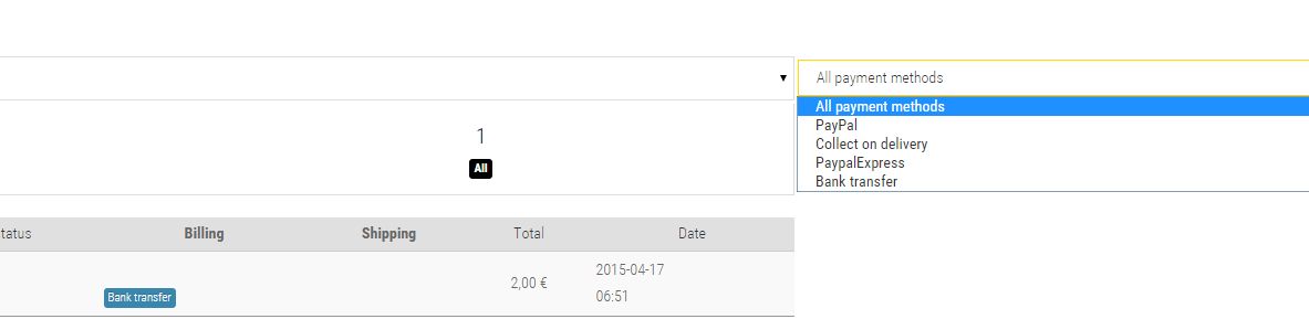

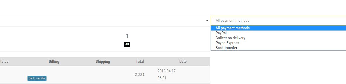

1. the filter for the payment methods is shifted to the right (see attached image)

1. I can't reproduce your issue in my local websites or in the demo website.
I think you just have an internal display issue regarding the width of your listing and the width of your dropdowns.
