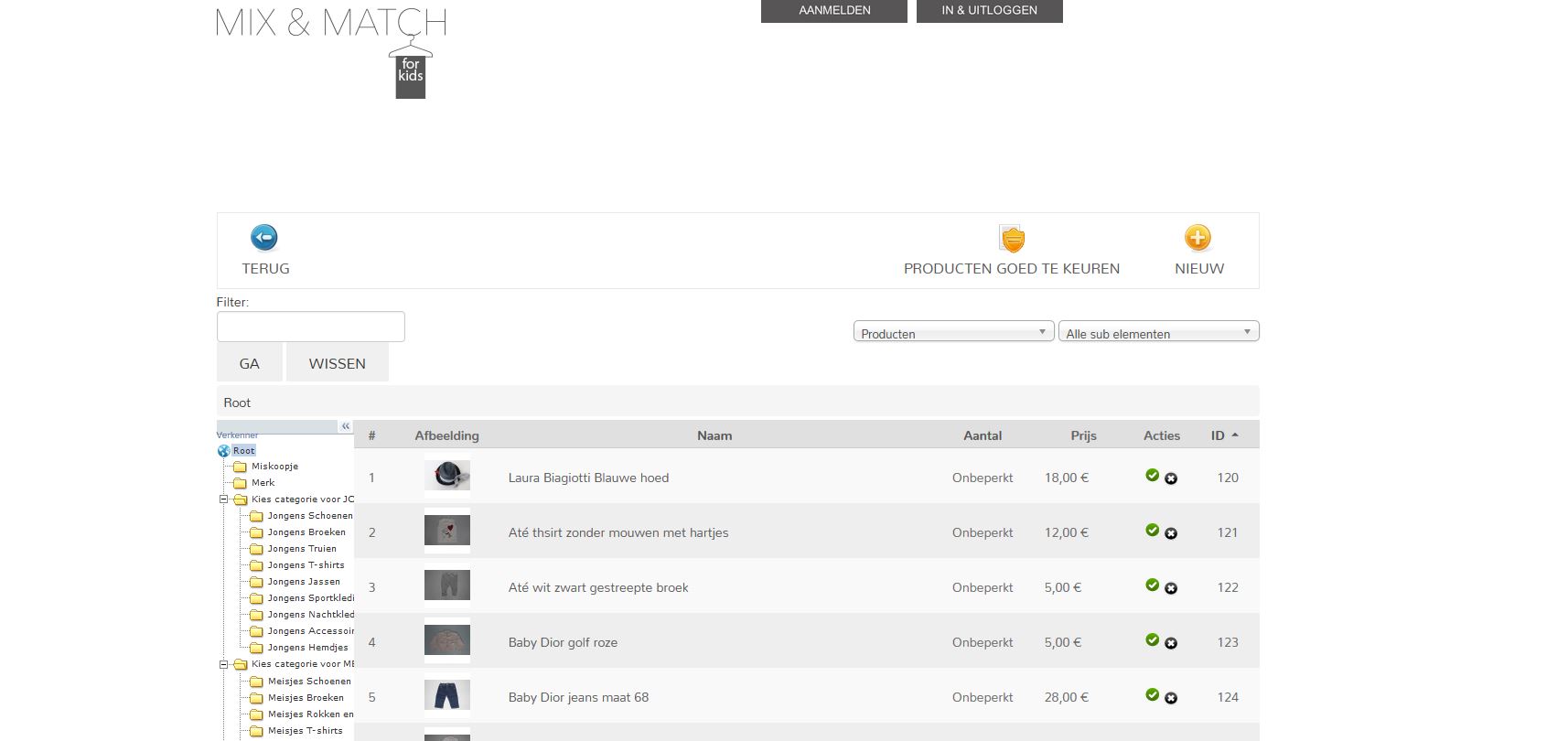

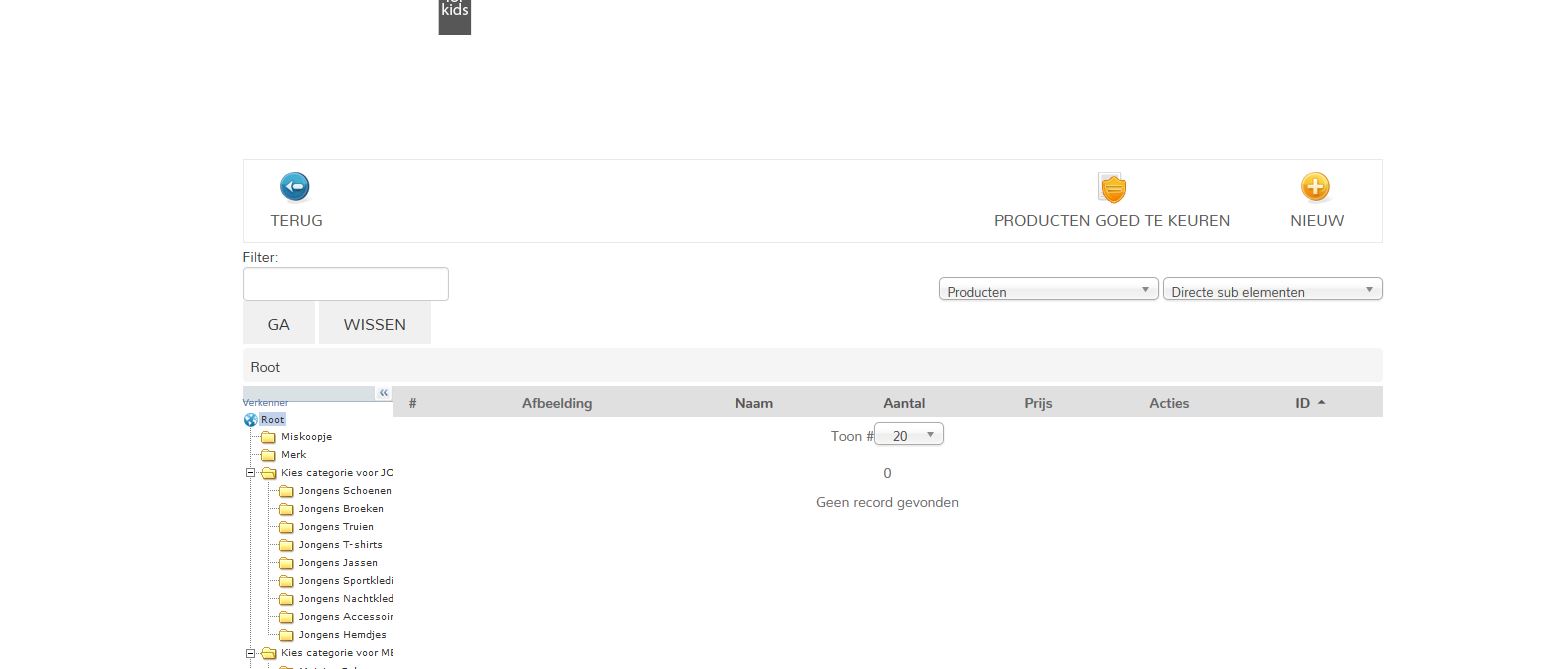

vendor frontend show "all sub elements"
  • Posts: 10
10 years 8 months ago #224242
-- url of the page with the problem -- : www.mixandmatchforkids.be/
-- HikaMarket version -- : 1.6.7
-- Joomla version -- : 3.4.6
-- PHP version -- : 5.5.30
I would like "all sub elements" have as standard rather than "direct sub elements". See pictures. Where can I change that?
