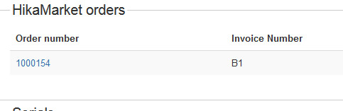

First shortly what happens now when vendor sells is that three (3) Invoices are generated:
1. Invoice from shop to Customer (that should not be present)
2. Invoice from Vendor to Customer - OK
3. Invoice from shop to Vendor (when generated) - Wrong Number
Here in details:

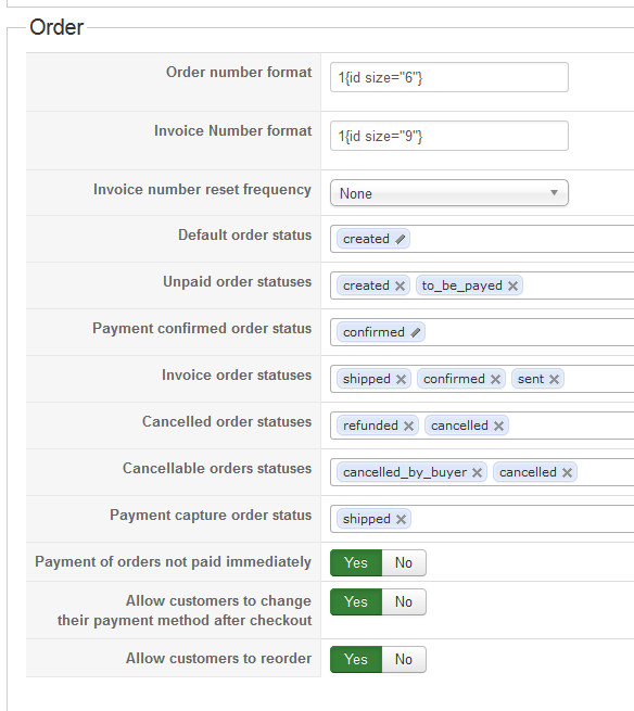

I've set Numbering format in HS according to our legislation rule (and as I know not only ours).
It says that Invoice number should be formated as consecutive numbers without gaps.
When shop sells everithing is OK and our (looking in HS->Orders) Invoice format is correct ... until vendor sells something and p.1 happens.
I think that two things should be changed:
1. No Invoice should be generated in HS when vendors sells (as shop don't sell here and this breaks the no gap consecutive number rule)
2. Invoice from shop to vendor should take the next number according to rule format (again this rule). And now totaly different number is assigned (C2)

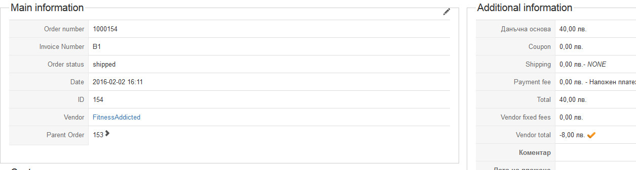

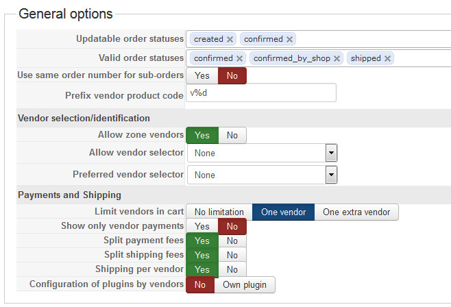

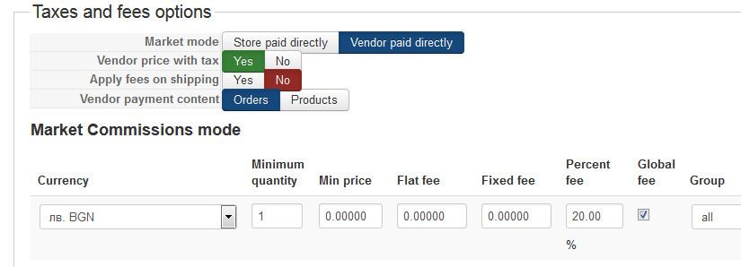

I've put some configuration screenshots also.
There is a link to the other threat which became too big , but I think deltafidesign explains the same issue
Regards!

The market mode (commission mode) "Vendor paid directly" is a mode of processing the commission, the fees.
You indicate in which way the fees should be process between your marketplace and your vendors.
Everything else in your HikaMarket configuration will really define if the vendor is paid directly or not.

1 - To limit your vendors in the cart ; so the transaction will be only between the customer and one single and unique vendor.
2.1 - To display only the vendor payment methods.
2.2 - OR to use "paypal adaptive" in "classical" mode so the plugin will use dynamically the vendor paypal email.

10 years 6 months ago #229083
Hi Jerome,
filiar wrote: First shortly what happens now when vendor sells is that three (3) Invoices are generated:
Ok, from the top

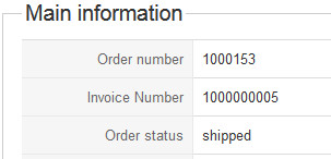

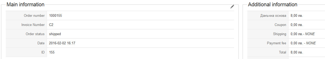

1. You fixed that
2. Ok (I never said it has not been)
3. This is when you press "Generate Invoice" for the vendor fee/commision. Invoice is being generated in HS. This is absolutely correct, because we charge vendor commission fee. The only thing is that the number here does not follow the consecutive rule.
In other words. How to set numbering format for Vendor fee invoices?

  • Posts: 134
  • Thank you received: 6
10 years 6 months ago #229208
Hi, Jerome.
I really am starting to think there should be some problem in my explanations.
If there is such please tell me.
As I said I've set the format. I also applied screenshot of the settings!
filiar wrote: I've set Numbering format in HS according to our legislation rule (and as I know not only ours).
filiar wrote: I've put some configuration screenshots also.
There is a screenshot from the first post:
If customer buy something from the shop (not from vendor) the right Invoice number is generated!
filiar wrote: When shop sells everithing is OK and our (looking in HS->Orders) Invoice format is correct
When we generate commission invoice this format is broken.
filiar wrote: 2. Invoice from shop to vendor should take the next number according to rule format (again this rule). And now totaly different number is assigned (C2)
Shop - To - Vendor WRONG NUMBER
This screenshot is from HS. This is the invoice that we give vendor about the commission. The invoice should follow our format because we are the biller and vendor is the recipient. But that format is broken.
If I don't explain something or if you need additional screenshots, or if you need acces, please tell me. Because there should be some reason that you can not get the issue.
Regards!
Last edit: 10 years 6 months ago by filiar.

Market mode : vendors paid directly.
In the backend, we generate the vendor invoice for our commissions.
While HikaShop is configured with the invoice format " 1{id size="9"} ", the invoice number of that invoice is " C2 ".
