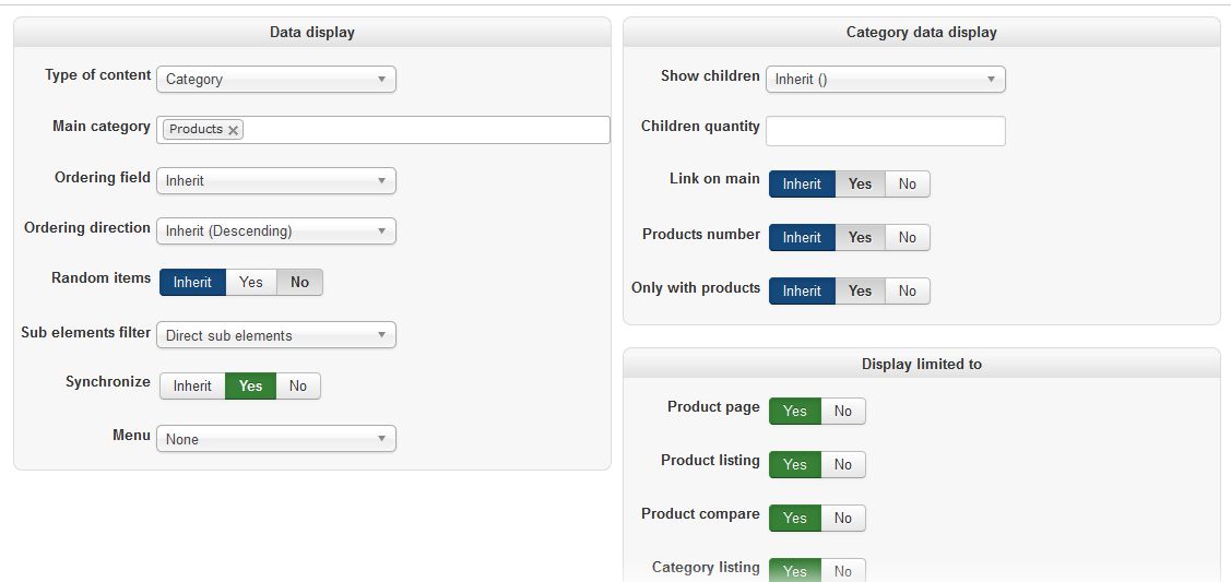

I have added a HikaShop Content Module to be displayed in the vendor page. In that module I would like to display the product categories of each vendor, so that a visitor can browse each vendor's products beginning with their categories.
The module is configured as shown in the following image:
The product categories appear under each vendor's page, however when a user clicks to view the contents of any category, no product is shown. Products are counted and displayed in the parenthesis for each category.

9 years 3 months ago #244174
You are using a category listing module.
That module is synchronize with the current page ; so it will be synchronize with the current vendor.
But when you click on a link, you will stay in the same page ; on the same vendor page where you have the same modules (a category listing module).
So in your vendor page, you do not display any product ; that's why you cannot see any product.
But if you put a product listing module with the "synchronize", it will be synchronize with the vendor, not with the category listing module displayed in the same page. A module can just be synchronize with the menu and not the other modules.
So in your category listing module, you have to use another "menu" in your configuration, so the link will point to a category listing menu where you will also have a product listing (included with the category listing menu, no need extra module).
All that part is not related with HikaMarket ; it is only HikaShop module (and menus), in that case HikaMarket is just a special context because you have a menu which is not a category or product listing.

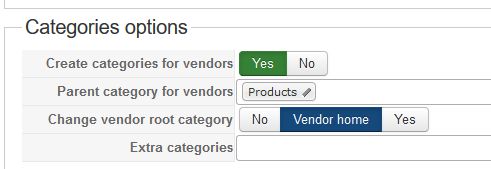

Hello again, since it is necessary for us to be able to display vendor products from vendor categories in the vendor page, I tried a different approach.
I now have separate categories for each vendor.I followed the instructions and applied the following:
Under the category [products] I have a category for each vendor and under that category are the various vendor product subcategories. Something like:
