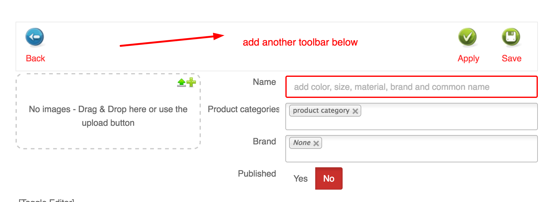

hi
how do i add another tool bar below HikaMarket - productmarket / form.php
thanks
  • Posts: 26385
  • Thank you received: 4077
9 years 10 months ago #255010
If you want to add item in the current toolbar, you need to use a custom plugin or an override of the HikaMarket toolbar (view: toolbar / default).
Please note that the toolbar view is used almost everywhere in the front-end so you'll need to perform some context checks to add you elements just in the targeted page.
If you want to add a second toolbar in the view, you just need to put it at the beginning of "productmarket / form".
  • Posts: 490
9 years 10 months ago #255058
hi
thanks
i just want to add a second toolbar below. This will prevent users from scrolling all the way up.
Can you tell me what the exact code to add to HikaMarket - productmarket / form.php.
i tried to add this below so i would have a toolbar above and below the form but i get an error
full content of the view "toolbar / default" removed.
content irrelevant here ; specially if it is the full untouched code of an official view
thanks
Last edit: 9 years 10 months ago by Jerome. Reason: removing irrelevant code
  • Posts: 26385
9 years 10 months ago #255064
If you just want to duplicate the toolbar, the best would be to just include the view :
$toolbarHelper = hikamarket::get('helper.toolbar');
$toolbarHelper->process($this->toolbar);
