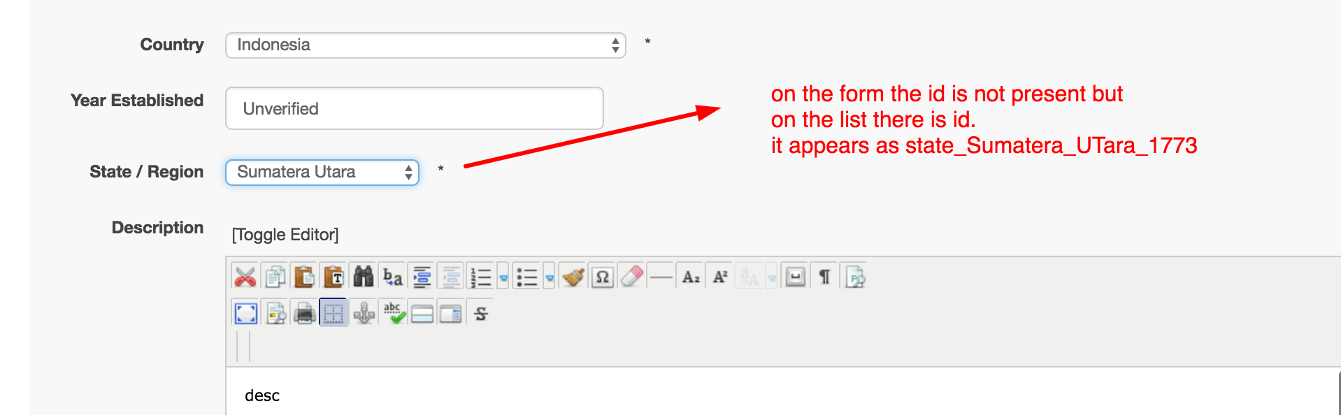

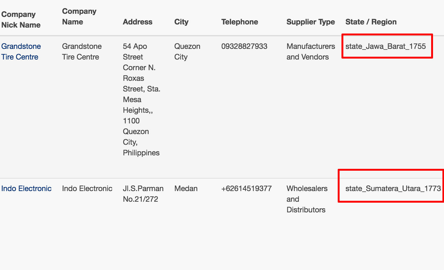

9 years 11 months ago - 9 years 11 months ago #256575 by ronron
Replied by ronron on topic state format issue
hi jerome
please see the screen shot.
the state has the id on it
the correct one should say
JAwa Barat and Sumatera Utara.
these are states in indonesia
you can also see the form which displays the correct one.
howt to correct this?
