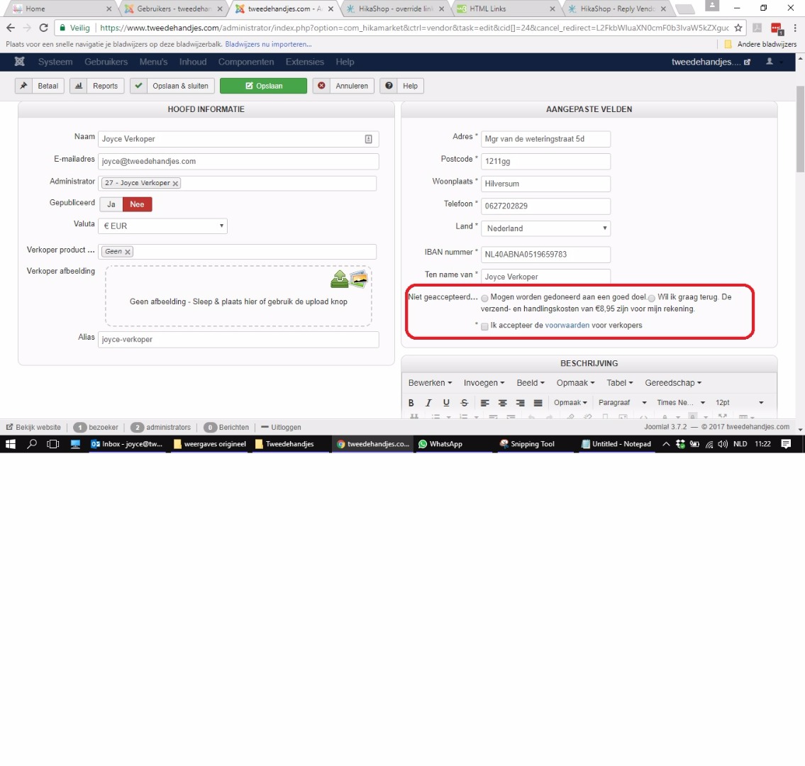

Could you please help me with the following issue:
When a vendor registers on my site, the registration is duplicated in the backend:
one registration has status "published" but misses some information the vendor entered in the front end (see attached)
the other registration has status "unpublished" but contains all information the vendor entered.

Still I have the "missing information" issue. Please see attached a new file saved as .JPG
As you can see, the information with the red border did not flow to the backend.
As the field are mandatory, I'm 100% sure I have completed them.
Can you see what is the issue?

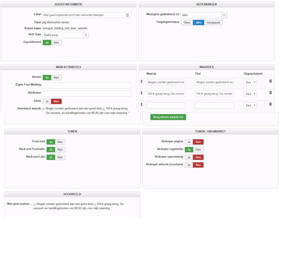

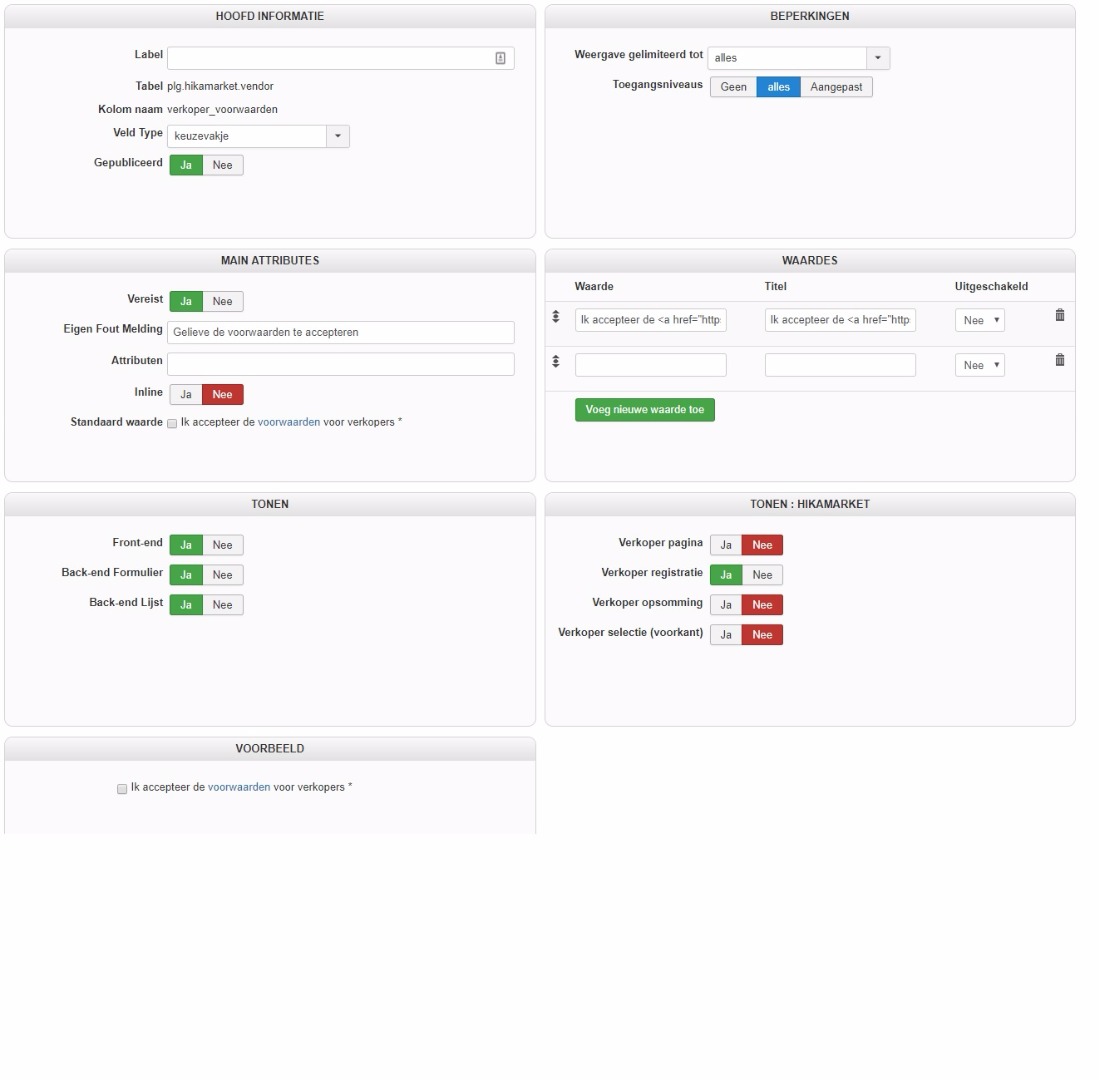

Please see attached the configuration of the custom fields involved.

9 years 3 months ago #271295
When you create/configure a custom field ; please provide a content which will be a "value" for the "value" part of the field.
You're free to enter what you want for the title ; but for the value it's best to use short content, namekeys.. Or numbers !
But using content with double quotes and HTML as "value" ; I'm afraid that's not a really good solution.
