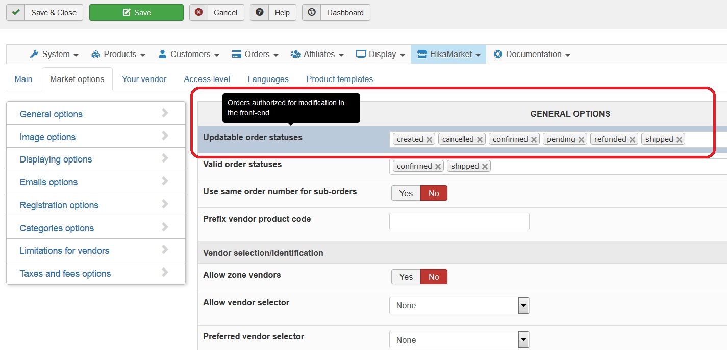

I am assuming that it is possible to manage vendor's order statuses based on the settings in HikaMarket. as seen on the attached screenshot.

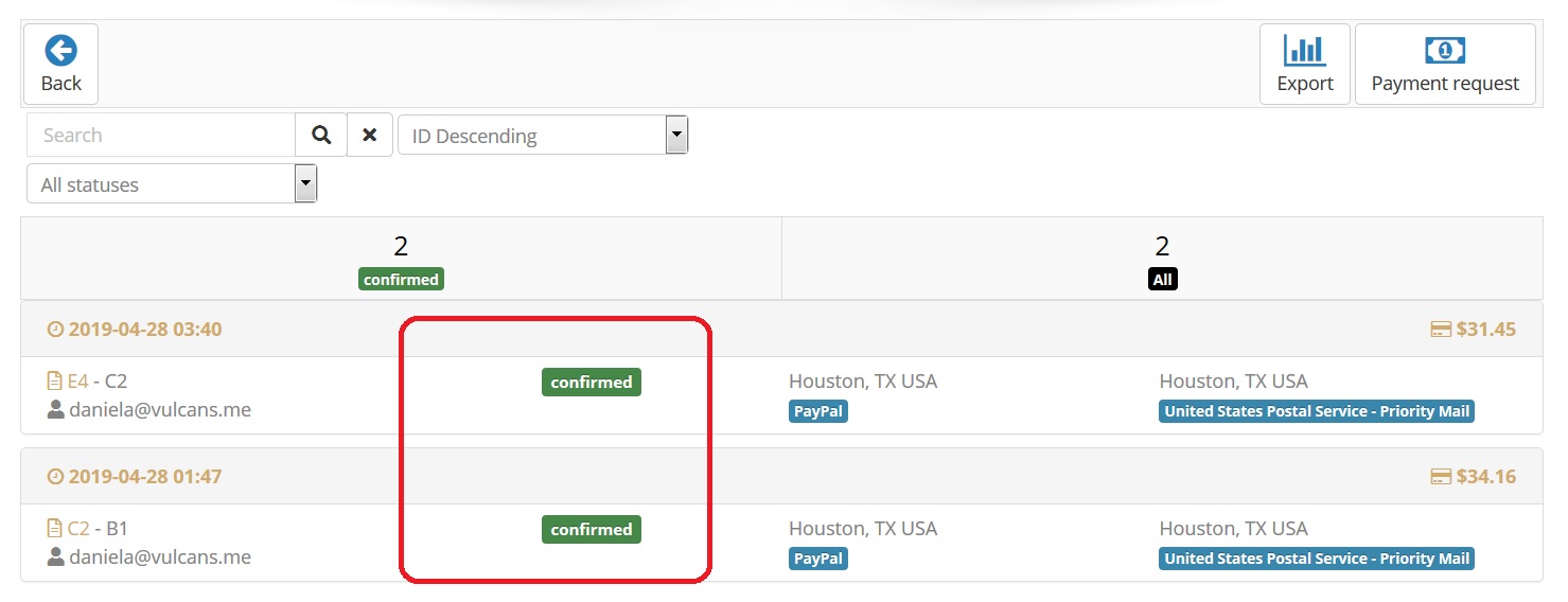

These statuses are not manageable in vendors orders as seen on the attached screenshot. Am I missing something?

The vendor do require the ACL to edit an order if he want to change the order status.
You can limit the order edition to the order status if you want ; but he will need at least that ACL if he want to have the button in the toolbar while displaying the order details in the front-end.
Compared to HikaShop backend, HikaMarket do not let the order status be modified in the order listing, because the vendor do not see the details of the order and the workflow used by HikaShop do not let some plugins to work properly.
