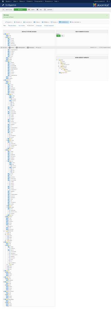

  • Posts: 1181
  • Thank you received: 13
6 years 10 months ago #310648
  • Posts: 26369
  • Thank you received: 4070
6 years 10 months ago #310682
Your screenshot is to small to be able to read your ACL configuration ; but I suppose that you wanted to show me that you remove the category/edit/published ACL.
