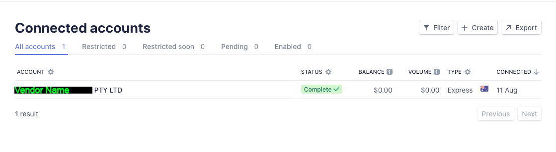

We setup Stripe Connect as you described. We are using the Stripe credentials from our main account, and we connected the vendor's stripe account to that. We processed a vendor's product through, and the amount showed up in our main Stripe account. However, nothing yet appears in the Vendor's account.

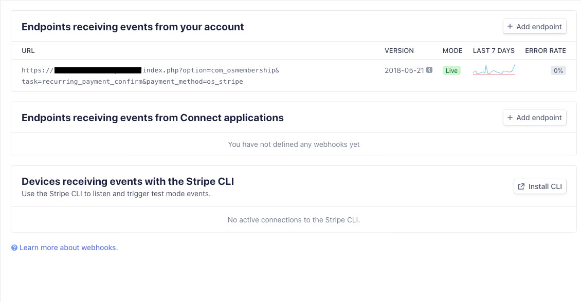

1. It looks like we need some Endpoint (web hook) code & associated events to link it to from you, so we can specify a clearer communication connection between our Stripe account and the website - can you please provide this. It seems to be missing, and I have no idea what to set it to in Stripe so it can properly communicate with your Stripe Connect plugin software. (For example, We were given endpoint-webhook code & the events to connect it with for Stripe when we setup our Membership Pro account from joomdonation, and that works well. ) - see screen shot.
2. On the Stripe Connect plugin's Specific Configuration, when we set the Preferred Charge mode to Destination, then we succeeded in processing a transaction, so it completes successfully and appears in our Stripe account. (however the vendor does not get any share of that.)

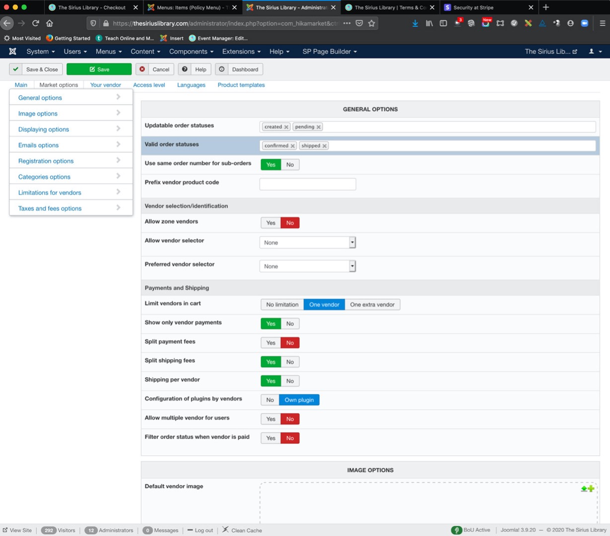

3. We are still seeing payment methods in the shopping cart that have nothing to do with the vendor (PayPal and Eway). When a customer checkouts with a vendor product, we should only be seeing Stripe Connect in the checkout cart as a payment method. I have "Show Only Vendor Payments" set to Yes in the General Options page of the HikaMarket setup. (see screenshot.). Please advise.

1 - The webhook is not a requirement for Stripe process.
But I suppose that if you do have a webhook configured, it can have some unwanted side effects.
Webhook can be include in a future release but it is not a small development.

3 - You need to assign the payment methods which are not related with vendors to your "main vendor".
Payment methods without a vendor assignation could be displayed to every vendors ; except if you enable the setting "show only vendor payments".
But a payment method assigned to the "main vendor" will be displayed only when the products are related to the main vendor.
