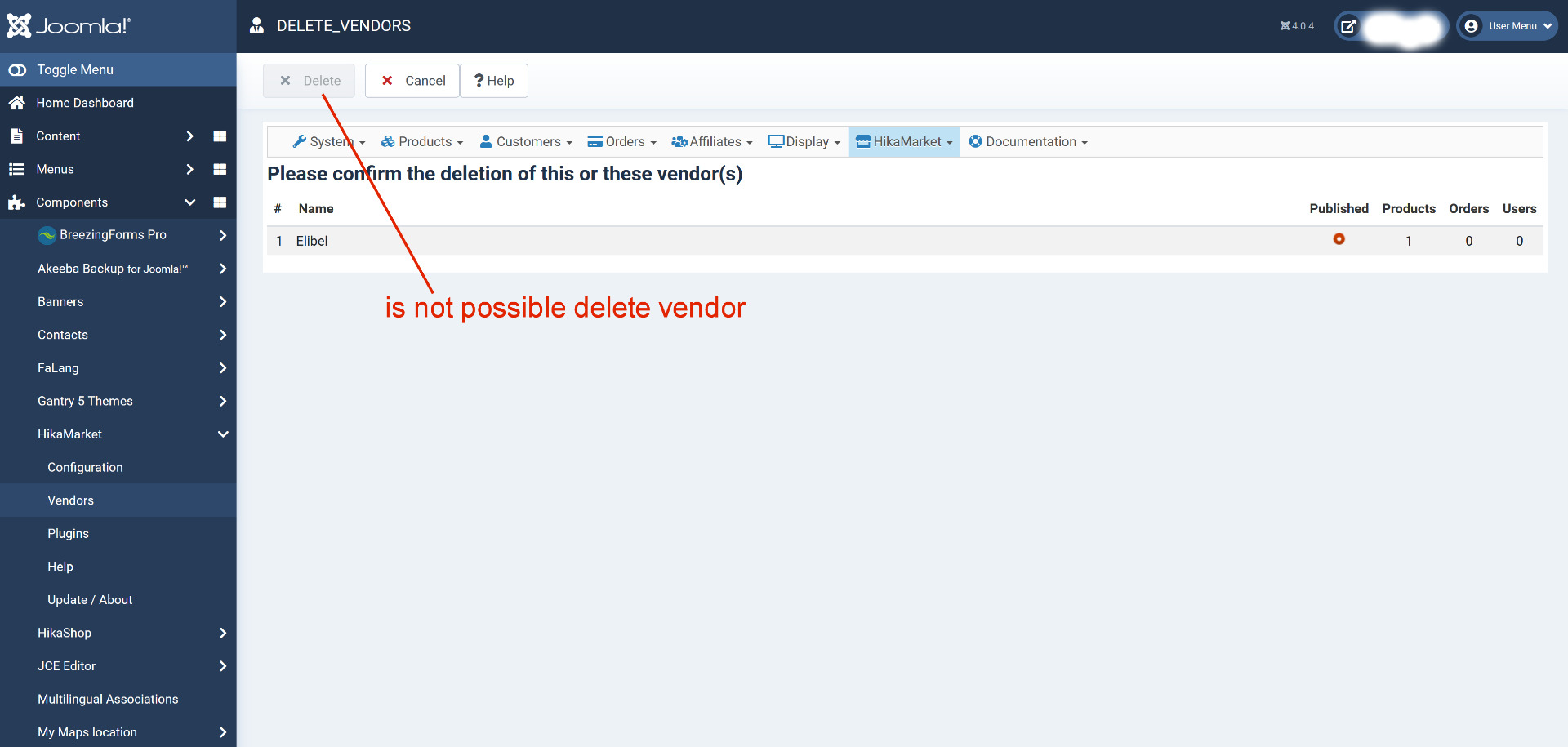

I update my website in joomla 4 (I test this in localhost)
I have a problem, is not possible delete vendor
check my screenshot
Thank you
Bye

  • Posts: 64
4 years 10 months ago #336815
I tried to do what you asked me, it is not possible to delete the seller.
it is not possible to click, the delete button.
this problem I have it only in joomla 4
I am testing joomla version 4 of my site on xampp locally
The same site with joomla 3.10 everything works fine
I also did a manual package update before hikashop and then hikamarket
This problem is not urgent to solve.. when you have time, try a j3 to j4 upgrade and check delete vendor

4 years 10 months ago #336841
Thank you for your feedback.
Regarding the issue description, it looks like Joomla 4 doesn't know how to handle a form with pre-check fields.
To fix the issue, you can edit the backend view "views/vendormarket/tmpl/delete.php" and replace
</form>
By
</form>
<?php
$doc = JFactory::getDocument();
$doc->addScriptDeclaration('window.hikashop.ready(function(){Joomla.isChecked(true);});');
And the Joomla 4 "Delete" toolbar button will be enabled.
Regarding the Joomla 4 bug details.
It's in the "joomla-toolbar-button" javascript file :
github.com/joomla/joomla-cms/blob/4.0-de...utton.w-c.es6.js#L49
By default, the button is set-up disabled
    if (this.listSelection) {
      this.setDisabled(true);
When it register to check the modification of the field value
this.formElement.boxchecked.addEventListener('change', this.onChange);
It should also read the current "boxchecked" value in order to set the "disabled" state, like it's doing in the "onChange" function.
