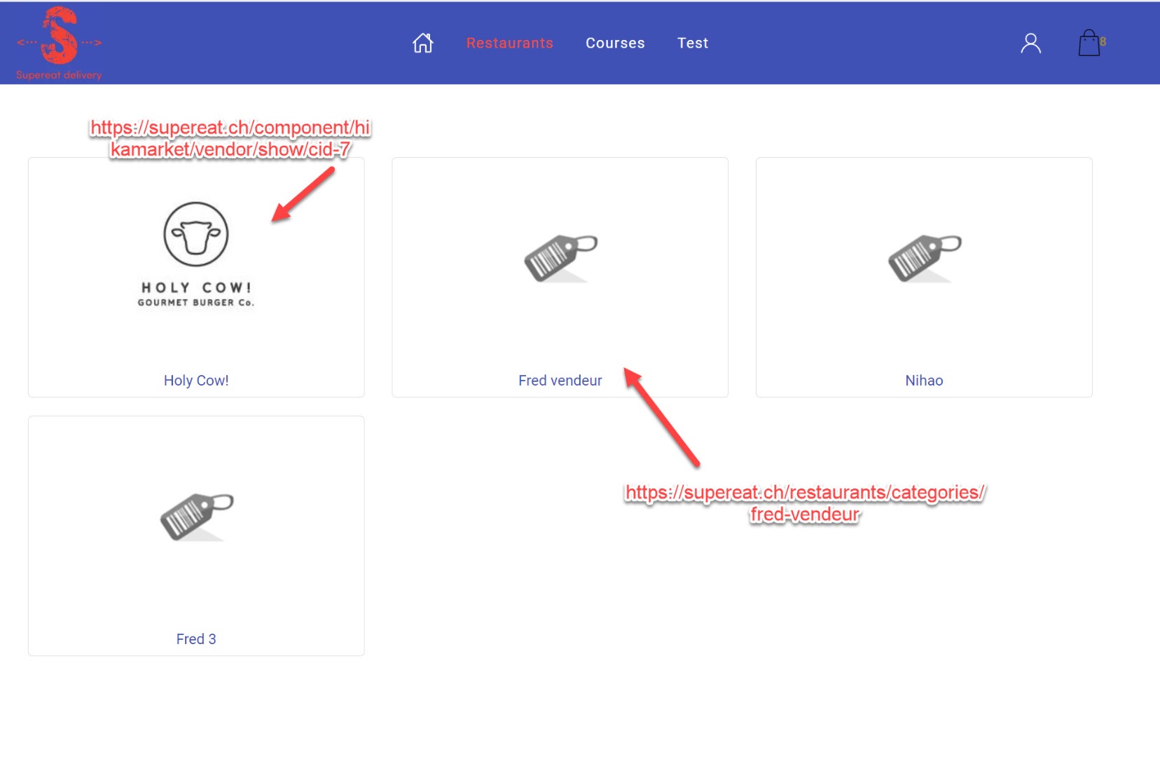

I have a strange problem...
I set up a multi-vendor shop (still for my food delivery project).
I have a menu, which leads to the "Restaurants" category. In these subcategories, I have my vendors.
I have activated the function so that the categories are linked to the sellers. When I click on my restaurants category, I see my categories. But there, only the first category is linked to the seller's page, the other categories work normally.
I don't understand why the other categories don't take me to the corresponding seller's page?
The url on the category that works is like this: component/hikamarket/vendor/show/cid-7
The one on the other categories is like : restaurants/categories/fred-vendor
I don't understand what I'm forgetting so that it doesn't work...

The vendor category must be created by HikaMarket itself.
It is not a "normal" HikaShop category, HikaMarket place a special category type on it and also a unique namekey.
It allows to be sure that one vendor just have one "vendor category".

OK, but how can i do that ?
The vendor will be create by the site admin.
So have i to activate the "create vendor category" in the configuration or can i do it manually ?
You can't do it manually, as previously mentioned ; it is done by HikaMarket in its own workflow.
