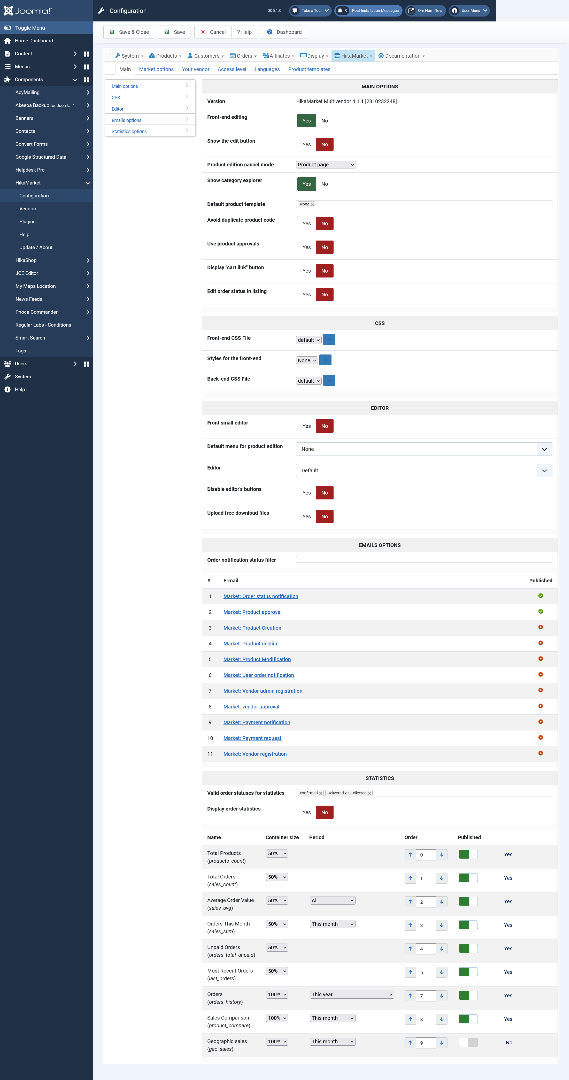

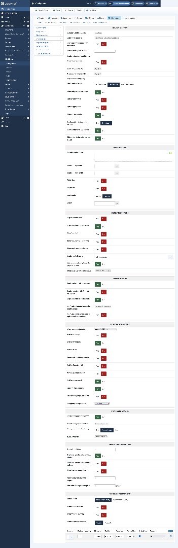

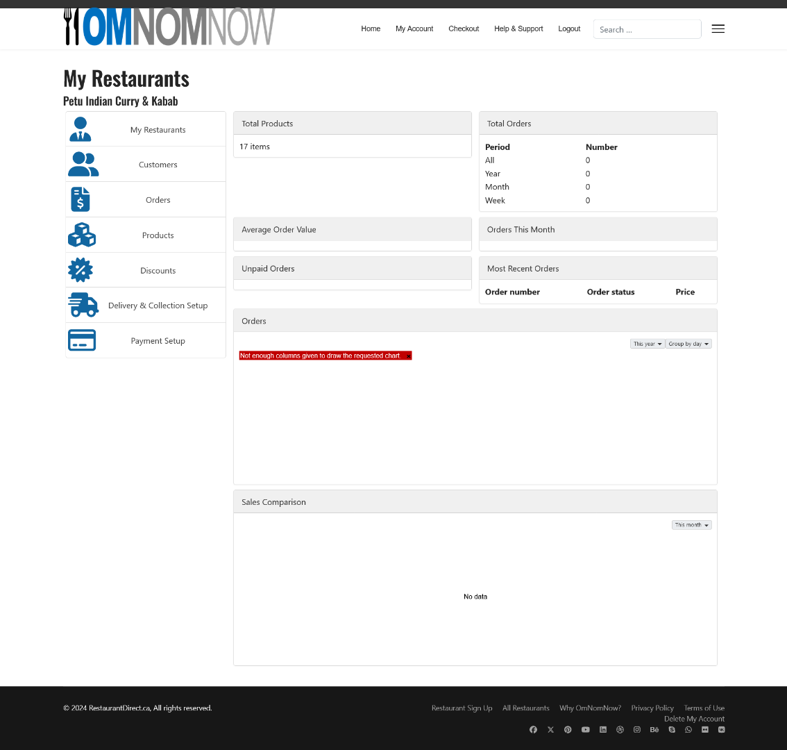

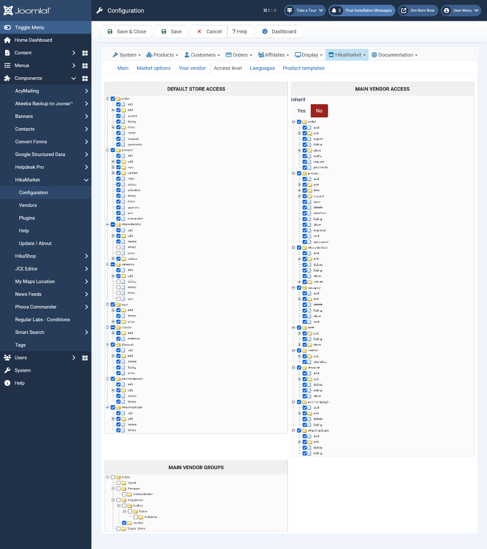

I've tried to set this up so that vendors can create categories, but I can't figure it out.
I've attached screenshots of the config pages and the access page, as well as the dashboard on the site. As you can see, there's no menu option for categories for them.
How do I do this? If you could give me step-by-step instructions to allow vendors to create subcategories but not see any of the other categories on the site? If there's an article explaining this, that will work too.

I'm sorry but I can see/read your settings. The screenshot is too small.
