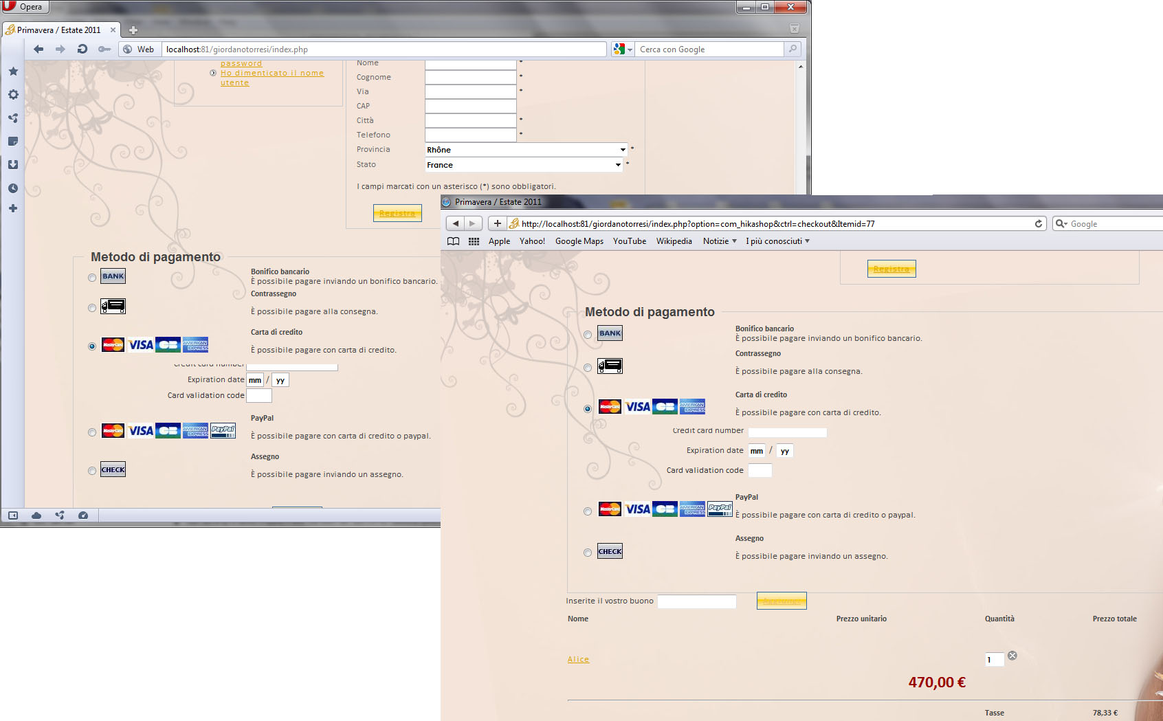

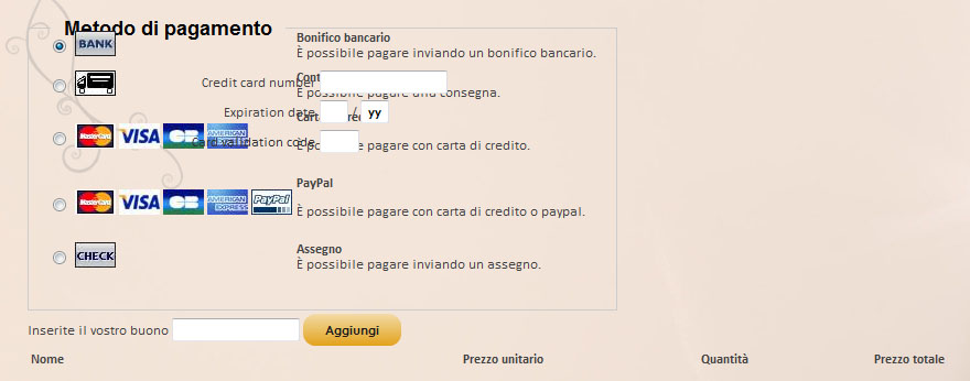

3. I have those 2 problems with different browsers;
a) IE: see attachment ( ),

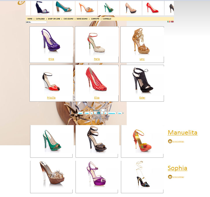

b) Opera, Chrome, Firefix and Safari, when I change page (see attachment: ),

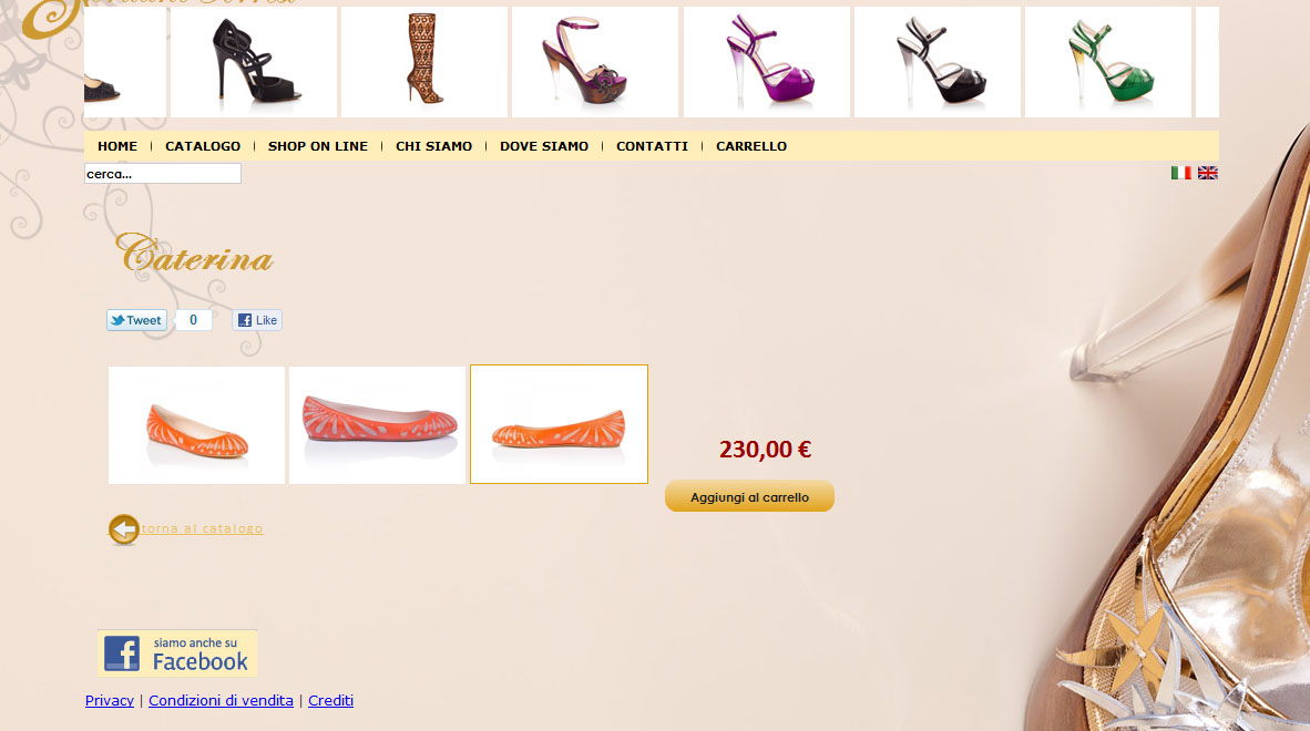

c) Safari and Chrome, when I go to product, lose the main image (see attachment:

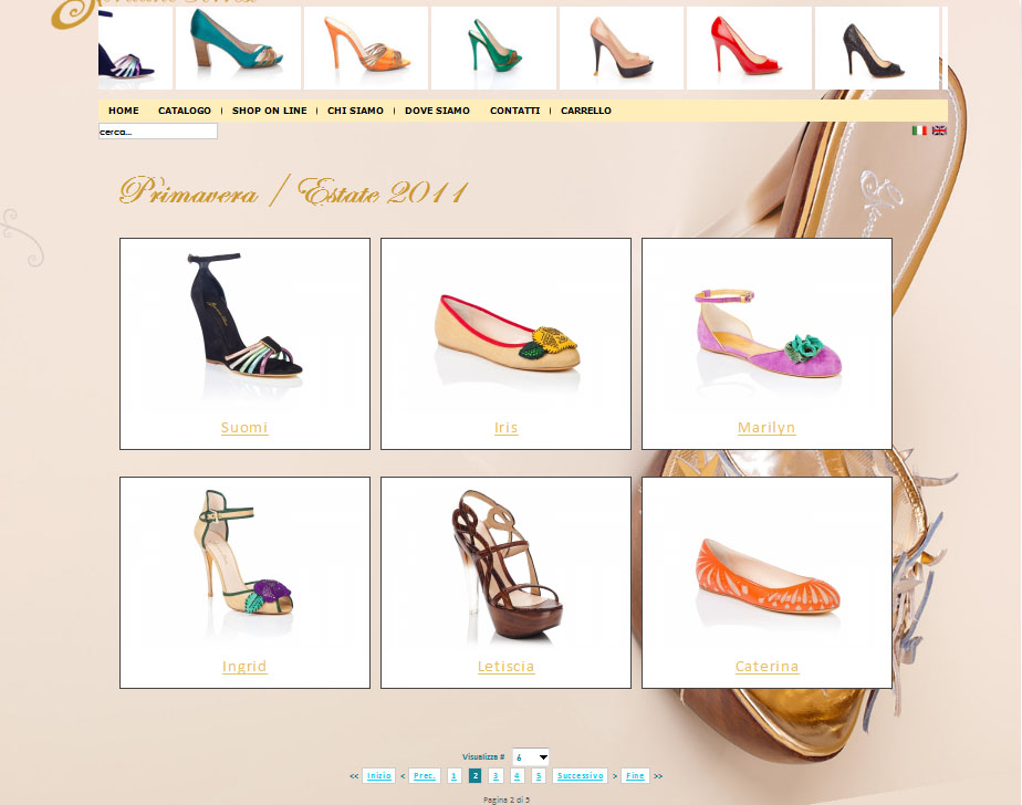

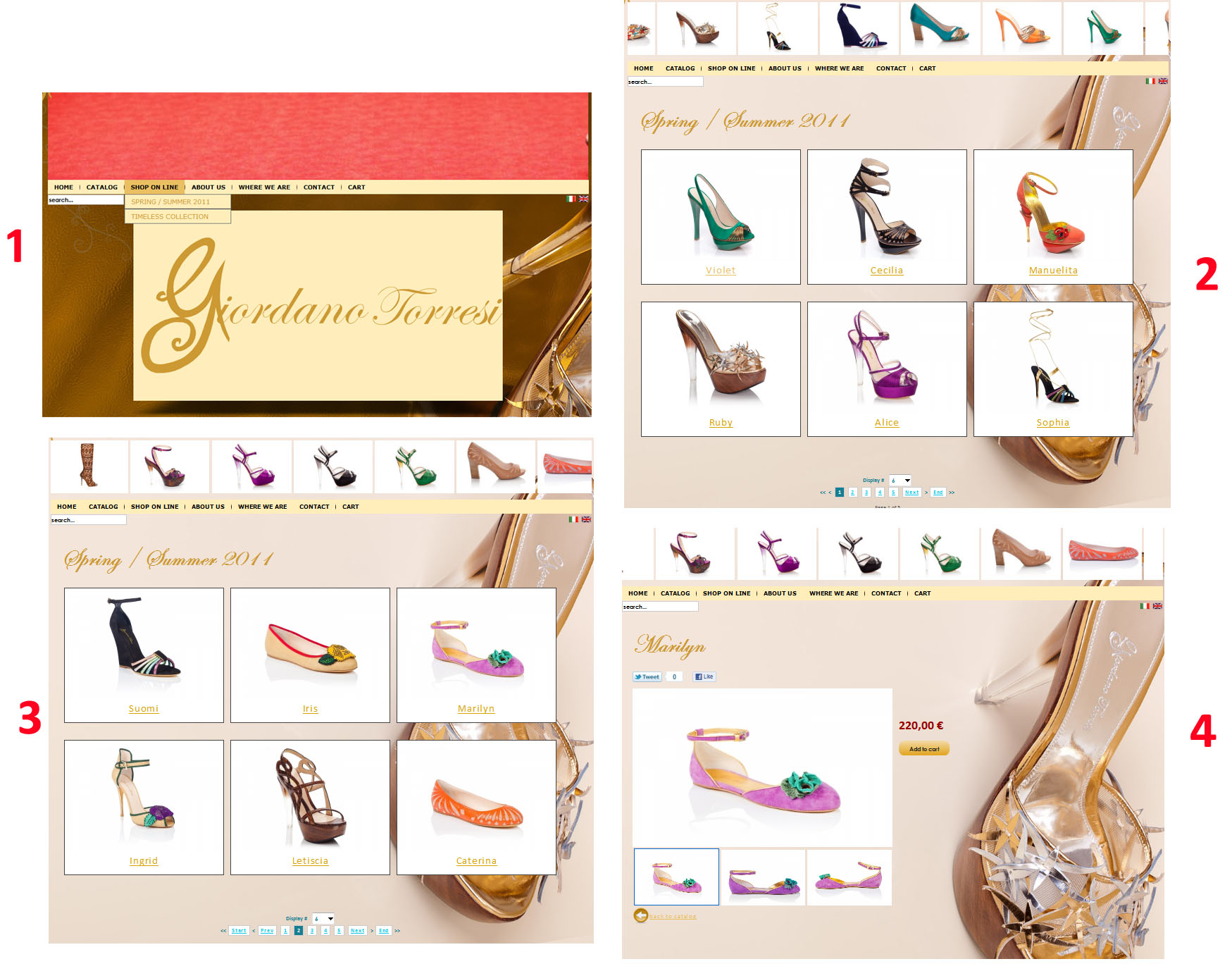

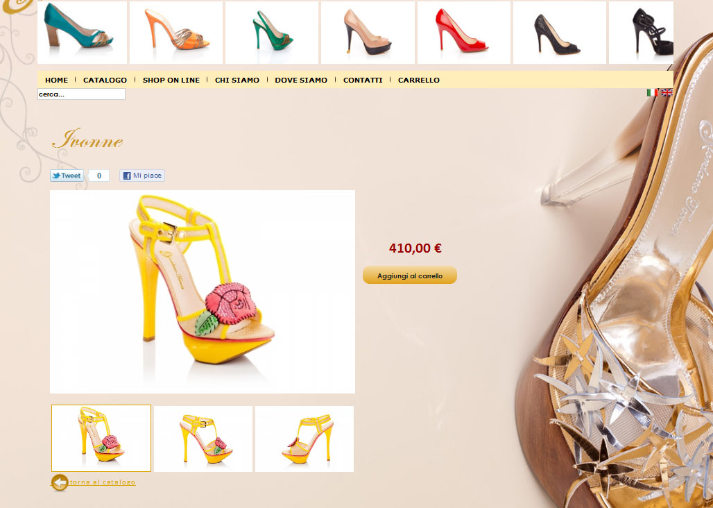

the first question is summarized with this slides:
1. the start whit the choice spring-summer, 2. is the relative page, 3. is the 2^ page of the collection 4. is the product.
In the up ther is a slide with all products.
I would go, when I click in a thumb in the upper slide, in the page 3 (i.e., 2^ of the categorie), not in page 4 (product).
the second question: I would customize, with 'css', only the button that you see in the slide 4, not other 'add to cart'.
Third question: b) solved (my error), c) solved modifying 'frontend_default.css' at class .hikashop_product_main_image_thumb with height: 300px;

1. When I click the thumbnails on your slideshow, I don't go to 4. I go to 2 or 3 (I don't know). So it seems to do what you want already no ? In anycase, that module is not a hikashop module so I wouldn't be able to help you configure it.

3. I don't have problem a with IE 9. If I witch to IE7 mode, I can see that the payment block is not hidden correctly. That must be a problem between mootools 1.12 and IE7. The easiest is to deactivate the slide effect. For that, you can try to edit the file payment of the view checkout and change the line:
<div id="hikashop_credit_card_<?php echo $method->payment_type.'_'.$method->payment_id;?>" class="hikashop_credit_card">
to:
<div id="hikashop_credit_card2_<?php echo $method->payment_type.'_'.$method->payment_id;?>" class="hikashop_credit_card">

thanks for answer number 2; it works (but the correct form is:
.hikashop_product_quantity_main .hikashop_product_stock .hikashop_cart_button {
color: #FFFFFF;
question 3: I disabled all third components, modules, plugin: the malfunction there is still, but a little malfunction is also on Opera and Safari:
first question:
this is the link on first page to page 2 ('http://localhost:81/giordanotorresi/index.php?option=com_hikashop&ctrl=product&task=listing&Itemid=77&cid=10'), but is still the same for page 3 and 4 ...; the pages are generated directly from hikashop (HikaShop » Product / Listing via HikaShop Options 3 columns 2 rows); if I would go to second or third page; how can I do?

3. With some CSS you should be able to display it properly. Like that:
.hikashop_credit_card{ padding-top:7px }
1.I think I understand your question.
You need to add the parameter limitstart_hikashop_category_information_menu_77_10 to your URL.
77 is the itemid of the menu and 10 is the id of the category. So for example you could have these links:
index.php?option=com_hikashop&ctrl=product&task=listing&Itemid=77&cid=10&limitstart_hikashop_category_information_menu_77_10=0
index.php?option=com_hikashop&ctrl=product&task=listing&Itemid=77&cid=10&limitstart_hikashop_category_information_menu_77_10=6
index.php?option=com_hikashop&ctrl=product&task=listing&Itemid=77&cid=10&limitstart_hikashop_category_information_menu_77_10=12

c) the solution isn't strong because if images sizes are different the result isn't good. Other suggestions?

c: there is already some code in HikaShop's show view in order to set the height of the image automatically and dynamically. It's in the file show of the view product that you can edit via the menu Display->Views:
$height = $this->config->get('thumbnail_y');
					$style='';
					if(count($this->element->images)>1){
						if(!empty($height)){
							$style=' style="height:'.($height+5).'px;"';
					<div class="hikashop_product_main_image_thumb" id="hikashop_main_image_thumb_div" <?php echo $style;?> >
If you don't have it, maybe it's because you don't have the latest version of that file ?

C) I have the code that you reported and how, in fact, everything works fine.
