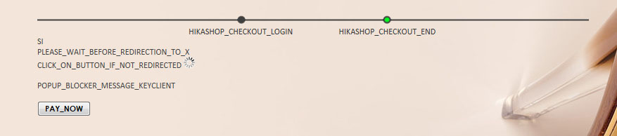

13 years 11 months ago #22896
Hi, Nicolas
I developed new credit card plugin payment (KeyClient).
I copied from epay (similar) modifying name in keyclient; after I modified the configuration (keyclient.xml) and all php (keyclient.php, keyclient_configuration.php, keyclient_end.php) as in administrator/components/com_hikashop/extensions than in plugins/hikashoppayment.
Well, when it must open KeyClient_window (in standardwindow.js that I copied and wrote in my directories) this happens ('SI' is a my alert: first instruction of keyclient_end.php, before opening KeyClient_window) and pay_now button doesn't work and the page is in loop
Suggestions?
Thanks in advance
Massimo
