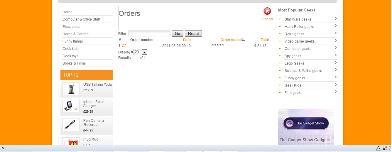

what is the point on the order status "created"?
  • Posts: 66
14 years 11 months ago #24442
I am just testing the program and I've noticed that if I order something and click on the basket, do the check out process and then close the window before paying the order status is marked as "created".
The problem is that if the user go to control panel and click to view orders the order is shown as created but there is no way to finish the order or cancel the order.. so what is the purpose of it?

I see, none of the options apply to me so how do I get rid of this option? I'd like the order not to be showing on the control pannel unless it is paid.
  • Posts: 86058
  • Thank you received: 14182
14 years 11 months ago #24450
There is no option for that.
You need to edit the file "listing" of the view "order" of the front end via the menu Display->Views and add some code to skip the display of unconfirmed orders.
