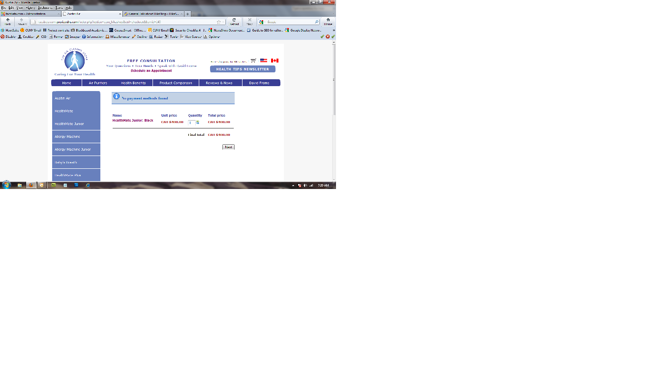

Hi, I'm getting this error message "No payment methods found" when using the currency switcher to display $CAN. This happens in Firefox and IE, not Safari. I read through your list of potential problems posted on another Forum thread. I did change the currency symbol, but I changed it back. Still doesn't work.

We have Authorize.net set-up in test mode so our credit cards don't get charged, which is what I think is causing the message you saw. Payments are going through. The problem we are experiencing is with the currency switcher. When it is changed from US to CAN, the next screen displays a message that no payment method has been found. At this point, the user has not entered an address. Just based on the currency switcher changed to CAN, hika is not recognizing the authorize.net payment method.
  • Posts: 86180
14 years 11 months ago #26366
Yes, that's normal. Authorize.net only accepts USD, and no other currency, so the payment plugin is not displayed in such case.
