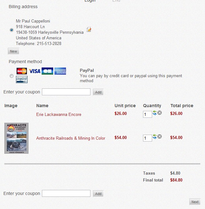

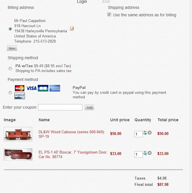

I am new the HikaShop and have been evaluating it as a replacement for Virtuemart. I have run into what I think is an odd issue with shipping being added to the order. For the past few weeks I have been building my HikaShop on a local machine and have been running Joomla 1.7.3 as localhost. Everything expect the Paypal IPN (that is a subject for another topic) is working fine when run on the my local machine under Xampp 1,7,4 (PHP 5.3.5). This is what the checkout page looks like when run under this environment.
However, when I move the site from the local development environment to my Test/Dev Web server at my ISP shipping is not added to the checkout. Nothing has change in the HikaShop configuration as I used Akeeba Backup and Kickstart process to move it. The only thing that is different is the PHP, MySql, and Apache server versions. Here is the PHP info output for the local server I used. I will post an image of the Web server ISP behavior in a response to this post.

14 years 8 months ago #35274
Here is the image of the checkout page from my Web server ISP based Test/Dev environment
  • Posts: 86180
14 years 8 months ago #35294
Your products are not detected as being shippable.
It's either that you didn't set a weight for them, or that the option "Force shipping regardless of weight" of the configuration is turned off.

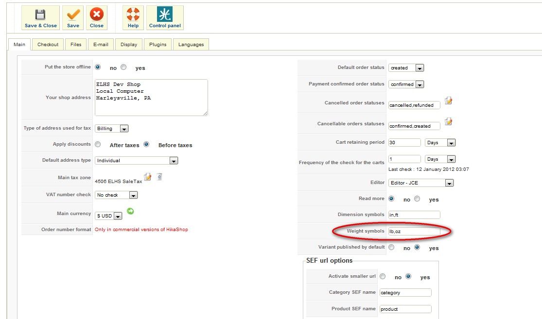

  • Posts: 45
14 years 8 months ago #35326
I don't think that is the problem either. I have the weight units set to lb, oz per below
  • Posts: 86180
14 years 8 months ago #35357
So yes it's not that.
For the products with the problem, could you try to go in their product edition page, make sure that the weight unit is in lb and save the product information ? If there is an inconsistency in the database, that will force it to use lbs and not something else.
That might help make these products shippable.
  • Posts: 45
14 years 8 months ago #35359
Nicolas,
I found the problem. It was an issue with mixed units in the weight field of the product import file. The products that had Lb in the field pulled up the shipping. Product that had pounds (remnant from importing my products from VirtueMart) in the weight field did not. I have change all weight units to lb and imported the csv file to update the prodcuts. Everything is working now.
