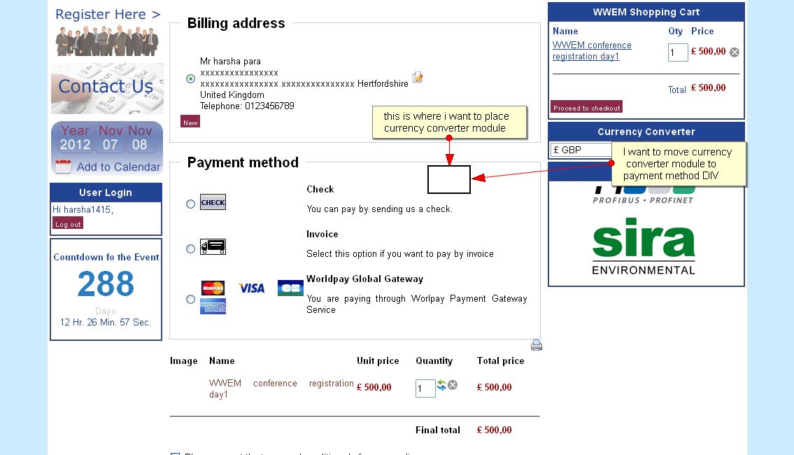

14 years 7 months ago #36362
i can use moduleanywhere if it is article something like that, but hikashop checkout page is not an article,it is component menu page i can't create that in article manager, i can only create through menu,here is the image so that u can understand my problem easily.
i want to change the currency converter module in the payment method options in check out page
  • Posts: 86180
14 years 7 months ago #36430
Yes, I understand that.
As I told you in my previous message, that won't work even if you put it there (which would require to edit the corresponding view file to add some code to it).
It would require that you modify the code of the module to make it work.

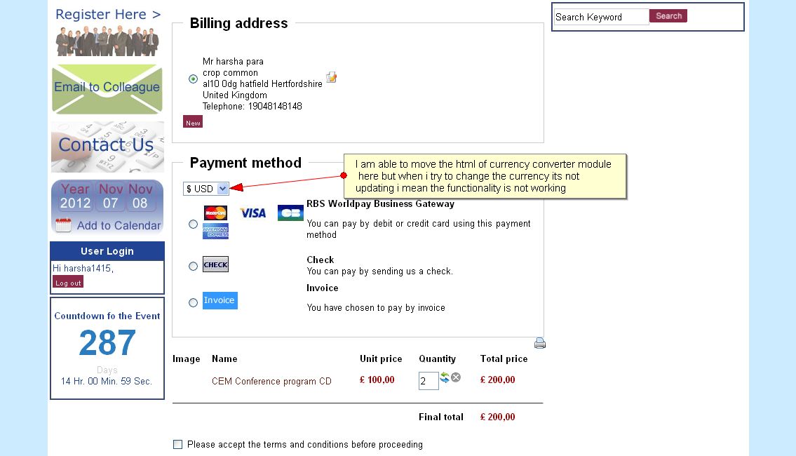

  • Posts: 23
14 years 7 months ago #36487
Hi nicolas
i tried to move the position of the currency converter module to checkout page which is the below one, i have added the below code in the payment.php file
jimport( 'joomla.application.module.helper' );
$module =& JModuleHelper::getModule('mod_hikashop_currency', 'Currency Converter');
$document = &JFactory::getDocument();
$renderer = $document->loadRenderer('module');
echo $renderer->render($module);
C:\xampp\htdocs\wwem\components\com_hikashop\views\checkout\tmpl\payment.php
after adding the above code i can able to see the html of the module but the functionality is not working
i have attached the image aswell
can please help me this out what i can do now
thank you
Last edit: 14 years 7 months ago by harsha1415. Reason: got error of image not loaded properly
  • Posts: 86180
14 years 7 months ago #36494
Yes, that's what I told you would happen :)
It doesn't work because the form of the module conflicts with the form of the checkout.
To make it work, you will have to edit the file modules/mod_hikashop_currency/tmpl/default.php and change the code there so that it doesn't use an html form and instead does some javascript to do a redirect via a window.location.
